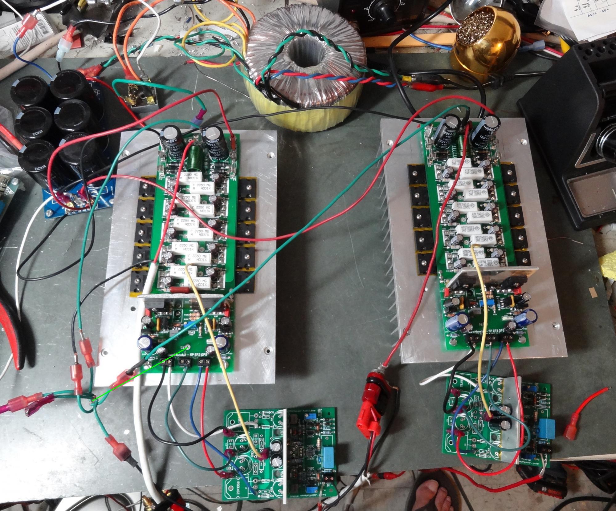

OK I added the 82pf to csa/csb. The bias is not jumping but the heatsinks still can't keep up. Just too hot for my liking. I also changed R113 to 68R. That dropped the current to 15mA across R113 but the heatsink on the drivers it too hot to hold onto. I hooked up my scope but don't see anything unusual. There is still something amiss because when I payed music through it, after about 5 minutes the bias raised to about 70mV across the emitters. stopping the music brought it down to about 60mV but it just sat there. Then I unplugged the input and it dropped very quickly to the original setting.

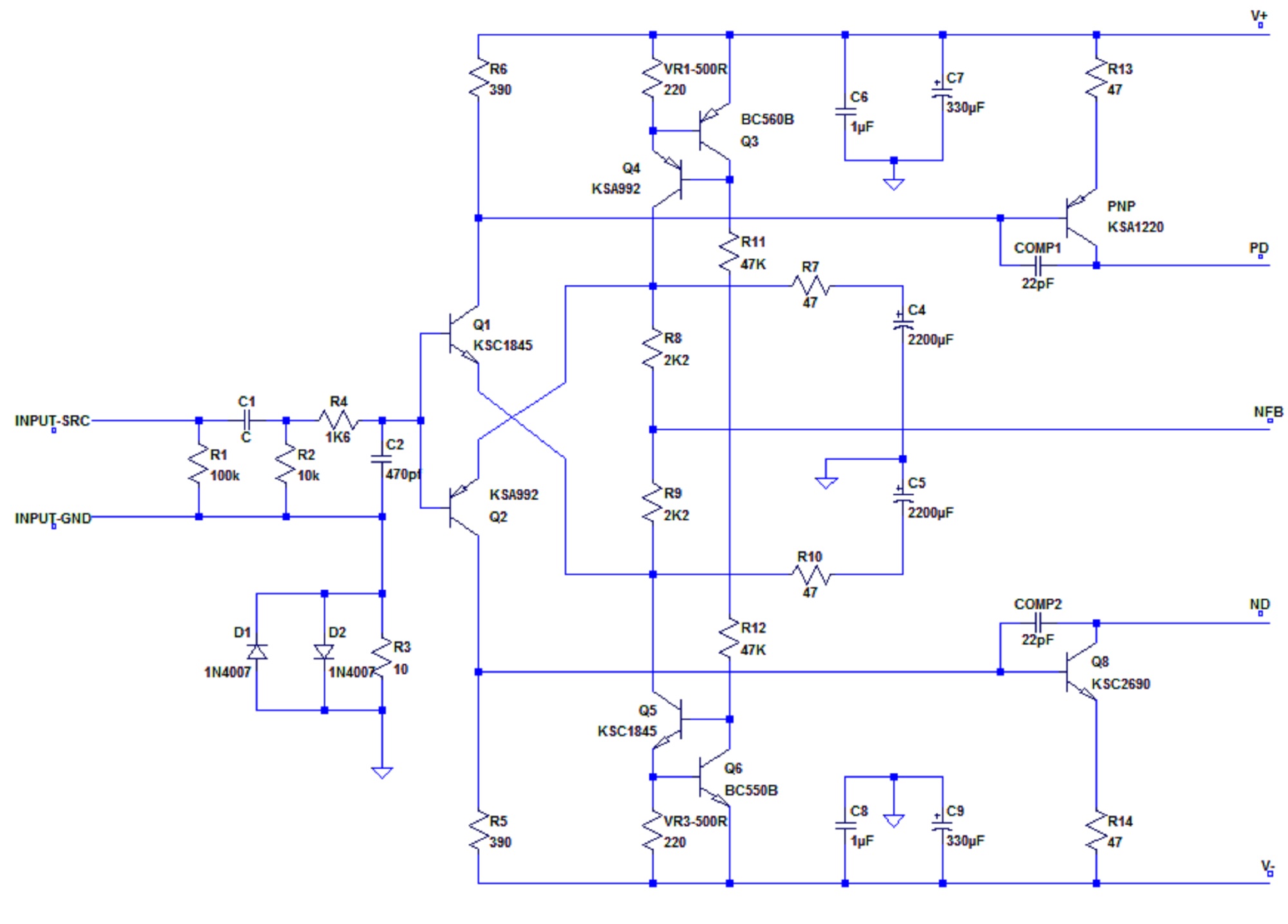

And , what exactly is the "jury rigged" CFA IPS you are using ?
(schema) ?
Attached

It is an adaption of this.
http://www.diyaudio.com/forums/group-buys/251782-vssa-through-hole-version-jason.html

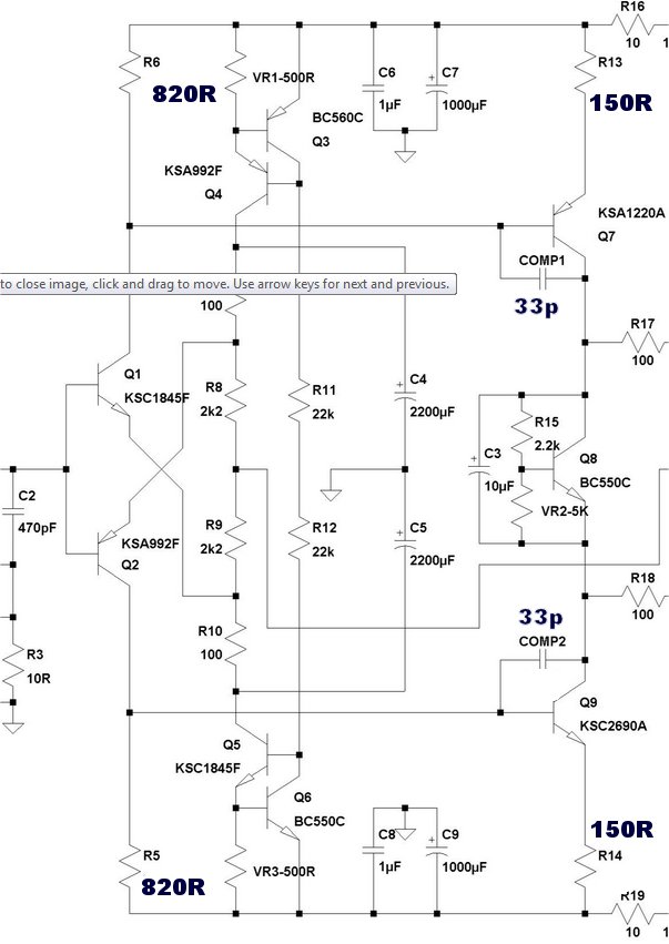

Never really looked at Jason's vssa (circuit).
(Below) are the changes i would make.
You would have to adjust VR1/3 to re- obtain
the standard 4.5-5ma "slewmaster" VAS current.
PS - you would then have a copy of the original "CFA-X"
OS

That's a shame, I posted it at least three times and asked for suggestions. The schematic you posted shows devices not being used. Adds a little confusion for me.
We don't want no confusion. 😕
Raise the Re on the main VAS devices to 150R.
Bias those main VAS devices (bases) with 820 R (to rail).
Look at the "VSSA" that is meant to go with this OPS (below)
, as a reference.
I also noticed on jason's VSSA ... no zener regulation. You might
also be exceeding Vceo for many of the devices - CAREFUL !! 😱
You need mje340/350 - ksA/C devices that can handle 300V+ and
very high vceo input devices. Jason's board is meant for 40-50V rails.
PS - mine only "sees" 1/2 rail for IP section ... full rail to rail for VAS.
Hence , the need for 300V devices.
OS

No wonder the heatsinks were so hot. Looks like it is oscillating. It doesn't do it without something plugged into the inputs. Could use some help locating the problem.
You can help yourself easily by using an oscilloscope. Have one?
You can help yourself easily by using an oscilloscope. Have one?![]()
Yes an old Techtronix. I hooked it up. I don't see any fuzz anywhere. Square waves look great.

I pulled the IPS and installed 18K resistors across V+-PD and V- ND on one of the boards. I left the other as is. On both OPS the Driver heat plates reached 54C within 5 minutes. Basically no change. I wonder why Jason didn't have this issue? His boards are basically identical to mine.
