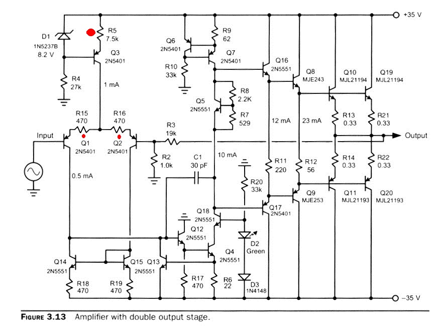

Hmmm, if it's a bad idea to optimize for slew rate,
then perhaps it's a good idea to anti-optimize for slew rate.
This turns out to be pretty easy to do! To cut slew rate in half, merely
(i) reduce the IPS bias current by a factor of two (change R5 to 15K) ;
(ii) keep IPS transconductance same as before (change R15 and R16 to 232 ohms) ;
(iii) keep P1 pole frequency same as before (don't change C1, leave it at 30 pF).​
By simply swapping out three resistors, we cut slew rate in half, without changing bandwidth or THD. If big slew rate is bad, maybe small slew rate is good.

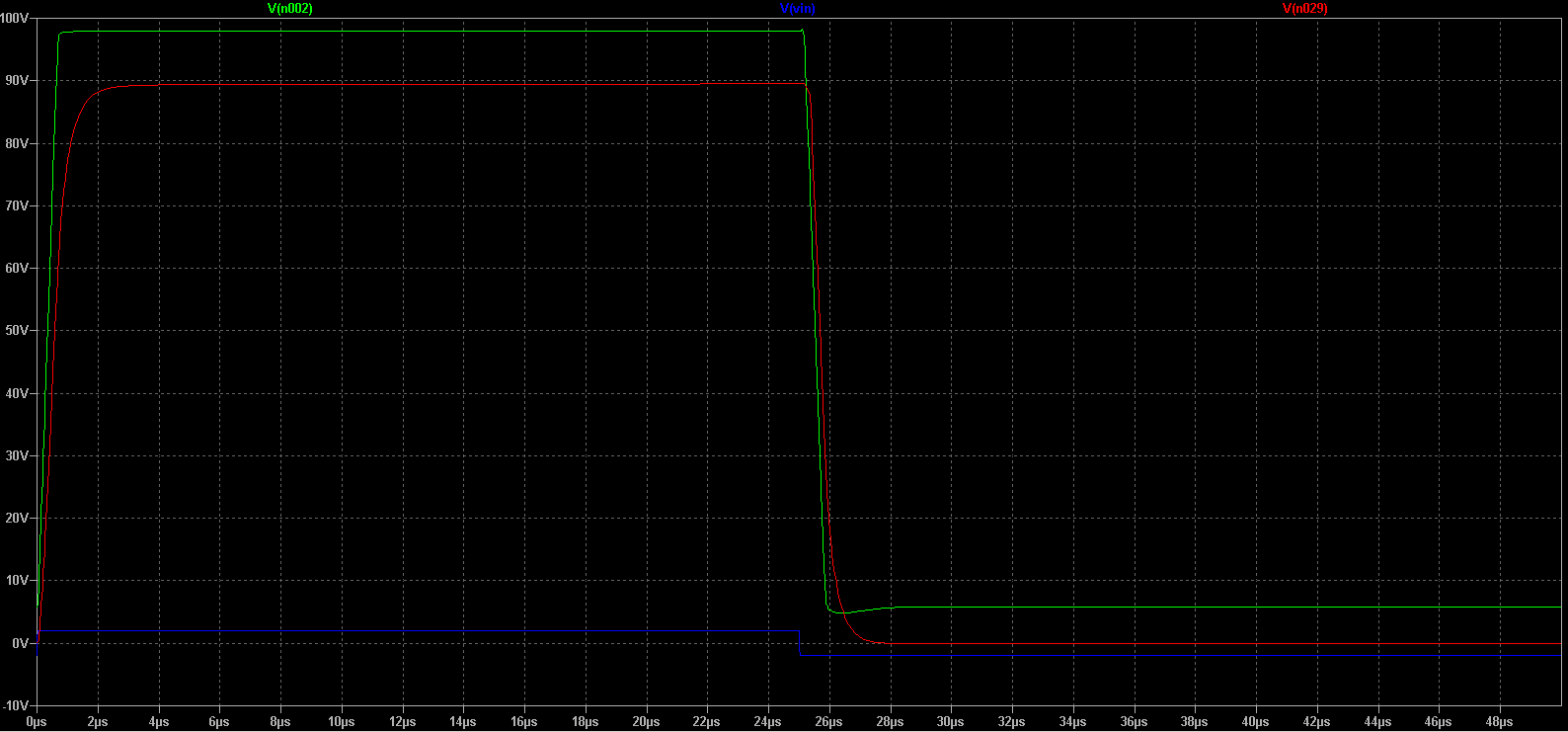

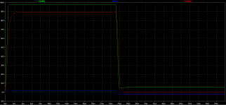

Speed is not bad. Mathematically it has to be at same speed as the input to the amplifier which might be of any speed. Added delay in rise time is it perceived?
Secondly how fast are our OPS? I have did a small sim where you can see that using a faster ips consider Lichtstark and i have probed the both output from VAS and from the output of the amplifier. Please comment on it.
In my opinion slew is not in first priority. Firstly THD, IMD and then we can consider higher slew. I believe if someone can get better slew without any artifacts then its not a problem but getting other sets of problems with higher slew is not my choice though.
