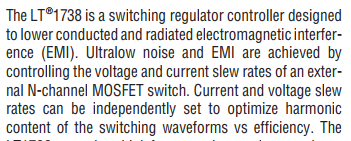

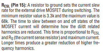

super answer..I agree slew rate is rate-of-change. But it need not necessarily be limited to voltage just because that's all most diy people ever meet. There's nothing wrong with current slew rate in current-controlled loads and it is very prevalent in many engineering areas. For instance, in SMPS's they often limit the current slew rate in order to control EMI. I think Vicor pioneered it many years ago, iirc.
In fact, if you go back far enough you will discover that the term slew rate stems from WWII when the US Navy discovered they had to greatly increase the slew rate of their AA guns to have any chance of hitting a Japanese Zero fighter. In those days, slew rate was expressed in mills/sec, where a full 360 degree circle was divided up in 6400 mills.
Just because 'meter' is often used to measure distance, that doesn't mean you can't use it to measure height ;-)
