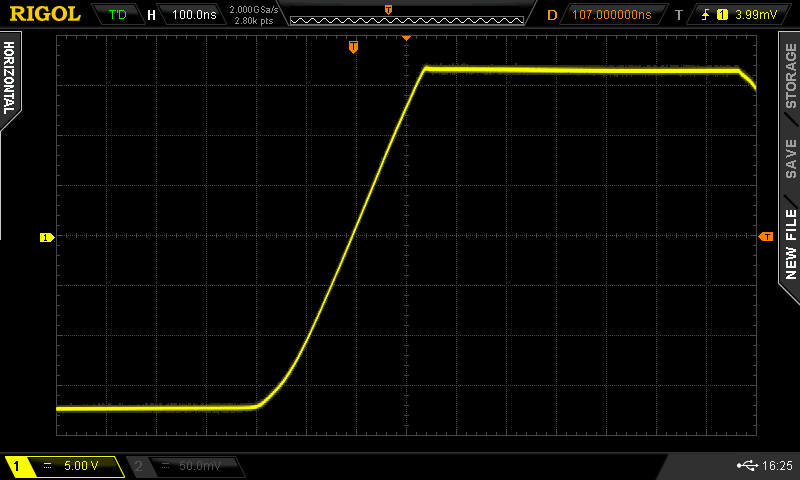

Here's a low powered amp I built last year. 20 volt supply rails, 35 volt slew in 320 nanoseconds = 109V/usec = 5.4 volts / usec / volt of supply rail. (Photo was displayed earlier, as an attachment to post #61.)
The amp's design closely follows the analysis and equations found in the online Tutorial pdf document written by James E Solomon. Those same equations are printed in Bob Cordell's power amp book too. Starting from the theory, it wasn't particularly difficult to achieve 5.4V/us/V slew rate. And of course, lower slew rates, for those designers who prefer them, are even easier to achieve. Just crank down the appropriate term in the equation and follow your nose.
_
