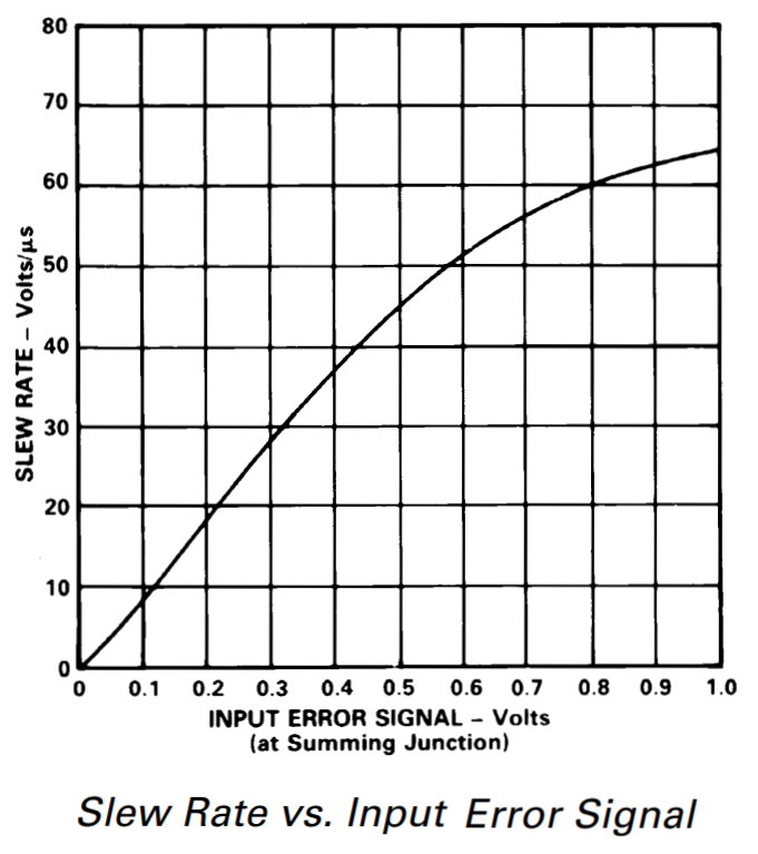

This week I was searching to find just the right part for an audio project, and I came upon this delightful graph (below) in a datasheet by Analog Devices. The graph reminds us that it takes some seriously large delta-V across the differential input, to make the IPS lean all the way over and steer 99.99% of the tail current into one side or the other -- i.e. slew rate limiting.
It also reminds us that delta-V across the differential input is, in fact, an error. Obvious, but also easy to forget.

I suspect that is a specific graph for a particular IC. The voltage swing can be adjusted with different degen resistors, and the slew rate depends on the gm and compensation capacitor. An undegenerated bipolar input stage will hit max. slew rate at about +/-120mV.
So it depends on what you design. Or you can select a suitable IC.

Are you sure?It also reminds us that delta-V across the differential input is, in fact, an error. Obvious, but also easy to forget.
Yes, the difference voltage between the bases of a diff amp is called the "error signal". Ideally the bases are always at the same potential, and through feedback this is what any gain block is trying to achieve - both inputs at the same level.
The scale for the x-axis on the graph in post-263 must be wrong, or as John Ellis says, it is for a specific circuit with high degeneration resistors. Besides which, there is no correlation between the input stage slew rate and the error level except at the point of clipping the output of the diff-amp. So, the graph is meaninglyess without the context of the circuit.

It's a figure from the datasheet of one particular Analog Devices opamp, whose slew rate is listed as "50 V/usec minimum, 75 V/usec typical".
This specific opamp has a differential pair of P-channel JFETs at the input, which allowed Analog Devices to set GBW (= gm/Cc) and slew rate (=Itail/Cc) to the desired values, while using a small compensation capacitor Cc. In BiFET opamps, the compensation capacitor(s) occupy huge amounts of die area, so a small Cc is desirable. It lets you build a smaller die, so you get more gross die per wafer and (via defect density) you also get higher ratios of (sellable_die / gross_die). This particular AD opamp has a Cc which is 0.4x the Cc of the uA741 opamp.
James Solomon's oft-quoted paper "The Monolithic Op Amp: A Tutorial Study" talks about the slew rate advantages of JFET input opamps (attachment below) and Bob Cordell's power amp textbook covers JFET input stages rather well.

AD744 says
Apparently, one of those opamps that sounds really nice ... if you skip the class B output stage via the compensation pin (5)😉
