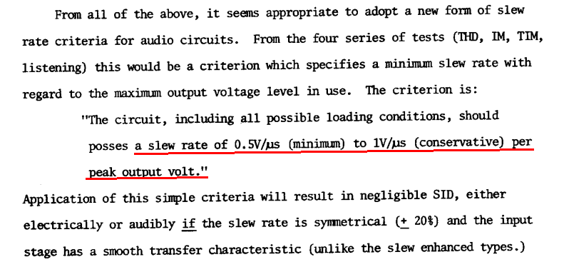

I think it is where the recommendation of targeting a slew rate limit for any amplifier that is 5times to 10times that slew rate that would be required to pass the fastest signal (combination of amplitude and frequency) in the required passband.
eg of fastest signal
Power Amplifier passing 10kHz at maximum level, or 15kHz @ -3dB, or 20kHz @ -8dB, or interference spike @ 100kHz @ -20dB, or any other that seems plausible.
Choose that with the highest slew.

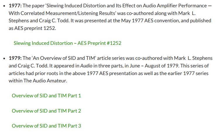

This behavior used to be called Slew Induced Distortion, if I remember correctly...... and distortion rises well before the SR limit is reached.
Analysing its origin and investigating the ways to combat it would be more fruitful than speculating about the maximal slew-rate performances of circuits which, in most cases, seem to be amply sufficient.
Yes, can be find here:
http://www.waltjung.org/PDFs/Walt's_Blog_2014_Classic_Articles_Page.pdf
See article overview attached.
I still maintain we are re-inventing stuff ;-)
Jan

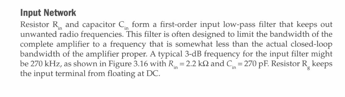

Here's a question. Why do some amplifier designs boast bandwidths of 100KHz, 200kHz or more given that keeping ultrasonics out of the amp is a good thing for avoiding slew induced distortion? Why don't they use an input filter to bring the bandwidth right down?
Here's a snippet from Bob Cordell's power amplifier book.

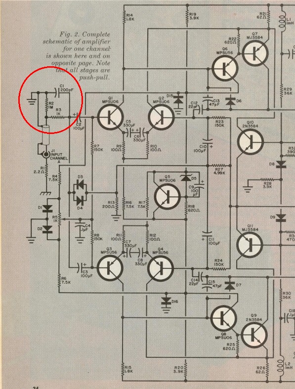

Also attached is the schematic of James Bongiorno's 200W/8R "Ampzilla" from Popular Electronics magazine, September 1974. I've circled the input filter (R3, C1) in red. Don't forget to add (2 x ~60 pF) to account for the Cpi of Q1 and Q3, which are relatively low-fT, relatively high capacitance transistors, when operating at Ic = 1mA. And Douglas Self hammers the point, again and again, don't forget to add the output impedance of the signal source that drives the power amp input, especially if it is a "passive" preamp (volume control pot only).
Because people have frightened themselves by looking at the waveform 'distortion' caused by a simple low pass filter. Having alarmed themselves, they will then try to frighten you too. This horrible 'distortion' is perhaps most clearly seen using a gated sinewave or a square wave; both of these waveforms of course appear regularly in live music 😎. Such people usually progress to the full state of Fourier denial within a few months.traderbam said:Why don't they use an input filter to bring the bandwidth right down?
