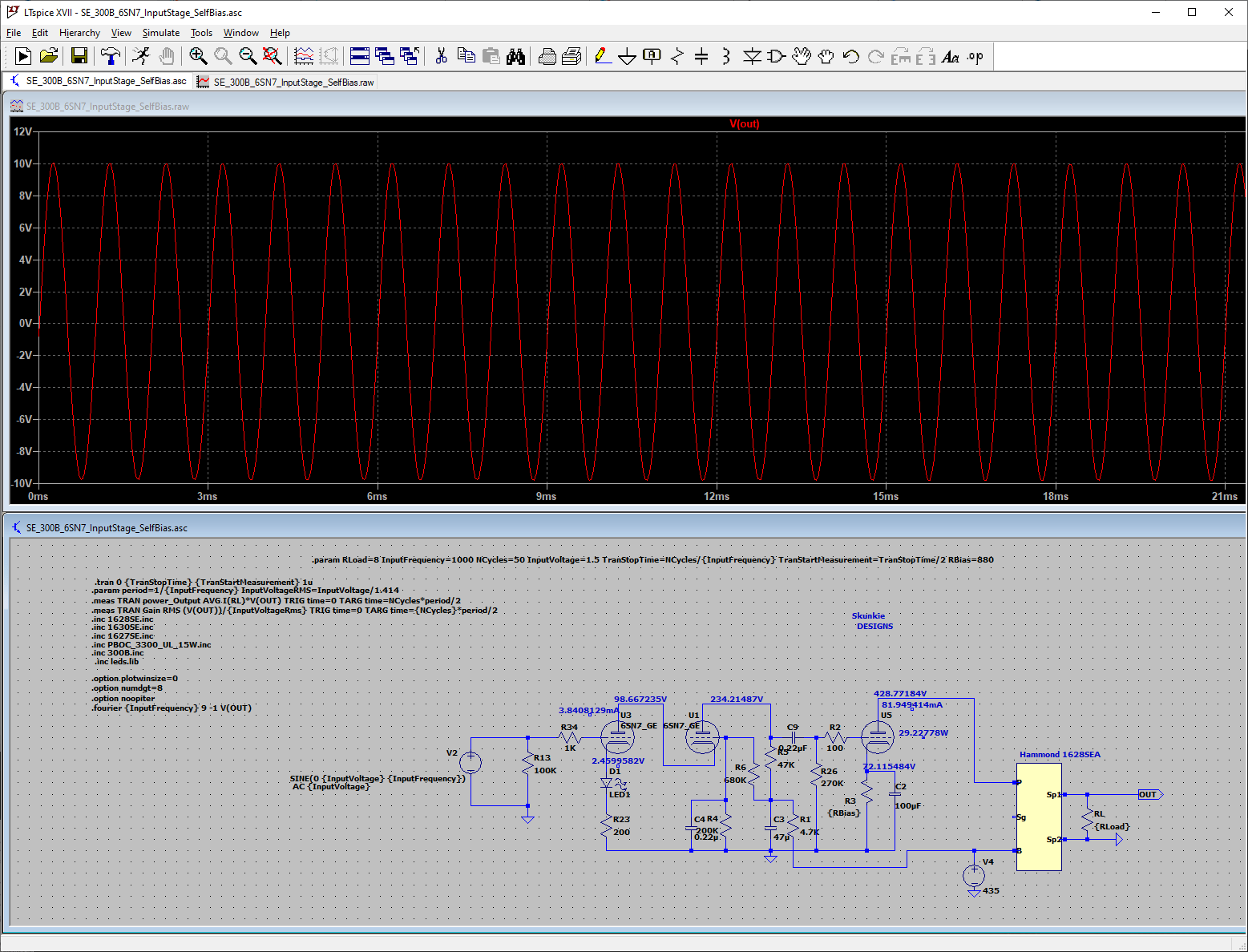

In case somebody is interested, here is a simulation of circuit in the first post. Simulation shows 6W RMS just before clipping:
All caveats with simulations apply. Model used for 300B is the Ayumi one, DC voltages are quite close to the real circuit, but the 300B current is a bit higher than in the real circuit.

So the loadline would use 350v plate and -72v bias curve. Skunkie says it swings 140v p-p on the grid. So, the peak goes to 70v, 2v shy of the 0v curve. Perfect. That leaves ~100v on the plate @ 0v grid. The plate swing is @250v peak. Turn that into RMS and it's 177v RMS. Now you transform that by the TR of the tranny (25) and get 7v RMS and then you remove the 20% for loss. The estimated power is 5.7W RMS for an 8R load.
Only if you use 550-600V anode voltage. I guess, you might be able to get 12-13W at 3% THD with some 600V/60ma and 7.5-8K. At lower anode voltage the "standard" 300B is more efficient because it has higher gm and lower rp. I don't think Thomas was really after max plate efficiency. It's not his philosophy.So, it makes sense that a EL300B with a maximum quiescent plate to filament voltage of 600V, will probably have more output power than a WE300B.
10W at 3% THD can be obtained at dissipation of about 30W. I have done it a few times moving in the range from 420V/70mA with 4.2K to 450V/65mA with 5K. If one can get modest 2nd harmonic cancellation between driver and 300B, THD of the amplifier can get down to 1-1.5% (because it's Class A1 with largely dominant 2nd harmonic). I have always used standard 300Bs. One pair were Cetron (re-branded WE) and the others strictly selected Chinese 300Bs like Billington Gold, Golden Dragon 4-300B and 4-300BLX. The very first was with the excellent Golden Dragon 4-300BLX with Titanium plate some 20 years ago....unfortunately it was discontinued after few years in production. The amplifier started out as a replica of the well-known Ciro Marzio Katelelo (which like the Skunkie was operating the 300B at 350V anode voltage for 8W) but ended up with Tango NC-20 interstage and 420V anode voltage. Yes, the NC-20 is/was expensive, more expensive than the output transformer, but it's not a boutique transformer. There is no other way for best performance with IT. Other similar IT's have been made (like Hashimoto, for example) and end-up pretty much at the same point (performance, cost etc.).To put things in perspective: the 10W amplifier can play a hardly audible 1 dB louder than the 8W amplifier.
Operating expensive DHT's closer to max dissipation can become quite costly for not so much to gain.
30W dissipation is absolutely fine for standard, well made 300B's, without fancy mesh or punched plate styles.....
That is really too much. It might be acceptable for a very economical amp but what's the point of using cheap transformers with the 300B's? One thing is avoiding unnecessary costs but at the other end there are minimum requirements as well.That's the common 20% loss you can use for quick output power guesstimates.
