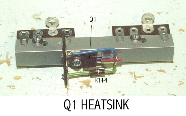

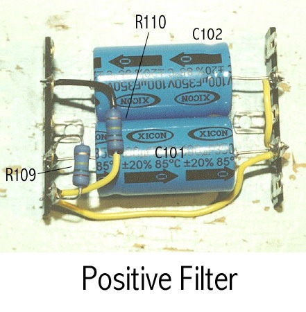

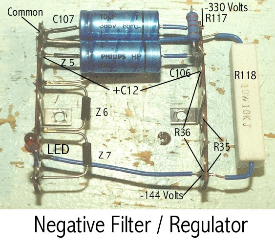

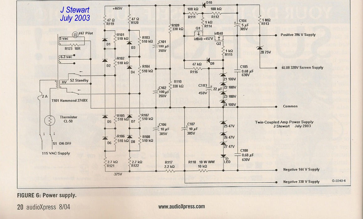

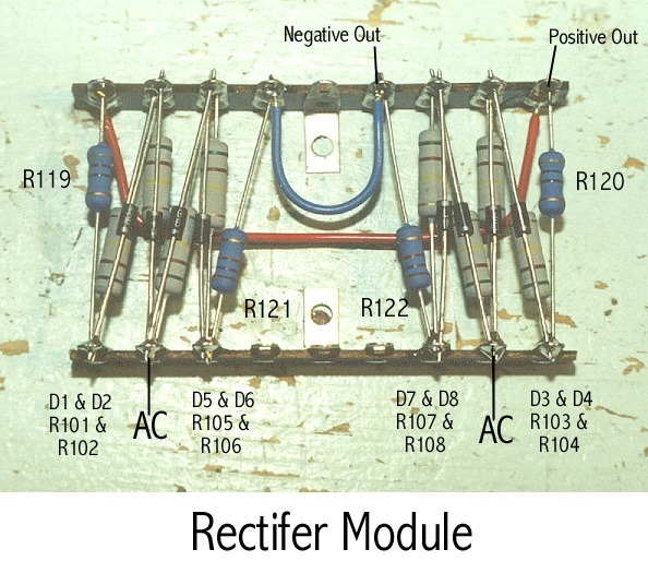

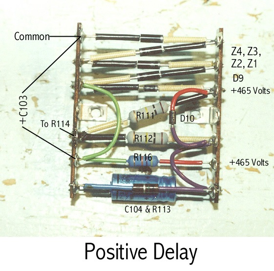

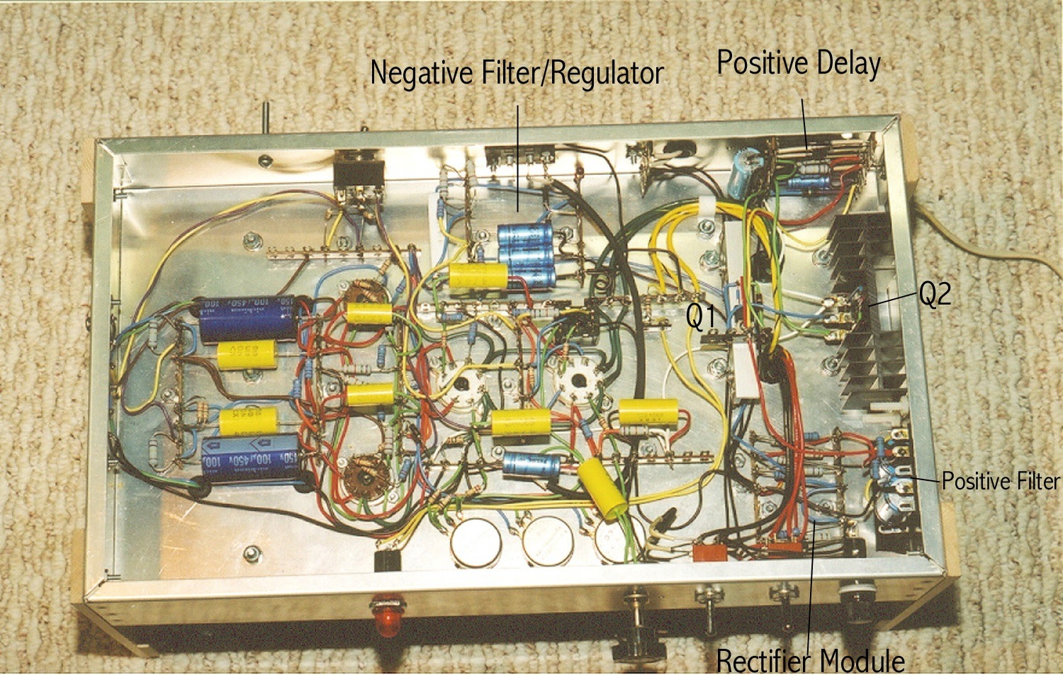

The regulated supply used in my vers of Crowhurst's Twin Coupled Amp solves all of those problems. Except one, covered at the end.Regulating the driver supply may be successful; regulating the anode supply for a 300B is much more difficult. Using series-regulator in a power stage can easily degrade the sound, unless you are very well equipped to optimise it. Using kludgy architectures like the Maida is very likely to sound bad.
The voltage handling required of the semiconductors must account for transients, including a startup and shutdown - and a 500V FET in a 435V output will be far too close. the power handling & heatsinking must accommodate the ±10% likely range of the Line/mains voltage, and handle overcurrent events.
There is a current limit on the primary supply. Two IRF FETs are arranged so that at turn on they share the HV transient. After a short delay Q2 assumes most of the voltage drop. It is on a Wakefield Heatsink. R116 & C103 form a delay on the run up of the HV until negative grid bias reaches the power tube grids.
Not required for Cathode Bias.
All these modules are built on the bench before installation. There was a lot of preliminary work on the physical layout. And the circuit. Full Differential, 6SL7, 6SN7 but can be switched to Crowhursts front end by one toggle switch. The amp is PP 6LU8s driven by the triodes in the 6LU8s. Maxs out at about 35W & easily scalable. There are no boutique parts. And built at a fraction of the cost of other dreams we see these daze.
It is an experimental amplifier. So how the B+ regulation effects the sound I have no idea. My objective is that the Rolling Stones & Pink Floyd sound the way they recorded, complete without the mystical 2nd harmonic crap.
Figure 6 Power Supply Clone of Twin Coupled Amplifier w Caption.jpg213.4 KB · Views: 406
