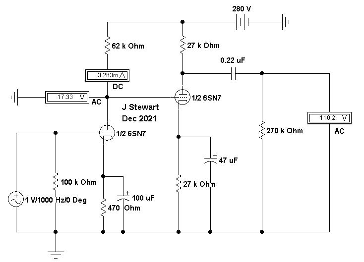

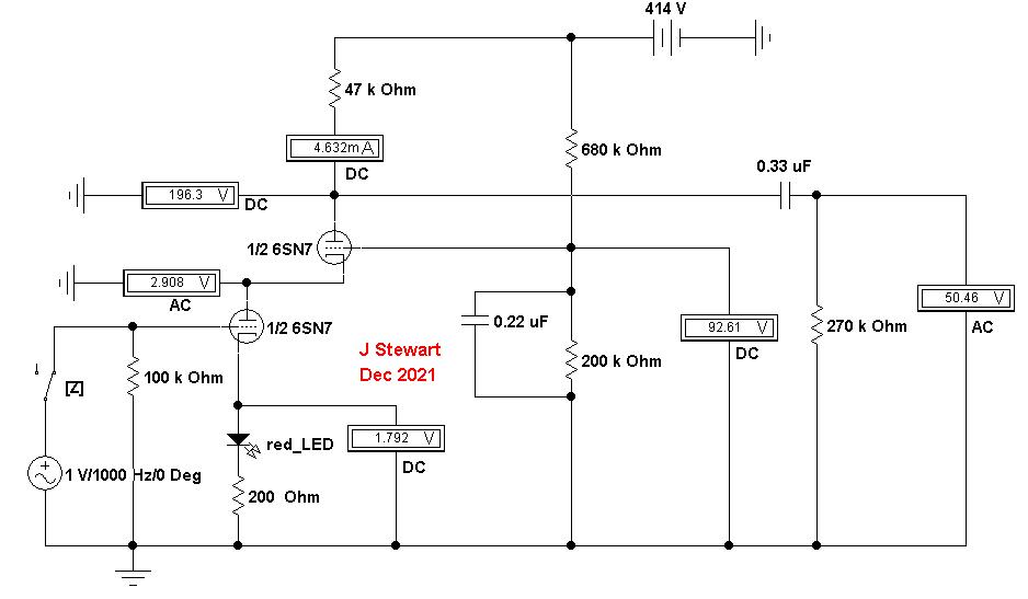

Yes, but it appears as if one drawing is edited from the other.
It was. 🙂 I apologize for using photoshop to edit it into my design, do I need to publish it in spice drawing format? Or what should I have used to draw it?
I actually built the first "Sun Audio" design, against the advice of some people here in fact, and it was so bad, I redesigned the front end as a cascode. It was easier for me to just edit the parts (the topology) I changed. Again I apologize if that isn't an acceptable way to do this.

My point was simply any 'ol pentode tossed into this circuit is not by default going to feed a 300B well.
I thought my cascoded instead of a direct coupled cascaded 6SN7 was a cool idea and it works well. Several people have built this amp and also like it. It's light years above that old "Sun Audio" "JC Morrison published" design I see people sharing everywhere.
I'm sure there are other designs as good or better, I thought the goal of the DIY community was to share ideas? Sorry if I was confused about that.

There is even a third drawing, or second way of re-drawing the "original"
Morrison / Sun Audio schematic. Should I attach it to add confusion ?
Sure, if you'd like to! 🙂
Sorry that you seem so confused by all this, again maybe you can educate me on the "proper" way to have presented this? Personally I find those spice created schematics extremely difficult to read and I thought this ink drawn one pleasing to the eye.
Here are the two driver circuits in plain, ordinary language so that everyone can see what is happening.

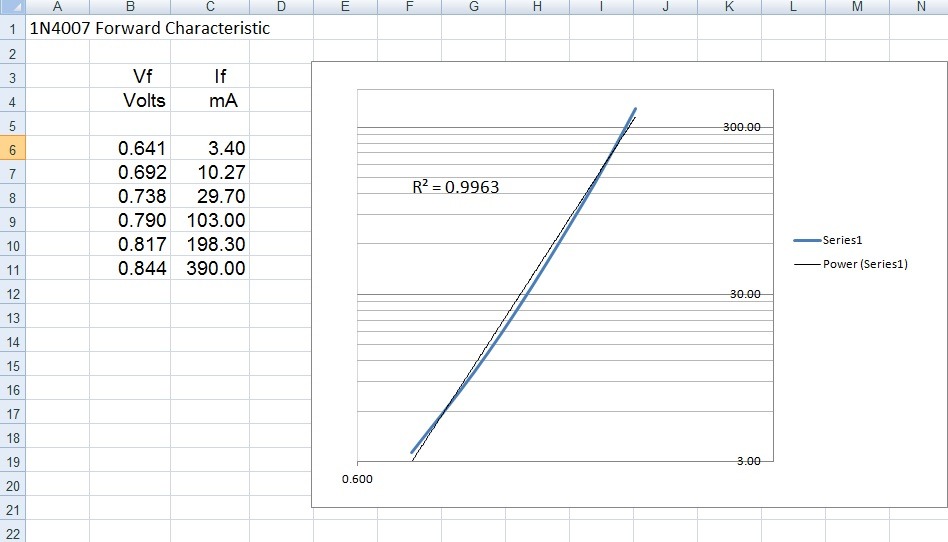

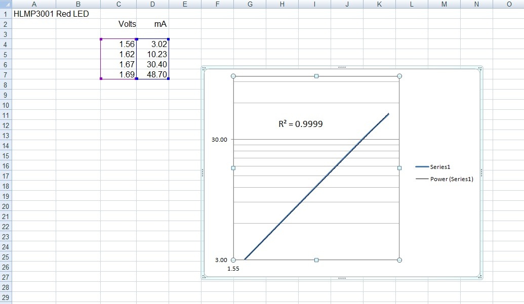

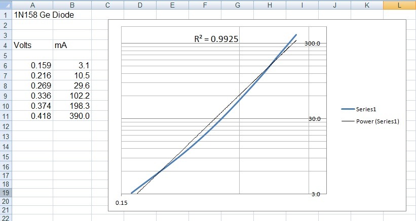

I've added the spread sheet of the forward curve of a LED I ran several years ago.
I general SS diodes are square law in forward conduction while vacuum tubes obey a 3/2 power curve.
The question then becomes does the SS diode enhance the sound & performance. Or the other way round.
For sure there will be a difference, I've never seen a study on what the result is. Anyone seen something?

I have just built the Skunkie design and found the cascode biasing too bright for my horns. I changed the led and bias resistor to a 680r bypassed with a 100uf polypropylene cap and it sounds sooooo much nicer.
I originally built it with a resistor/bypass cap bias and for my room/speakers/source the LED/resistor sounded better to me. Definitely this is a place you can voice the amp to your use!
The main change in these two circuits doesn't come from the way the driver is biased, it comes from going from a cascade to a cascode.
