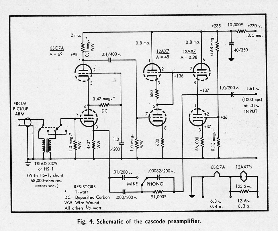

I built a low noise preamp with a BQ7 cascode front end. Circa 1958. Still here on the shelf! 👍

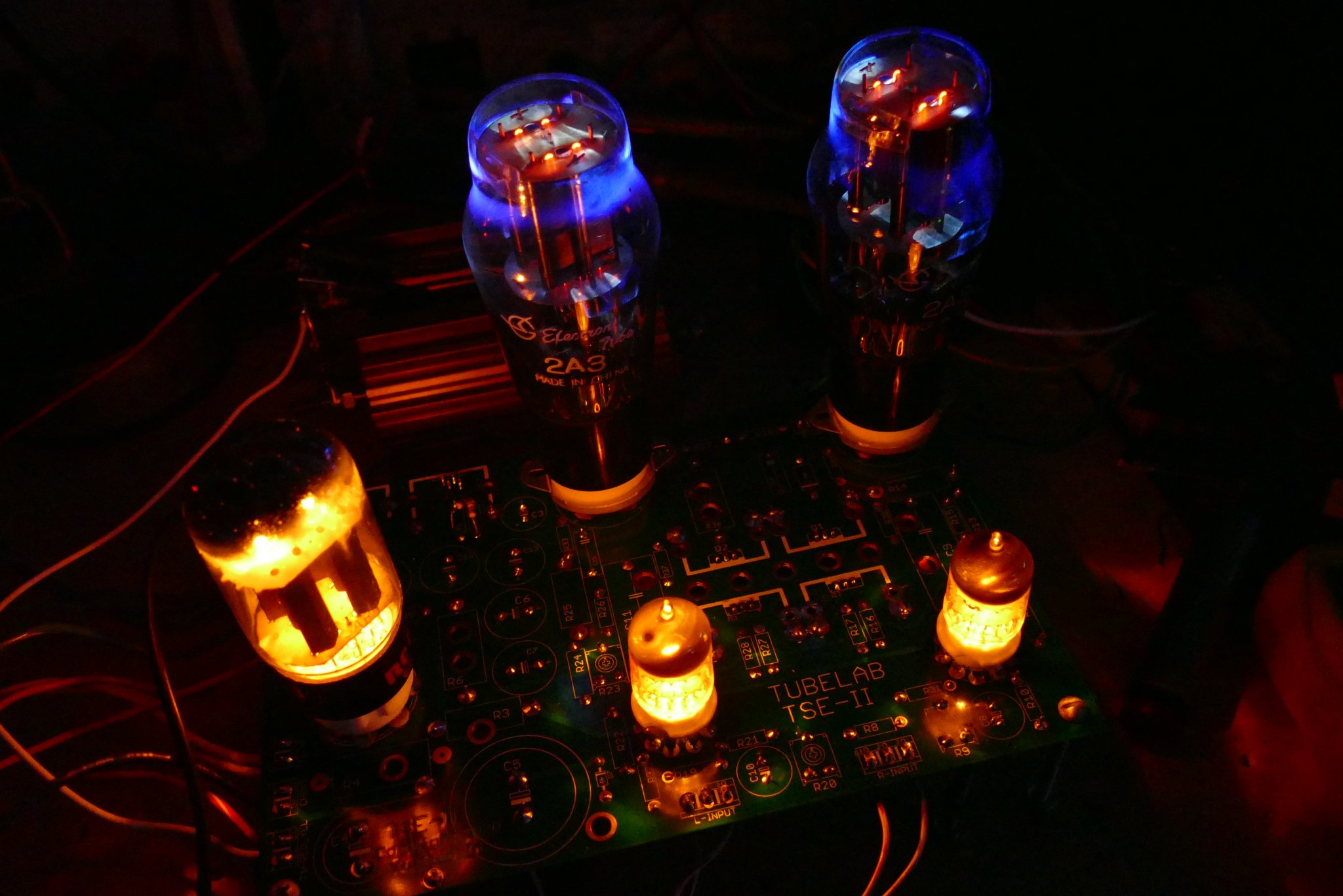

I dug out an old TSE-II board to test some alternative filament regulators to use in place of the hard to get MIC29502's. The board was set up for 300B's which were tested and worked fine. I then changed the voltage set resistor in the regulator to generate 2.5 volts and plugged in some 20 year old Shuguang 2A3's. What would 2A3's do on 400 volts of B+?

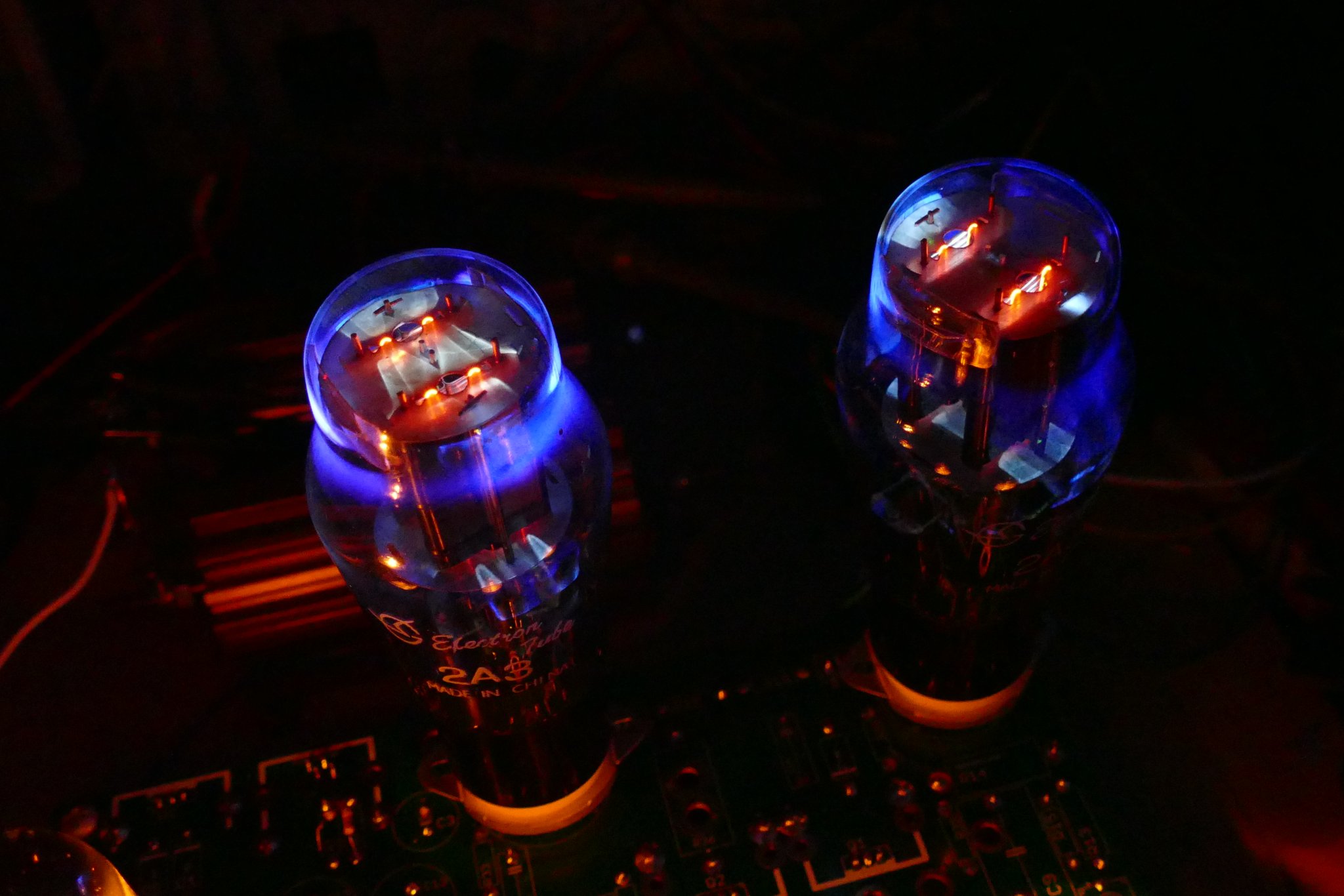

They ROCK, that's what. I ran them at 65 mA with an actual plate voltage of about 390 volts using a 3000 ohm Toroidy OPT. This is a dissipation of 25.4 watts. I liked the way they sounded well enough to leave it set up on the bench for several weeks until I needed to put an UNSET board back on the bench. The tubes were rock solid after about an hour of run time as I never had to touch the bias pots after that.
Ever see blue fluorescence on the glass of a DHT?
I have some cheap china 2a3's that all have that blue glow. I got them all for FREE from a friend who does audiophool upgrades. 😉
Despite being of 'budget' heritage, (1990's China) most of them are VERY GOOD so long as you run them with high enough plate voltage.
The Blue Glow is very eye-catching at night!

My 300B-Z tubes blue glow like that around the tops.Ever see blue fluorescence on the glass of a DHT?
