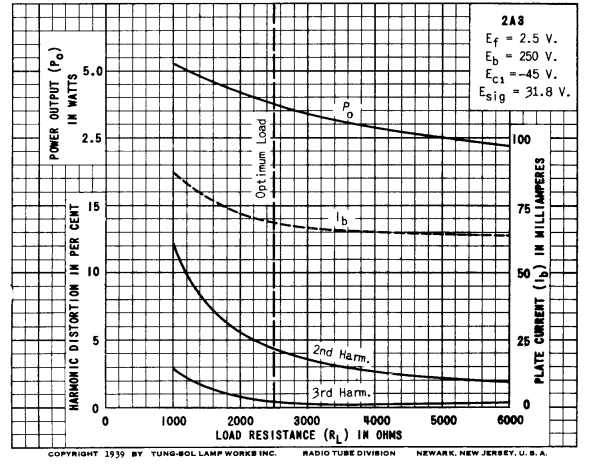

I attach a picture taken from the TungSol 2A3 datasheet than explains things better than any words. Here you can see that 2nd harmonic is present in non-negligible amount for ANY load. I would say that has an asymptotic behaviour for higher values of anode load. It doesn't get less than 2%, that is about half of 2H for the optimal load, while the output power is just less and less.

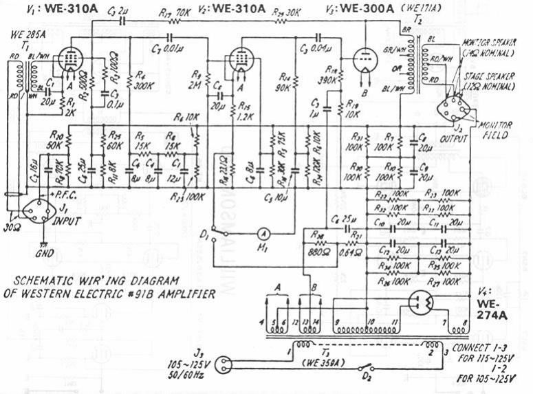

This design you reference (the 'WE91 for 1992' or 'Angela 91') is from Joe Roberts circa 1992 when it was published in sound practices. It is not the original WE91 circuit.I don’t understand the sentiment that a 6SN7 isn’t beefy enough to drive a 300B. The tube was designed to be driven from a high gain pentode. The Angela 91 is almost a direct copy of the original WE circuit and uses a 6SJ7.
The 300b was introduced by Western Electric to amplify telephone signals way back in 1938. The original circuits look like typical telephone line amplification circuits of the day and use lots of transformers (input, interstage, output, etc.).
If you want to use cascode 6SN7 to drive 300B like in the schematic posted here then I have no problem with that. I never did.
I am Sorry that I mentioned that with only 4mA current and high output impedance, cascoded 6SN7 would not be a great performer in driving 300b. That was my experience with low current high impedance circuits driving 300b - even ones with large voltage swings.
And I am sorry I tried to provide some ideas on how to make this circuit a better performer too. The mosfet follower has been used by many others before me, such as Tubelab (George).
I like cascodes and have used them in other circuits where they perform very well and their shortcomings are not important. You can use a cascode 6SN7 in a phono stage, for example. That is quite interesting.
Thanks for posting this. I'm sure this design goes back to the 1940's. I believe it was used in movie theaters.

In a SE transformer with DC current and no inversion of the magnetic field H (Bdc > Bac, at all signal levels) core losses are much lower than a PP transformer or power transformer. The presence of the air gap linearizes the hysteresis loop which becomes much narrower. Roughly I would say that loss is easily 10-20 times less. This also one reason why I have always thought that exotic cores, with very low losses, are best used with no DC current (small signal or PP interstage and output transformers). In fact, for example, Jensen defines the insertion loss only based on source resistance, dc resistance and transformer impedance as their transformers do not allow DC current but use mu-metal or similar core. The error is really small and not worth considering.If copper loss has been established, add in a similar amount for iron loss to get closer to the bottom line.

That means my concept works for high plate impedance pentodes and beam power tubes, and works for medium to low plate impedance triodes.
Transformer loss; or tube + transformer loss.
Generally, a pentode or beam power tube has less internal power loss, versus a triode internal power loss.
Then your measurement is not valid for the transformer in actual use. With no DC current in it, any stationary (sinusoidal, I guess) signal you will apply will result in the inversion of the magnetic field H. When it crosses the zero, the hysteresis loop will have an anomaly, it will be larger and so core loss will be higher.
You could also have a look at distortion, when H gets inverted distortion increases and it looks like saturation but it's not. Just similar spectrum.....that's why the DC induction must be higher than AC induction. This does not happen in gapless (or with very small natural gap) PP transformers but core loss is higher than the equivalent SE.

No problem. Just saying that your SE transformer has more likely some 0.7 dB loss in actual use, which is still ok.
Typical classification for output transformers is: loss<0.5 dB is higher quality, 0.5<loss<0.8 average, loss>0.8 lower quality.
Of course, the overall quality is also related to the other parameters: inductance, FR etc....
By the way, to be precise, it is called insertion loss because it's happening upon the insertion of a device (the power tube). The transformer alone would be classified in terms of efficiency or power loss (i.e. 10xlog[efficiency]).
