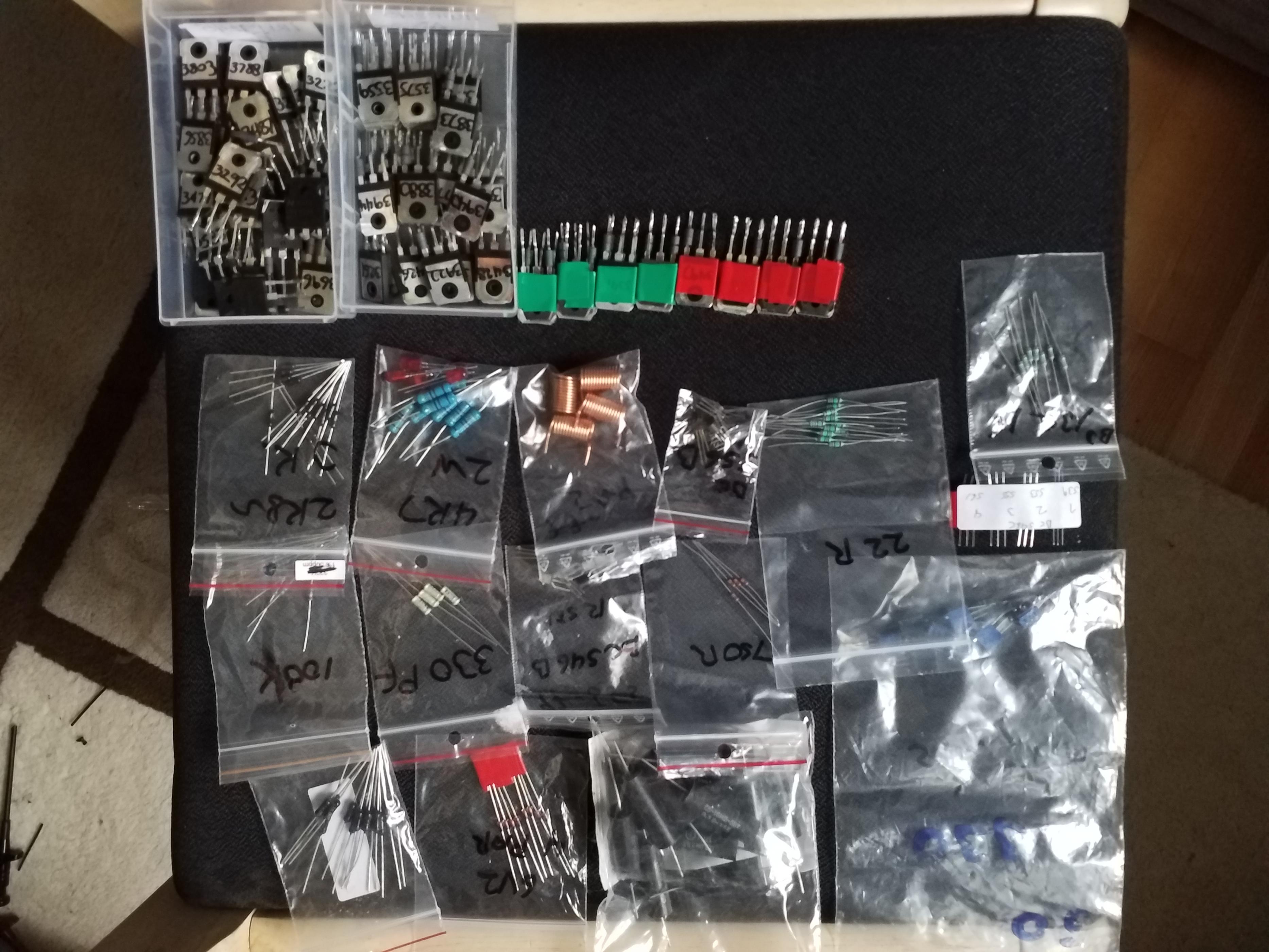

Yes it's quite amazing, I'm waiting for 4 pcb, I have all parts ready, closely matched, and original Samsung mosfet, almost as good as Christmas🙂
Did you make your own PCB? Who is your PCB fabricator or seller? Where did you get the "closely matched" transistors?Yes it's quite amazing, I'm waiting for 4 pcb, I have all parts ready, closely matched, and original Samsung mosfet, almost as good as Christmas🙂

As I wrote above, jlester a member here on diyaudio sells those pcb on ebay.
As for the mosfet I have around 60 of each irfp9240/irfp240 stripped from power amps from the 90s, I reuse, they are vgs matched at 200ma, and pretty close.
