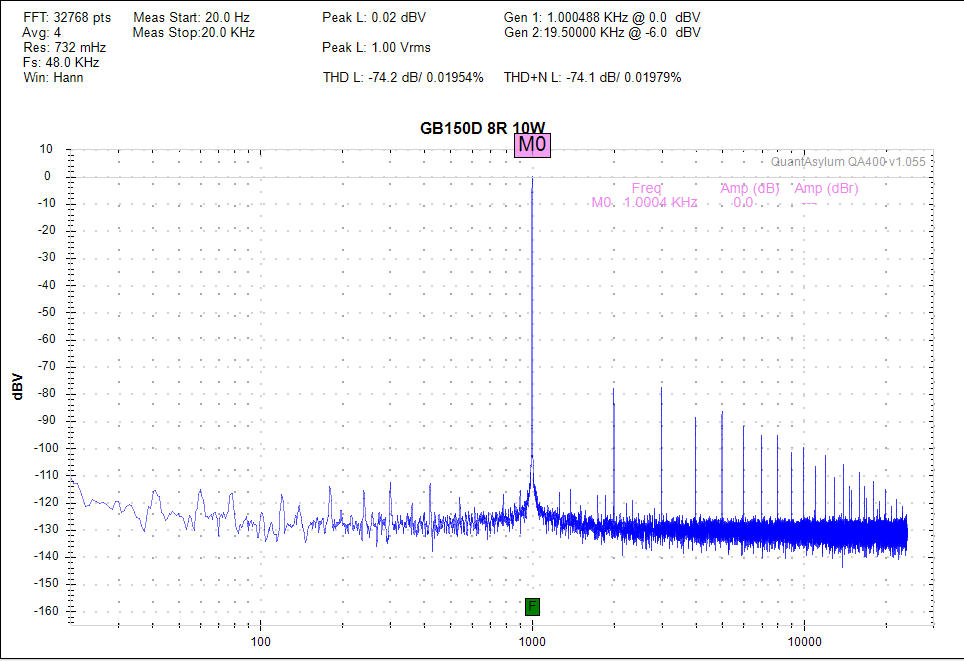

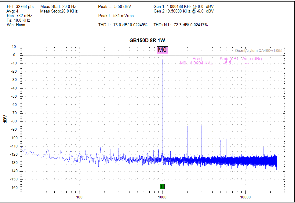

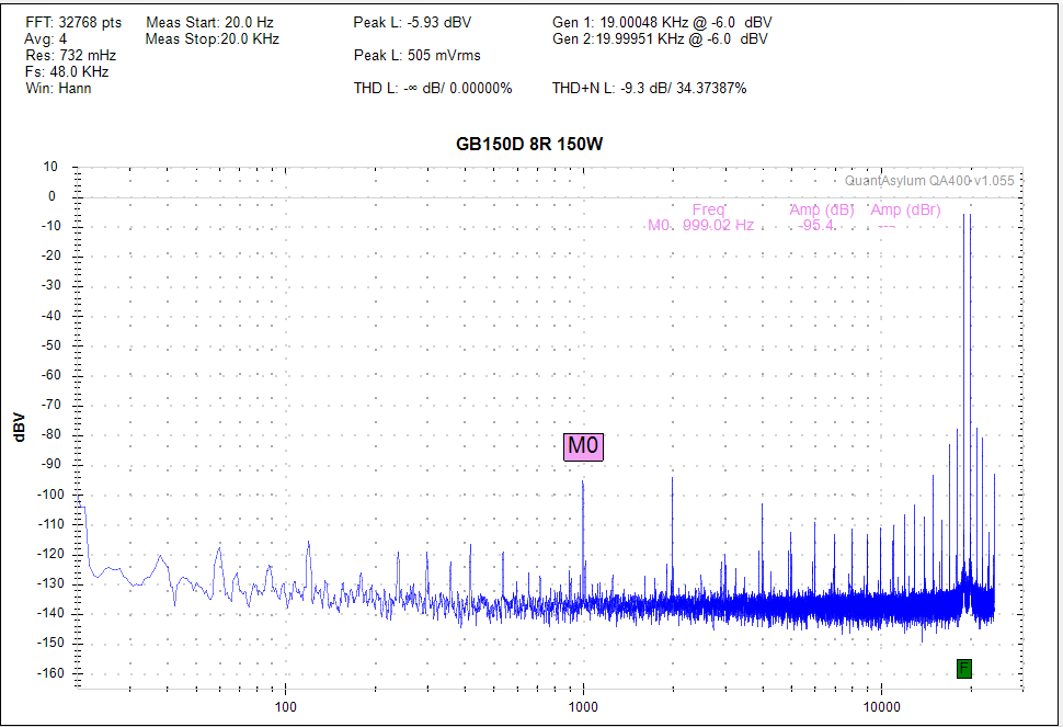

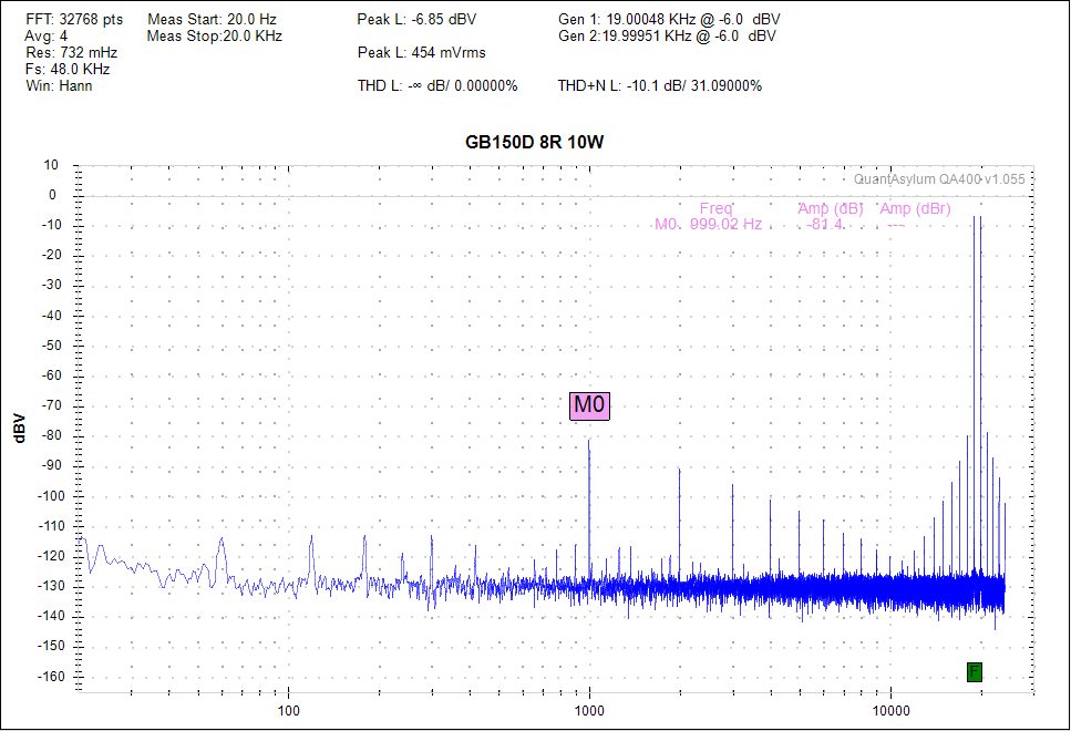

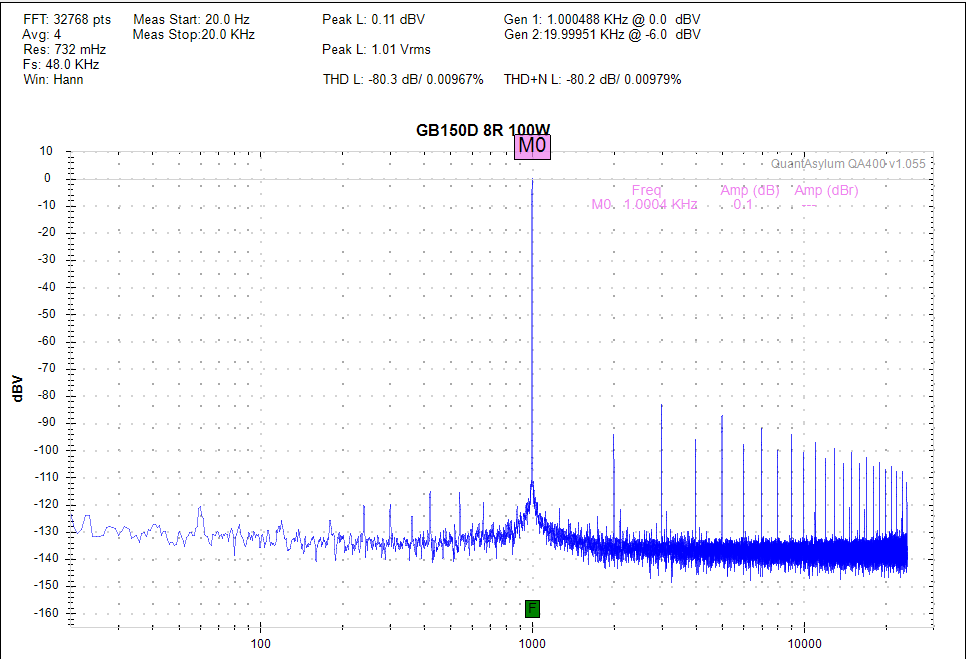

The post I referred to wasn't on this site and my link is dead now. It was the typical IMD 19+20kHz test IIRC. The distortion was mostly 2nd and 3rd harmonic in character with a slight elevation in the 5th order at 150W. The speed of the supply would seem to help this amp so an SMPS should outperform a linear supply if you can avoid the RF and switching noise.
I repeated THD measurements with IMD for 8 ohms load 1W, 10W, 100W, 150W.
QA400 doesn't have IMD calculation, but we can just inspect the 1khz, 2nd order IMD product.
https://www.quantasylum.com/content/Home/tabid/40/Post/213/QA400-IMD-Measurements
The original signal is attenuated to -6dbV for 1W measurement and attenuated to 0dbV for 10W, 100W and 150W measurements, I assume that the IMD mixing product is also attenuated and has the same ratio as the original signal? (correct me if i'm wrong)
Best is 16.98ppm, -95.4dB (150W) and worst is 175.79ppm, -75.1dB (1W) if we only consider the 1khz mixing product...

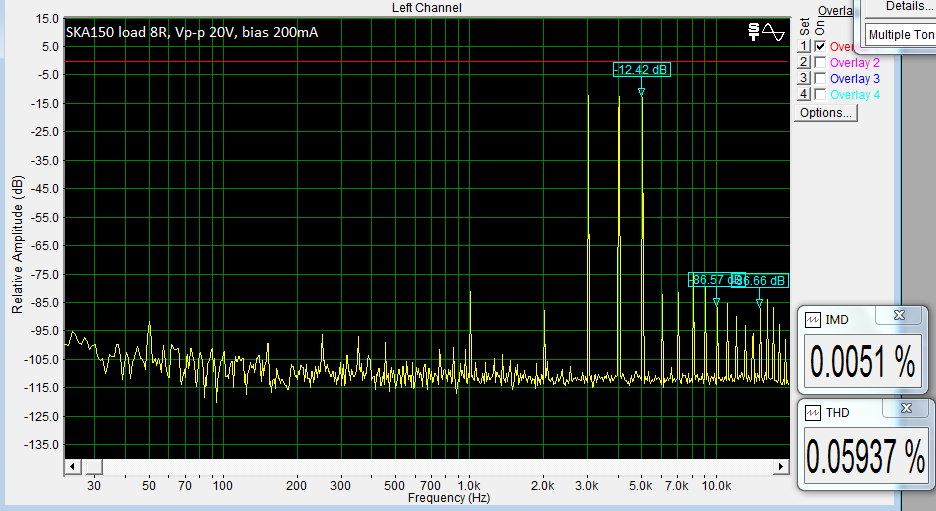

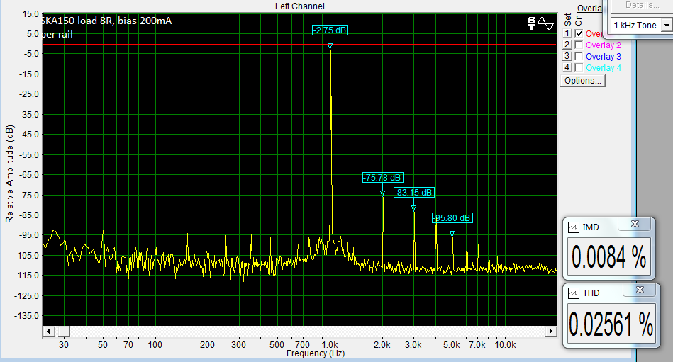

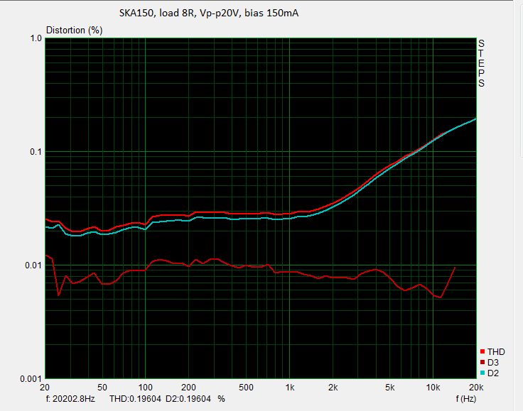

It may be usefull or not but a few years back I have made a board for SKA150, some resaults bellow. The zobel network is very important in this design !! Must be soldered on the board.

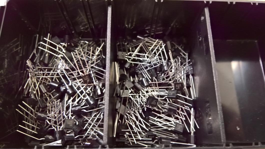

Thanks Anders good to know. What sort of hfe range did you find?
Hi Pete,
I randomly picked 10 of each gender and measured.
Diotec hfe results at 6 mA
BC546C: 504, 544, 539, 479, 519, 483, 485, 518, 486, 543
BC556C: 528, 566, 508, 542, 463, 488, 560, 539, 497, 536

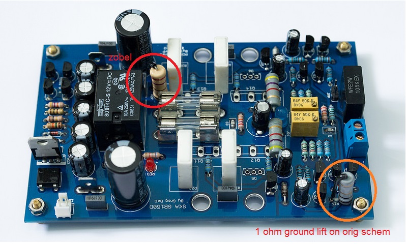

Regards
Peter
Nice to see similar harmonic profile, which shows why this amp has a "thick" sound.

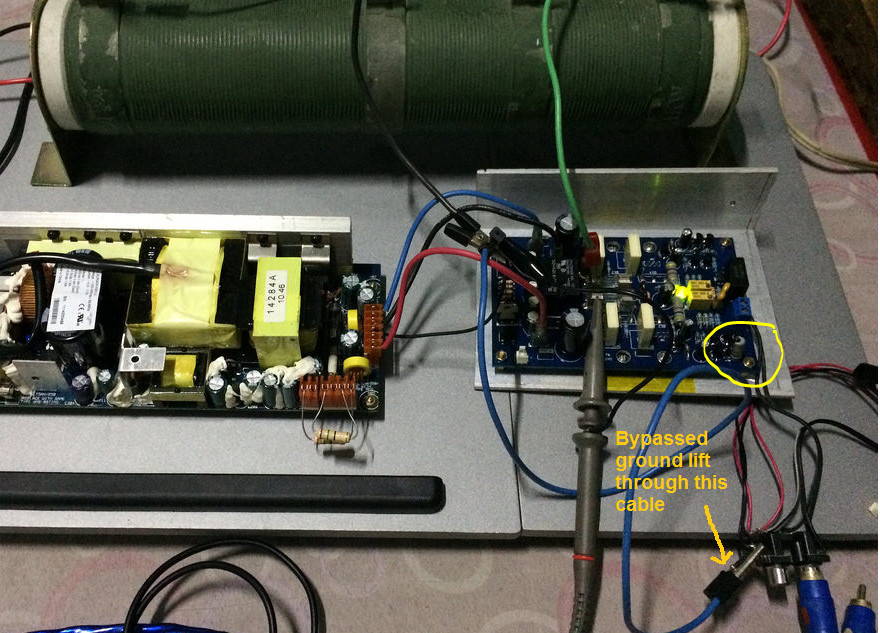

I used onboard zobel, see attached pic, also for the record, I bypassed the 1 ohm ground lift, when I measured the amp..
