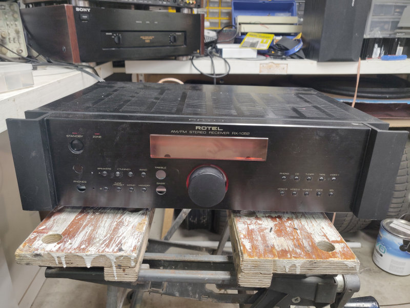

Ok, I've got a functioning amp that sounds very nice. My issue with the channel I was struggling with was I had an input transistor in backwards. I've never ever made a mistake like that working on cars.... Hehe. So got both channels sorted. I set dc offset to 2.5mv on each channel, and bias to 75ma on each channel. I will see how the amp feels after running for an extended period, and then toy with turning it up a bit. I believe 100ma is what the recommended setting is, is that correct?
I wired up a alps 40k pot for attenuation just because I can't have a gaping huge hole there with a giant knob that doesn't do anything. I need to figure out a button for the faceplate to power the unit on. I have a simple pushbutton, and will likely run it to an arduino to control the that turns the unit on when it is in standby, as well as a power indicator led, and perhaps a small lcd screen that can act as a vu meter or rail voltage ind, whatever. Anyway, I have a good amp it appears, and after listening for awhile I will come back and post my impressions vs the phase linear it just displaced, as well as the two honey badgers I have built (and love). Cracker and Cake being served up tonight!

I'm glad you found the error, I have done that mistake several times too.
It's a great joy to think a project, source parts, tinkering and assembly, and then end up with something that actually works, and works well.
Regarding bias, some run them hot, others don't, theres alot of threads on that subject, if you have access to let's say arta you can adjust bias to meet lowest possible distortion.

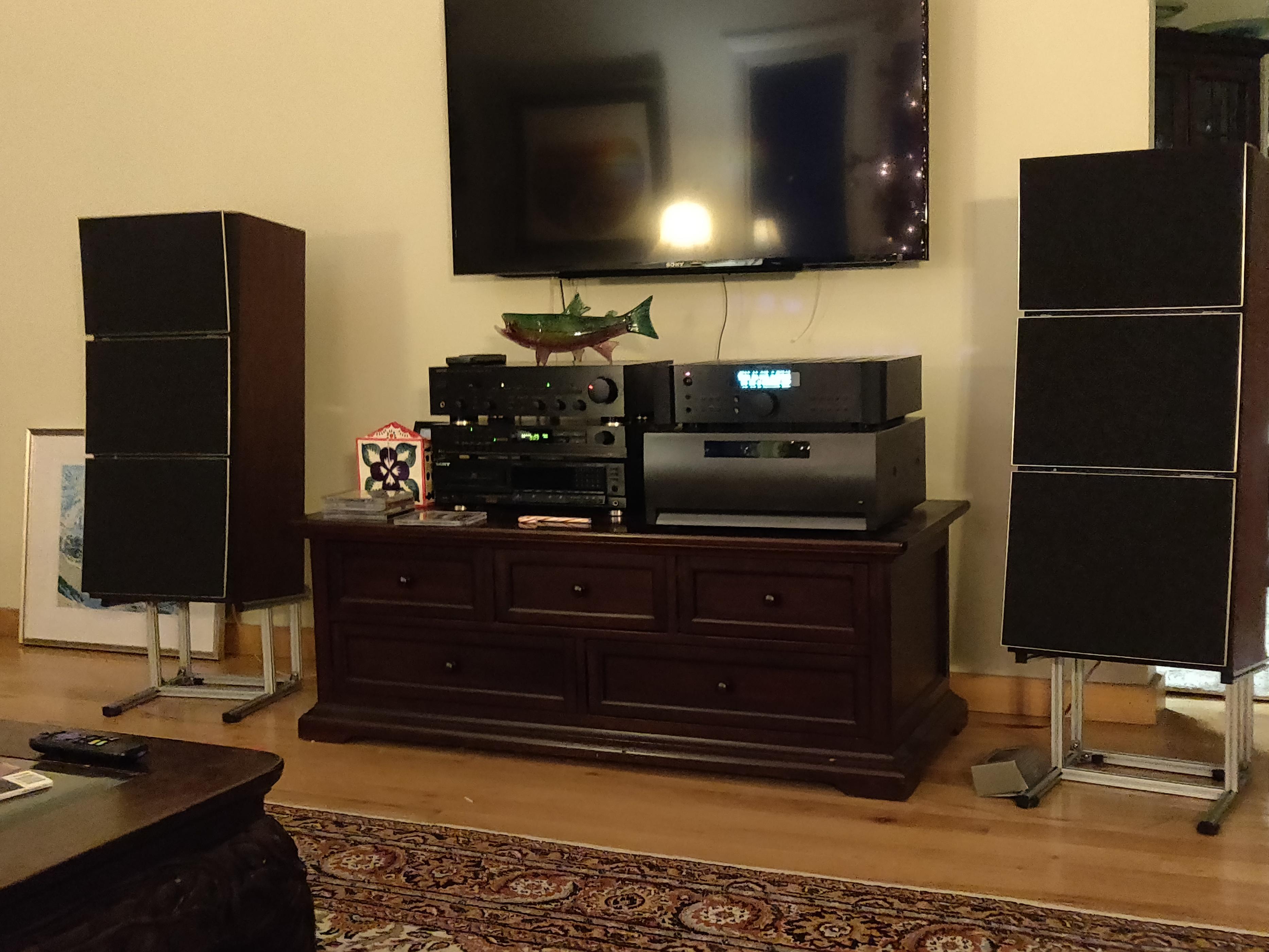

Moved it upstairs to the main living room where the system is a bit different. Cd optical to a Sony ta-e1000esd preamp. Speakers are large bang and olufsen ms150. Regular duty amp here is a honey badger in an arcam receiver case with large power supply. In this setting the amp lacks oomph for lack of a better word. It just doesn't have the power to push the ms150 power sponges. It sounds nice at lower volumes, similar to how it sounds in the basement, but it starts to sound muddy and muffled as I turn the volume knob up.
My thought is... The amp is being held back by the small transformer. Transformer is a unit from a rotel rx1052, which is a 100x2 receiver. I have 40,000uf in a capacitor bank pilfered from the arcam. The supply is straight from the rectifier to the caps and out for each side, not crc, or clc. And provides 59v rails. I don't hear clipping it just starts to sound soft. I think I will remove the cover, crank it up and see if the voltage is sagging significantly. I suspect it is. Regardless if I make changes to this or not, it sounds wonderful in the basement, and I will be happy with it if I choose to leave it down there.

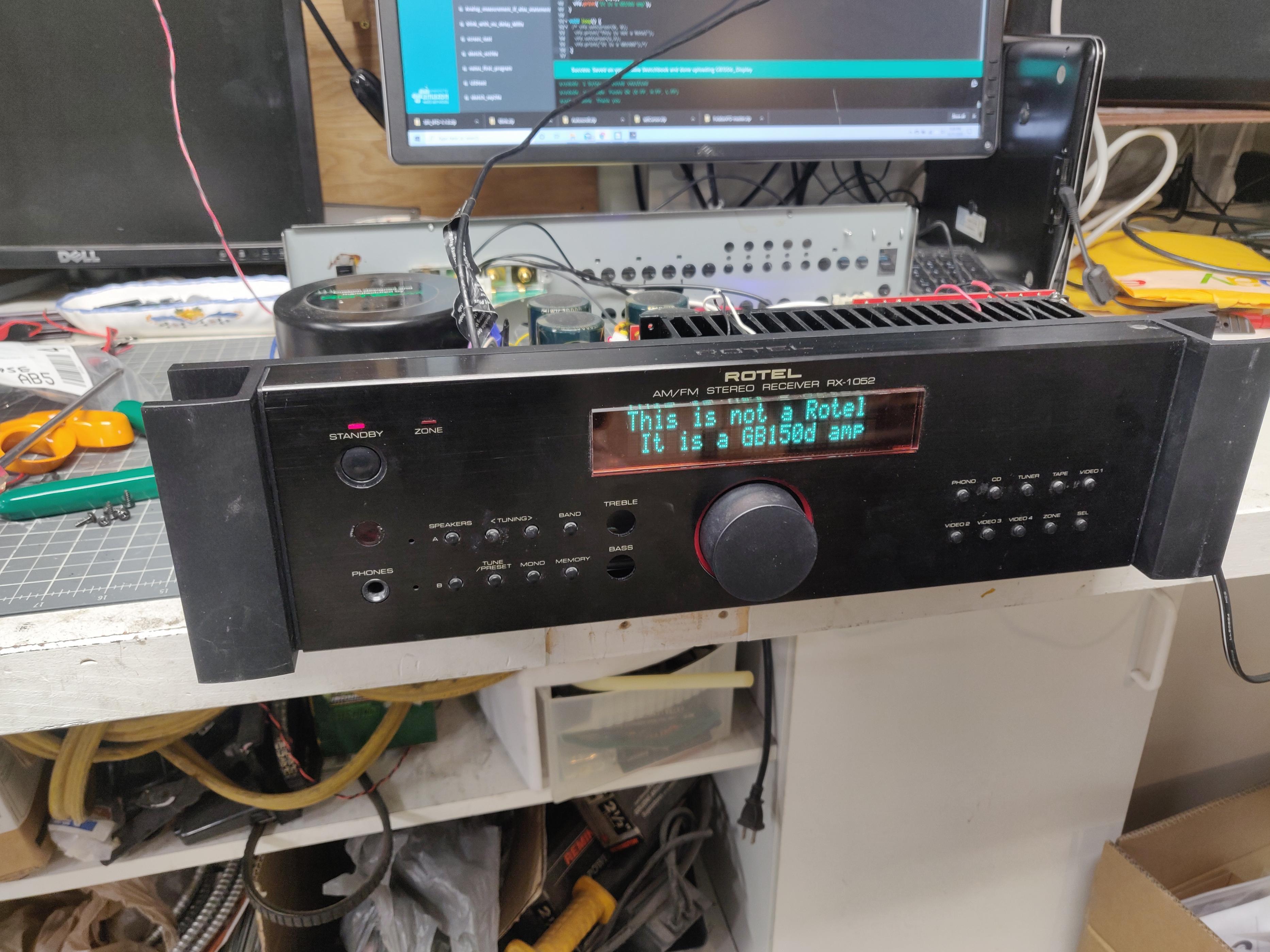

I have some more stuff coming for it, I ordered up a futaba vfd display, and will see if I can find some fun stuff to do with it in all that space in the case, maybe vu meter, rail voltage monitor, proper standby on off switch on the face...
I don't know what I was listening too in my last review, but after a long hiatus, the gb150d is back in my main system upstairs in the living room, and we've been listening to it all day today. It is very good. It's true that higher frequencies are not as pronounced as the honey badger, but I've been really enjoying it today. It really shined with Chick Corea's piano on his Acoustik band album. It has been my garage workbench near field listening amp for months now, and it is great down there. But it does have the power to push the big ms150 power sponge speakers in the living to well past moderate levels (again, I think the stock rotel transformer doesn't have quite the juice the amp really requires to reach full potential).
I did manage to get a display fitted, so it is a little more presentable...
Very pleased with the amp. Also, I can't believe I actually got the display to work properly.
