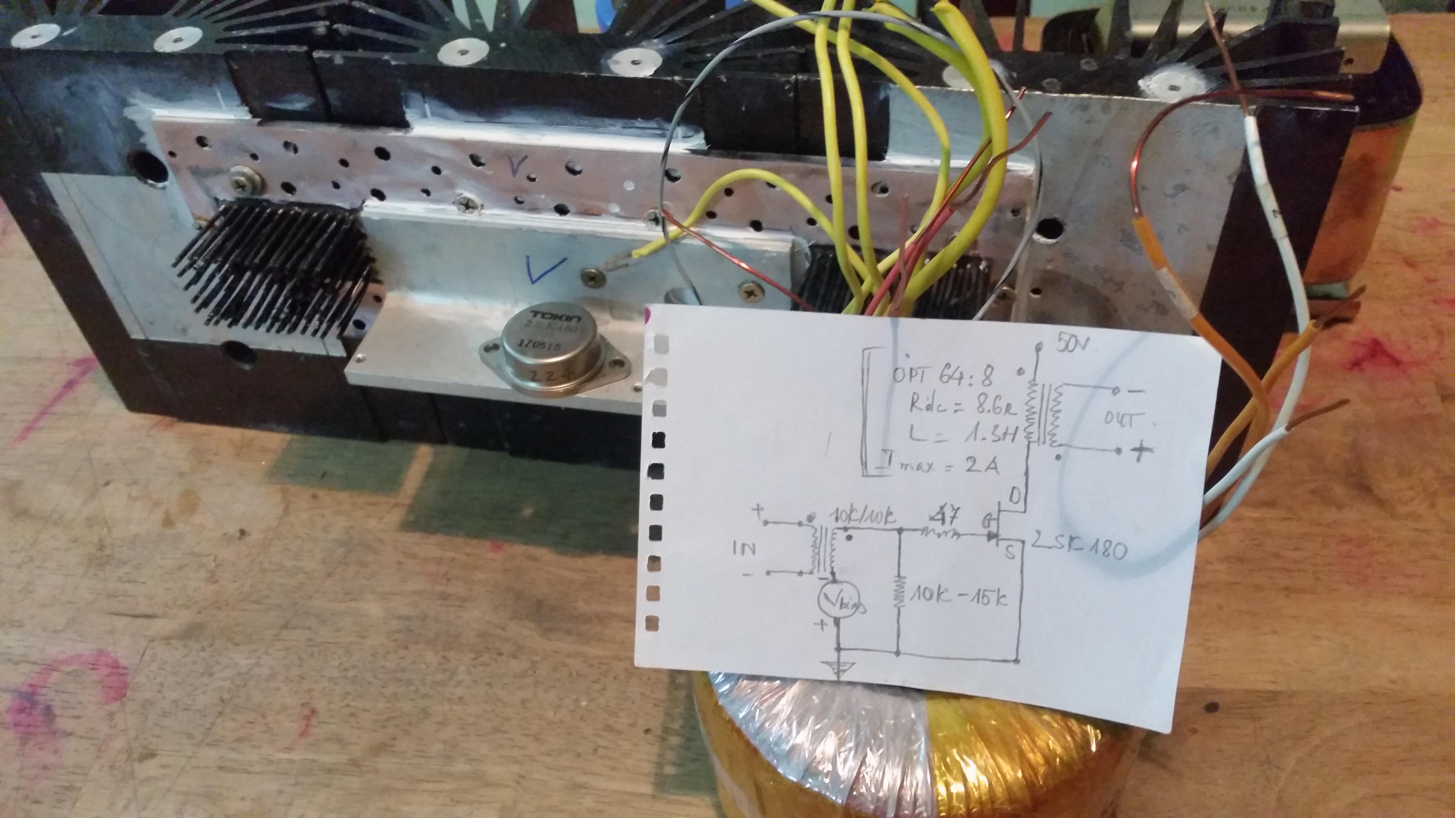

it'll work
you don't need that 10-15K from gate to gnd
also - your heatspreader plate isn't thick and long enough
L bracket is so-so .......
solve it using longer L bracket alone , without additional heat spreader plate
Tks Mr. ZM! You are right.
I think lot about that 10k res.
In SIT Amp I will use JT-11p-1TB as input trans at first test because I believe in it and know exactly its sound. http://www.jensen-transformers.com/wp-content/uploads/2014/08/jt-11p-1.pdf
In FT-11P- 1xx 10k/10k type, Jensen alway say "RL must be 10k or greater for ......... " and JS use Rs=600r and Rl= 10k in all test.
In SIT Amp with 1:1 10k input trans without Rl or Ironamp, input impedance seem floating because input trans behave like repeat_coil I think so and I want to have a test. When I build Ironamp, it sound extremly beautiful immediatly so I don't dare to change anything event resolder some ugly point ... SIT amp give me a chance to test that 10k res.

Do your 2SK180 sit was tested with curve tracer ?
What is his batch serial number ?
I remember few X, Y, Z series sit's was with less desirable characteristics.

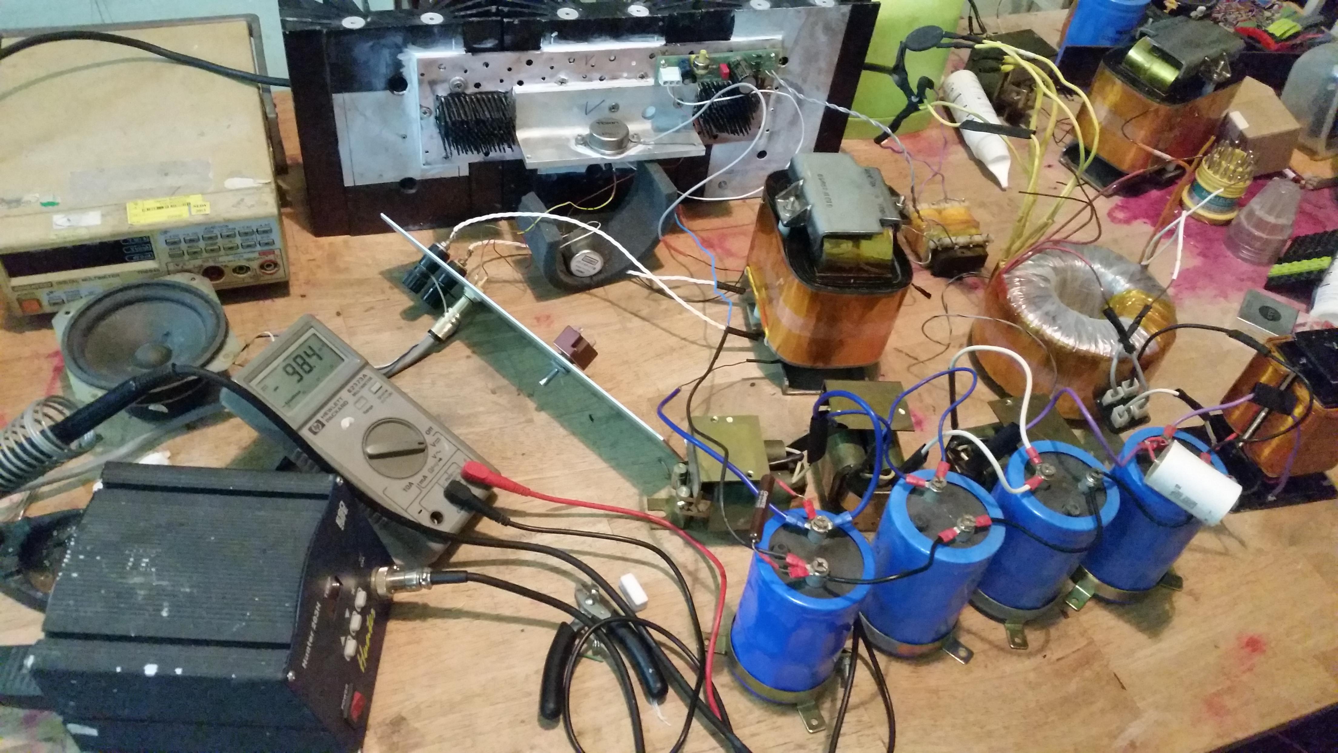

I read and vew nearly all articles or videos about SIT of Mr Pass and MR, that why my OPT for SITamp was built to withstand 2A - 64:8 or 4A if use 32:8. Unfortunately, my OPT was beginning to be warm at 2A so I had to reduce bias to 1.8A at first test. I'll increase B+ or try 32:8 later when I "vechai" out parts fit with changes.
If anyone love 211 tube and don't have Pass SIT.1, try SITamp with 2sk180. Even though all my mistakes it sound very great 😀
