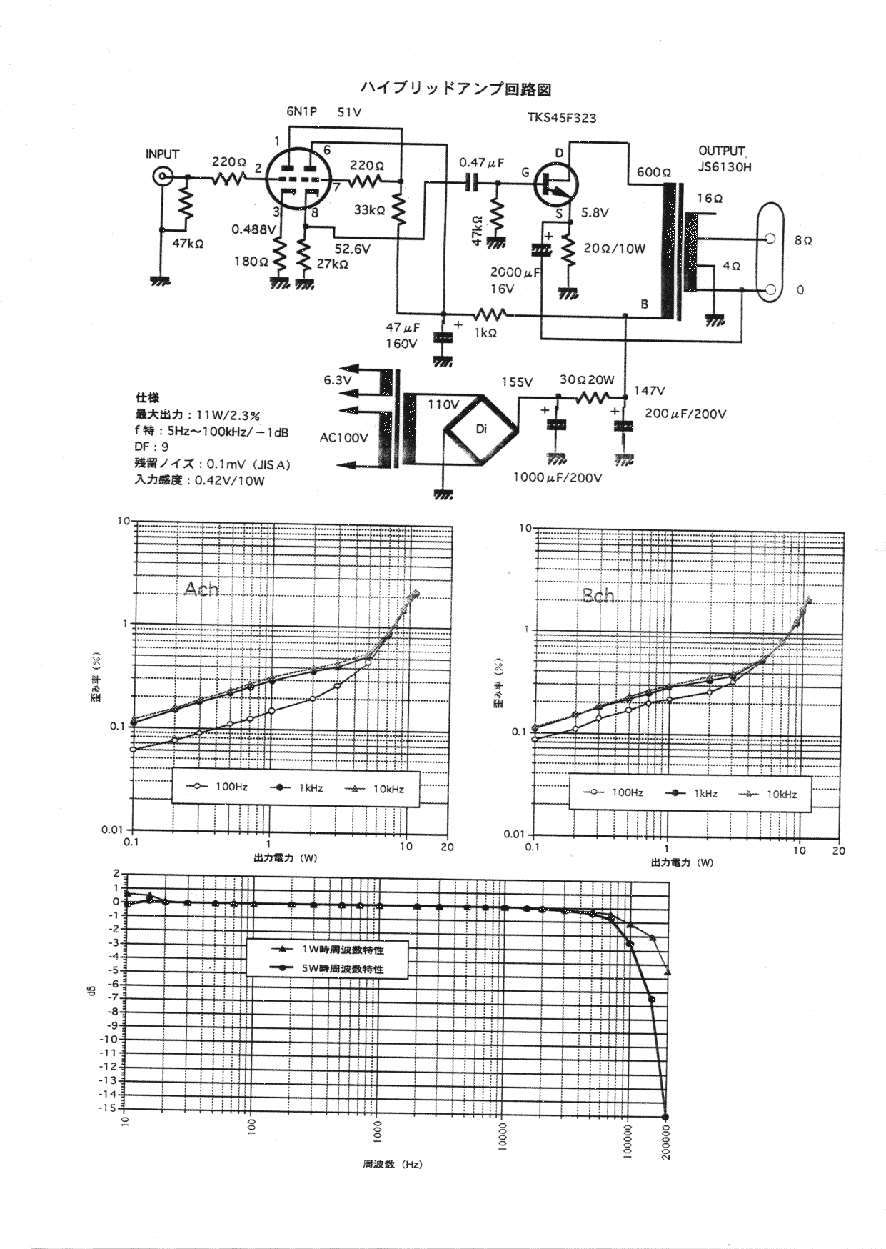

Papa told me: the FG-50S and PASS SIT 1 transistor will have the best combine if I connect 32 ohm tap primary with 25VDC at 1A bias🙄

Thanks! Using tube buffer is a good idea but I think the tube with output transformer is better🙄
You`r right ,
just to add , at that specific schematic good 600ohm SE-OPT dedicated for 6C33C tube will do the job .
....I built Arch Nemesis and Ironamp, both have a very good sound and I know the quality of parts are very important so... I think it's just some modify from origin SIT Nemesis for better sound because I have no best input capacitor. My target for input transformer is Tango NN-6 or NN-600-600 with Permalloy core😛

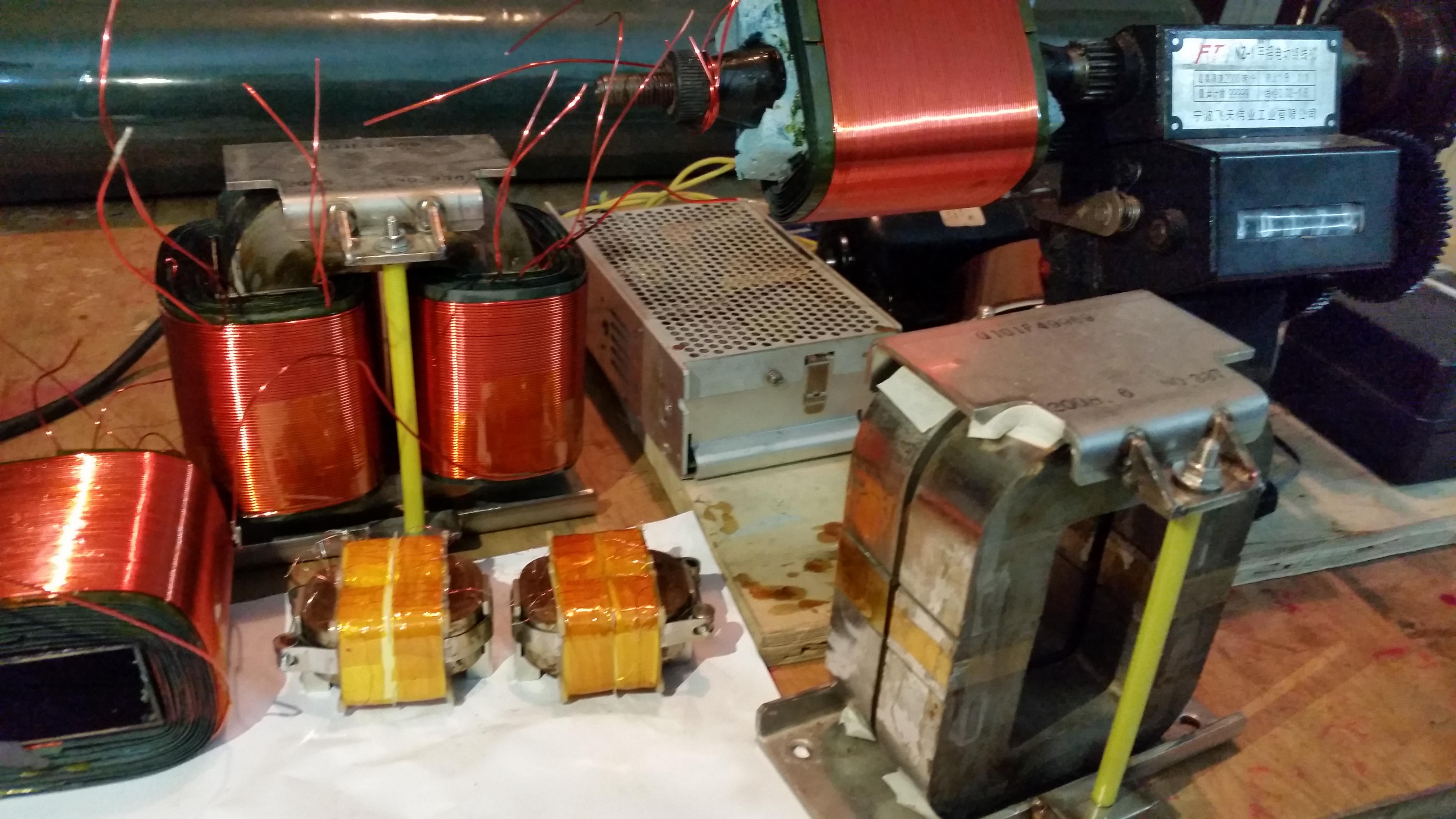

I bought a pair of Tango NN-600-600 for my SIT Nemesis, it will be use as input transformer🙄
well , just for curiosity sake , do you mind measuring Rdc and L of full primary and full secondary ?
TIA
TIA
The Rdc is about 18 ohm per coil (150 ohm), unfortunately that I have no Henry meter so I can't..., you can get more detail in the specification below: http://www.tubebooks.org/file_downloads/tango_tamura/Tango_NN-600-600.pdf
My father have a vacation at Canada so he bought for me a Plitron low noise transformer. He will bring it to me when he comeback to Viet Nam in the end of October😛
