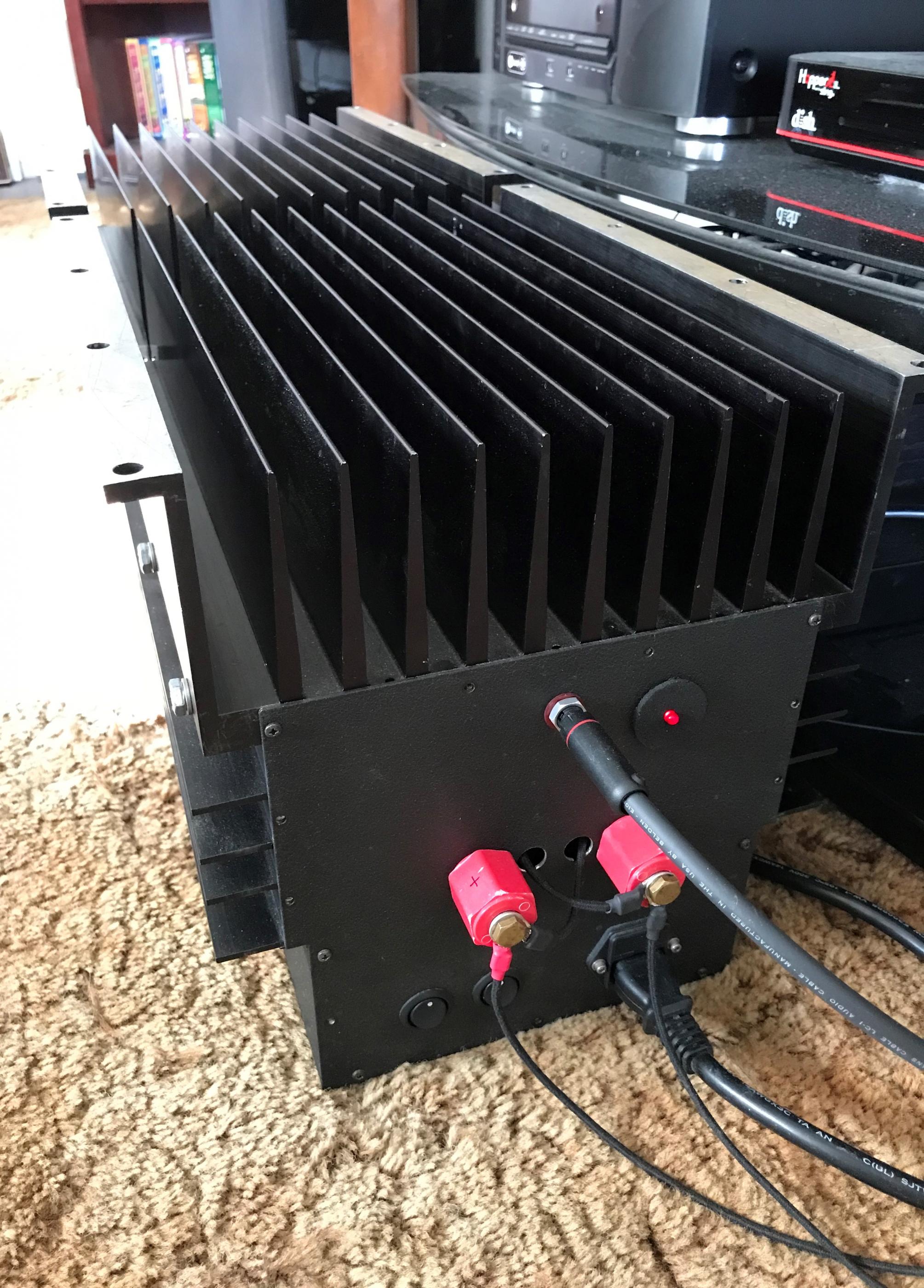

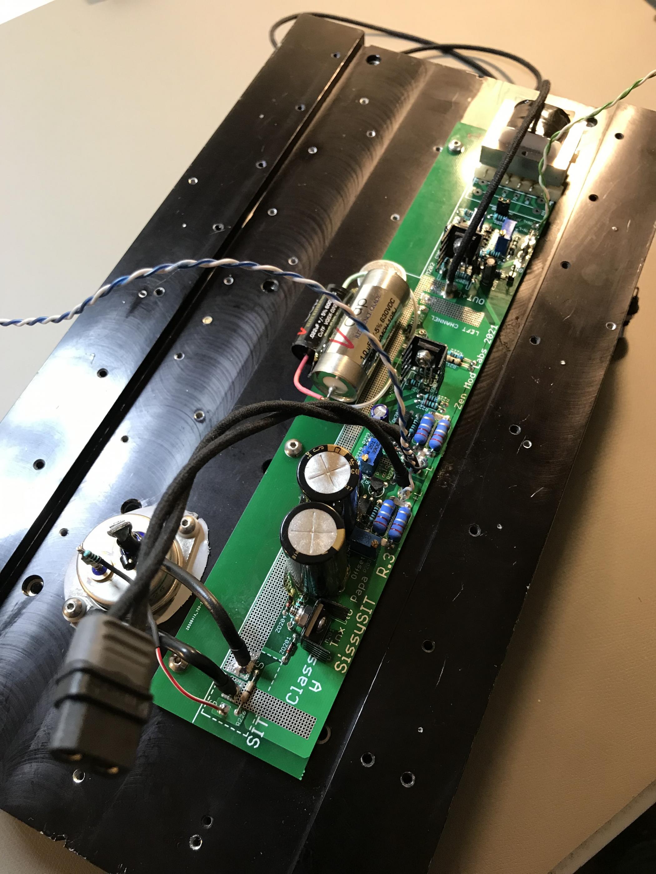

SS rework..
...continued from #529.. Show and tell.. Only a couple of hours playing time for the pair. New car smell too strong right now for proper review. But initial impression is very good. Typical "blanket removed" sort of improvement when you upgrade to better quality parts in mission critical areas. Stock amp maybe 8.9 out of 10, now 9.2 with well recorded acoustic source material. Maybe not so noticeable on your favorite Cannibal Corpse track...
No huge rework here. Removed stock C103 and C104. Replaced with VCAP ODAM 1uF bypassed with VCAP CuTF .022 uF after correspondence with Mr. VenHaus, and ZM concerning value itself. 100's of hours pre break-in on these film caps with an Agilent waveform generator, 100Hz-20kHz swept square wave (logarithmic scale), 20V p-p into 700 ohm load. Removed stock C105 and C106. Replaced with a pair of Nichicon KZ 1000 uF / 50V 'lytics in parallel. Replaced ferromagnetic hardware with non, ferro binding post delete. Mounted industrial isolators with quality tinned-copper ring terminals on amp and speaker leads, brass 1/4-20 bolts. Duelund tinned-copper DCA12GA inside and out. KLE Harmony RCA connections. LED power on relocate. XT60 connectors for the rail supply (my weird "ship in a bottle" amp configuration is hard to work with). Two switches there are for manual soft start, already had that though.
