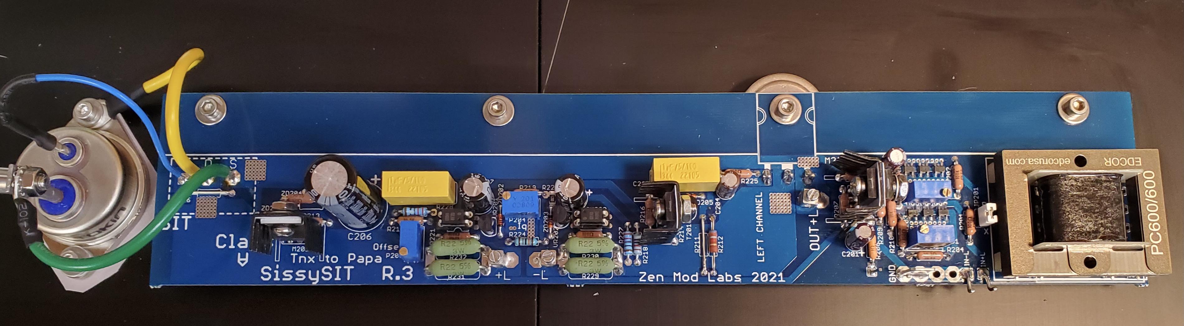

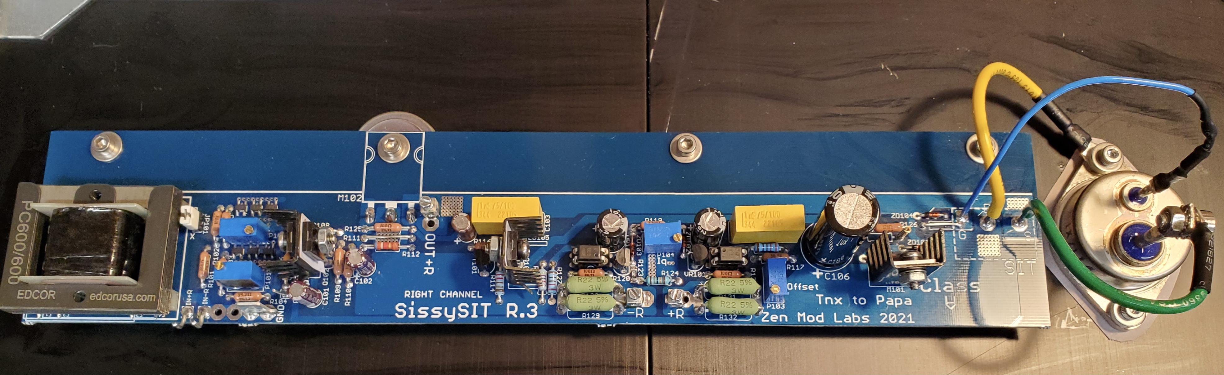

I am working on my SissySit R.3 and have a problem common to both channels.
Using ZM's boards, standard dual mono power supply with 22v5 rails, all parts from reputable sources, including the THF-51s SITs. All parts checked for correct value / function prior to assembly. I even checked zener voltages and BD139/140s on an Atlas DCA75 Pro transistor checker.
I am using the Edcor PC 600/600 autoformers.
The boards went together without a problem and have biased up without a hiccup. 1A7 per channel, 200mv Iq on the buffer, stable zeroed offset on the buffer and outputs.
My problem is no signal making it to the outputs.
I attached the amp to speakers, no hum or buzz noted. But no sound output.
I went back to dummy loads and injected a 1v 1000hz signal and get 1v0 at the jumper, stepped up voltage, I think about 2v at pin 6 of the edcor, but from pin 5 all the way to the outputs, no AC voltage noted at the jumped R111 spot, or gate and source of the THF. The signal is a clean sine wave up to Pin 5, then nothing.
I checked the windings and all are OK, and reflowed the Edcor solder joints, no change noted. They are mounted in correct orientation on the boards.
All component orientations were rechecked, no shorts noted after 4x checking the top and bottom of boards.

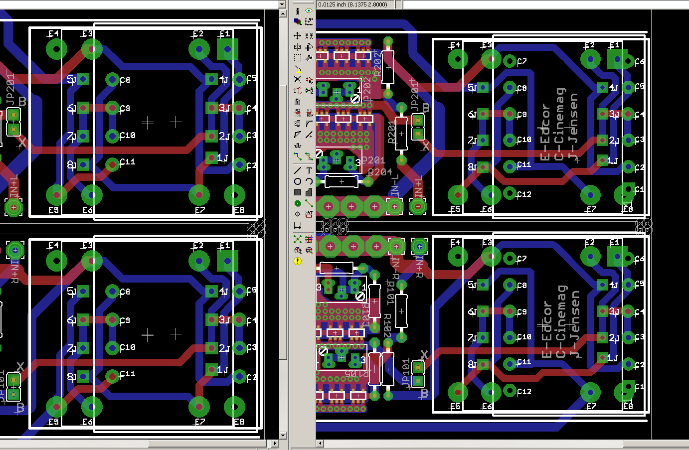

Problem is known - we already solved it in one of threads with construction using those 3 xformers (combined/per choice)
can't remember was it Iron Pre or some of other amps having same FE as SissySIT
reason - Edcor 600:600 having mislabeled/wrong pinout in their Datasheet
will prepare graphical how-to for you tomorrow, now too sleepy
of course that , as soon I got to that omission, I did corrected it in pcb files, but evidently after you got your set
edit: I did check pcbs with Cinemag and with Jensens (which I both have) but didn't had Edcor 600:600 on hand, so I logically trusted in their datasheet
well, for tonight "just" this :

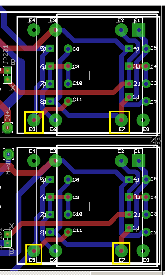

you need first to isolate, then reverse connection of Edcor pins 5 and 7
trouble is - if you want to do that on pcb, you must to desolder them out of pcb, to have approach to upper copper traces
easy way of doing that is with desoldering station (sucking de-solder gun); any other way is more tedious and tricky - using manual solder sucker is not so effective and you need to take care of temperature, or xformer pins are going outa plastic bobin
other way - already done by one clever Greedy Boy - he made operation on Edcor itself - carefully desoldered wires from pins 5 and 7, and re-soldered it opposite (using some thin wire as extension)
if you need graphic how to for pcb salvage, buzzz and I'll post it tomorrow
now , without any markings, to enable clear view of traces;
left is - as is - Edcors bad, right is as I edited pcbs later
goal is to cut all traces (both bottom and top ones) connected to pins 5 and 7, then using xacto knife for scraping ends of cut traces, using thin wire and soldering them adequately, to establish proper connection of windings

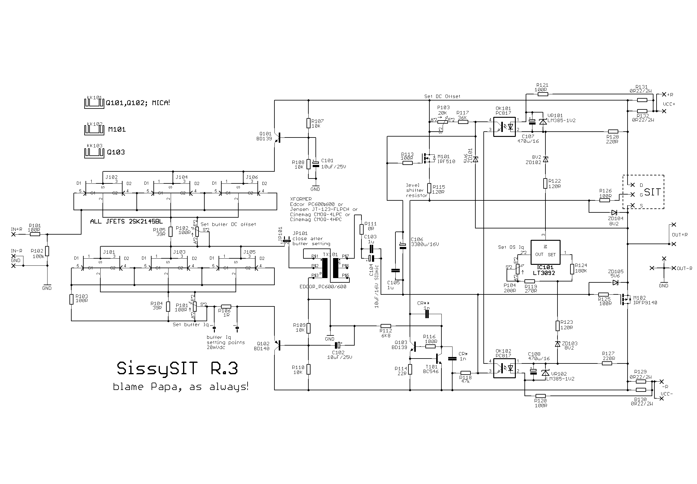

schematic with proper Edcor pinout marked also enclosed
in the end, prior to powering it On, check is simple, resistance measurement :
- Edcor pin 2 to GND (or jumper - pin X to GND) - reads XX Ohms
-R111(211) to GND - reads 4*(XX) Ohms
where XX is practically Rdc of one (of four) Edcor winding sections
if you need more help about cutting and connecting, say

I changed the transformer winding ends between pin 5 and 7 on my Edcor 600:600 transformers and all seems well now.
