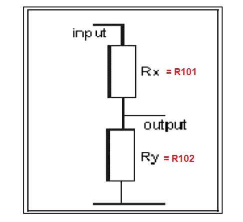

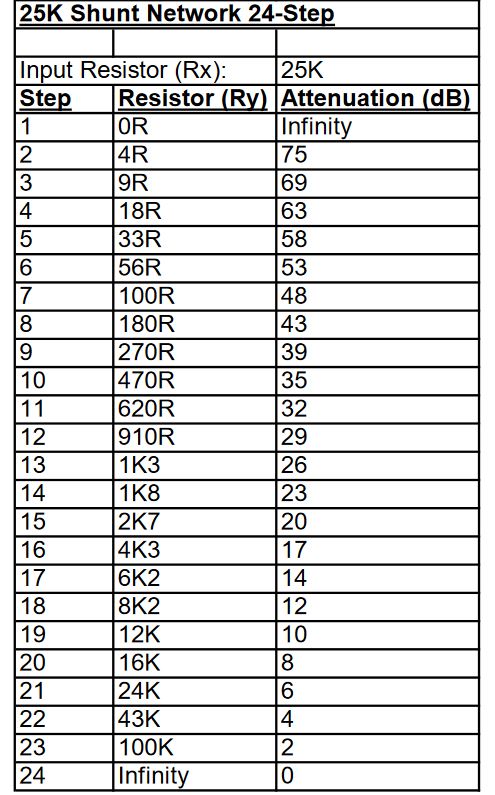

A while back I posted about inserting a passive attenuator right in front of the SissySIT buffer and I now have to assemble the attenuator ready for installation - the overall project is progressing well and I'm now close to installing the SissySIT board and hooking it up.
Just to be clear, my SissySIT will be used with a single source so the attenuator will be in the SissySIT chassis just a few centimetres from the PCB inputs. I plan to use a shunt attenuator. I will, at various times, plug in different source components but none of them are problematic in terms of having unusually high output impedances, though some are only around 600mV output.
Anyway, I'm seeking advice on the optimal configuration of the attenuator with respect to the buffer input, specifically R101 and R102 (referenced to the schematic in ZM's post #1). Should I just connect the output of the attenuator to the SissySIT input (R101) or should I replace R101 and R102 with the attenuator, or maybe something else? I have to calculate and order the resistors for the attenuator so I can adapt the shunt resistor to an appropriate value, typically between 10K and 100K.

change Rin of Sissy to your liking, so it will serve as final shunting resistor for your attenuatorA while back I posted about inserting a passive attenuator right in front of the SissySIT buffer and I now have to assemble the attenuator ready for installation - the overall project is progressing well and I'm now close to installing the SissySIT board and hooking it up.
Thanks mighty ZM, just to confirm the understanding of a simple mortal is my diagram below correct? If so, for a 25K0 shunt attenuator, R101 will be 25K0 and R102 will vary between 0R0 and infinity, as per the second attachment.
yup, like that
though most convenient way to do that, change onboard shunt resistor (R102) to 1Meg, so you can freely ignore Sissy as loading element (while still having 100R in place, serving as gate stopper resistor)
then assemble your attenuator as usual and that's it
