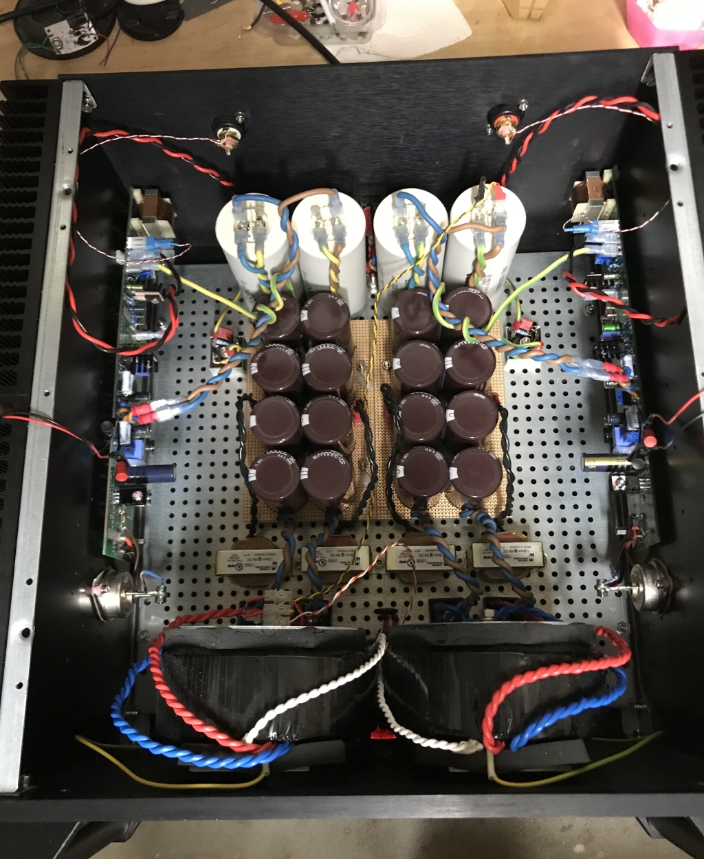

I have the amp in a 5U/400 chassis, with dual mono PSU, and I run a bias of about 1.85A; rail voltages +/- 25V. So, it takes a looong time to heat up fully, but then the heatsink temperature is in the range of 50 deg Celsius directly opposite the FET and SIT, and I can keep my hands for as long as I wish on the fins or the top of the heatsink everywhere.
The bias is nice, stable, and constant on both sides, and always has been; Zen Mod's new bias regulation scheme works a treat. :up:
Bias varies with temperature or rail voltage fluctuations by maybe +/- 5%.
Best regards, Claas

Yes, this is a CLC, dual-mono PSU.
Per channel:
- Toroidy audio grade transformers, 2 x 20V, 400VA
- simple standard bridge rectifiers
- 2 x 33mF per rail
- Hammond 156B - 1.5mH, 5A, 0.07R
- 2 x 33mF per rail
- 60uF motor run cap per rail to "cap it off" :D
In my M2 amp with "Stereo PSU" I have used Hammond 159ZL (2.5mH, 10A, 0.044R), but those were too big to fit 4 into one chassis ...
In my approach, I am going for a very low impedance of the PSU. That's why I have sub - 0.1R chokes there. Those filter better than your typical resistor value of around 0.1R in a CRC supply, and have lower impedance as well.
In my next "big" PSU, I will probably use DC-Link MKP capacitors instead of the motor runs. They are more compact, and you can fit more easily a lot of extra film capacitance to the PSU. In my tube amp PSUs, I'm already doing that. My EL84PP amp has only DC-Link MKPs in the B+ supply, no electrolytics.
Regards, Claas

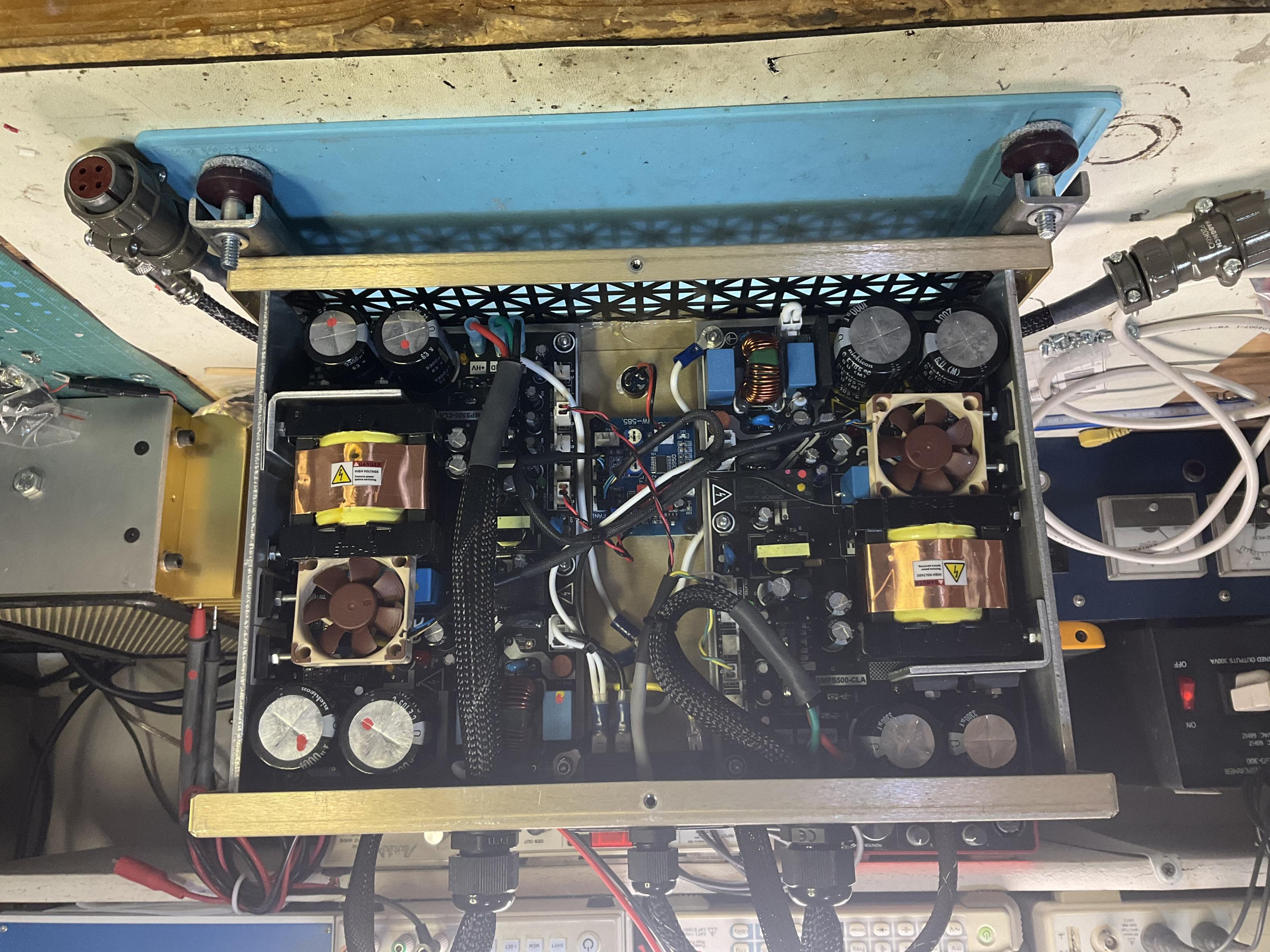

Super cool Bill!!
Are those 40mm Noctua’s?

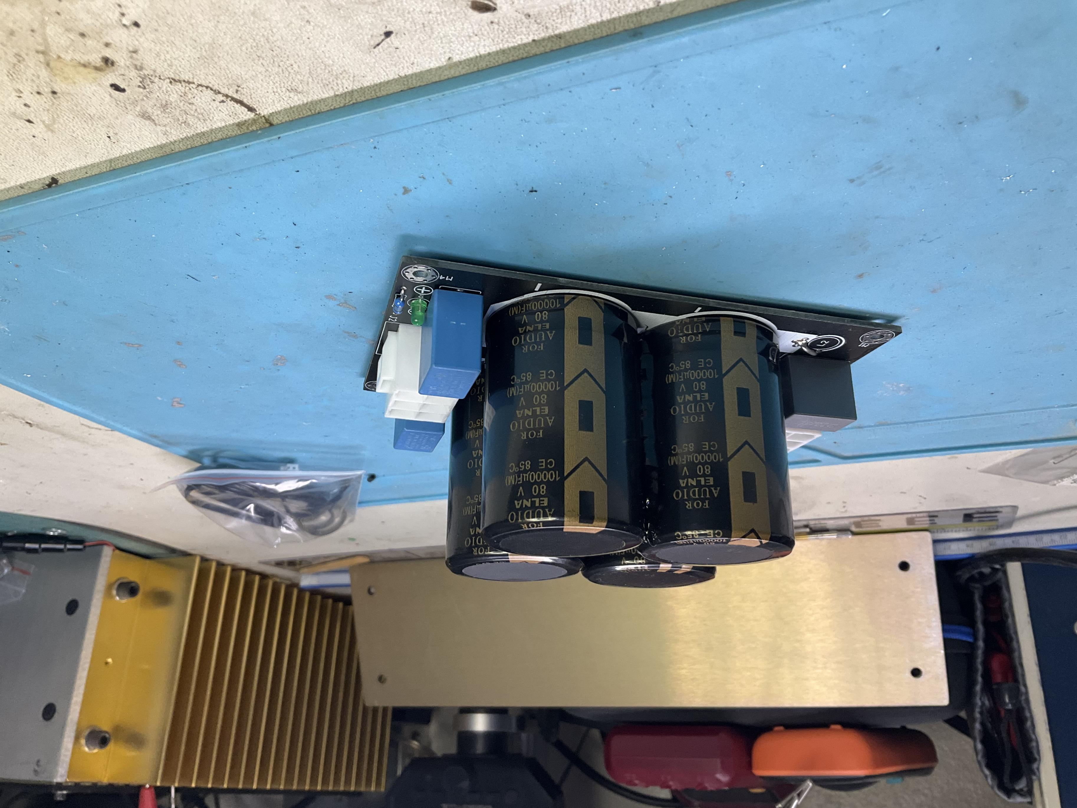

Just a heads up, I’ve been playing around with added capacitance at the output of the MicroAudio SMPS-CLA supply with my M2. After all my grounding scheme tips and tricks were exhausted, I was still hearing a faint hum right at the speaker. I checked for ripple with my Fluke and was surprised to see 117mV. I added 22,000mF per rail and the ripple dropped to 43mV. The hum volume decreased also. Next setup will be a CRC for each channel, knocking the ripple down even further will hopefully eliminate all audible hum ;)
The moral of my long winded story: leave yourself enough room inside the SissySit chassis for added capacitance.
Cheers!
Iyep 40x10 they look like toys, not sure how much air they will move but with the bottom open I will get a pretty fair amount of natural convection. I have 2 of these to go with the amp I will defiantly measure ripple to compare.
Bill

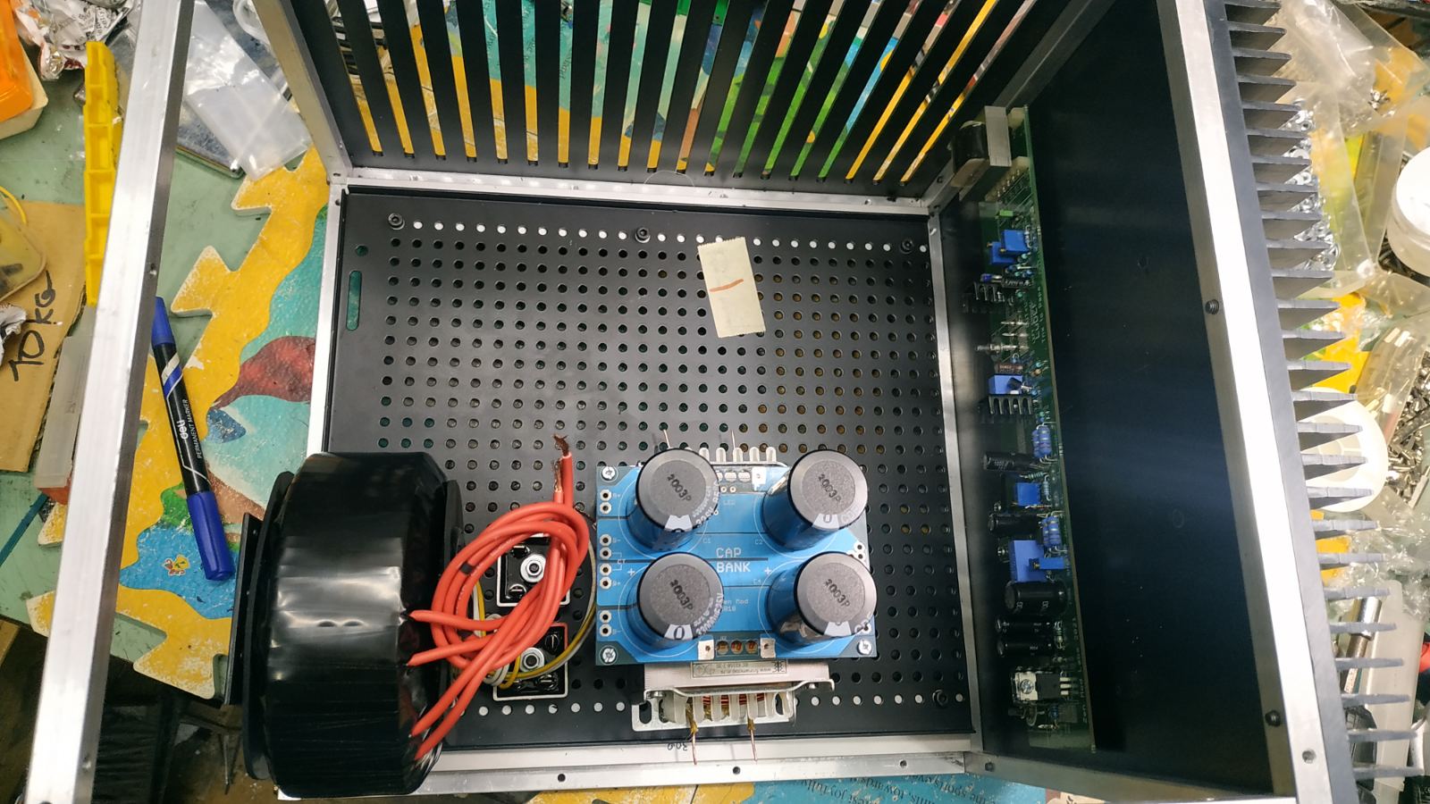

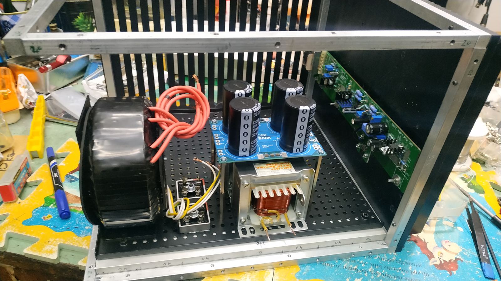

just few teasers, not best angle for pic, but clear enough
finally found some brain to arrange with (one of) my winder(s) to have custom chokes for my concoctions
4mH, 0R15Rdc, good for 4A with no sweat
will use that (CLC) instead of usual CRC (R being 0R1/5W)
caps are 33mF
if CRC was good, this one is going to be goodgood
