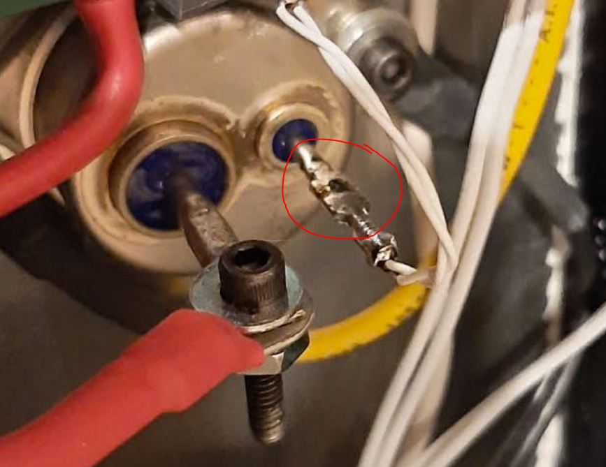

Offset issue still not solved
My offset instability is still not solved. After playing music for several hours yesterday, I found that the offset on the left side had again risen to 100-140 mV and was fluctuating.
Also, I tried Botte's suggestion this morning and added some solder to the gate connector of the SIT on the noisy side. Alas, no dice unfortunately, noise (like tube rush) is still there.
I guess I should try a different SIT next.
After that, if that doesn't help, I would take the amp board off the heat sink, and reflow all joints related to the gate drive of the IRF510, 9140 and SIT. I would also change the offset pot (P103) and the two gate Zeners (ZD104 and ZD105) when I have the amp board off, just as a precaution.
Sounds reasonable ?
Regards, Claas

well, fact that you have some shot noise and also mild DC offset issue - most logical explanation is misbehaving SIT
remember - DC offset is set in purely passive manner - there is no any trace of active correction of same and - taking that in account , DC Offset behavior of Sissy and similar amps is (now) rock solid
I'm writing that having on mind your other, well behaving, channel
and, yup, pretty much simplest and fastest way of further troubleshooting is changing SIT on that channel or - even better - exchanging them between channels
that way situation is clear from start - you're not introducing 3rd SIT with unknown nature
remark - if it stays that way , 150mV of DC offset is nothing to be worried of

Offset
Here’s an update on the first of two issues with the left side (R channel board) of my SissySIT R.3 – offset instability. Noise will follow in a separate post.
I changed in another SIT at the left side and adjusted R115 to 87R to accommodate its 2.62V measured Vgs. I know that I was supposed to exchange SITs between channels, but hoped to get away with only one SIT change, in case this worked already. 😛
At first, no change – offset instability still crept in after a few hours. I then snipped out the 1 nF across C-E of T101 and re-adjusted offset so that it stays slightly negative or gets single-digit positive at max. Offset seems to be stable now even after many hours of operation, several cycles, variations of rail voltages, and also after disturbances by, for example, switching off the pre-amp.
So I will continue to watch the offset of the left side, but don’t feel the need to act on the offset at the moment.
