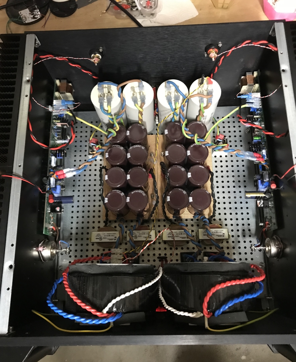

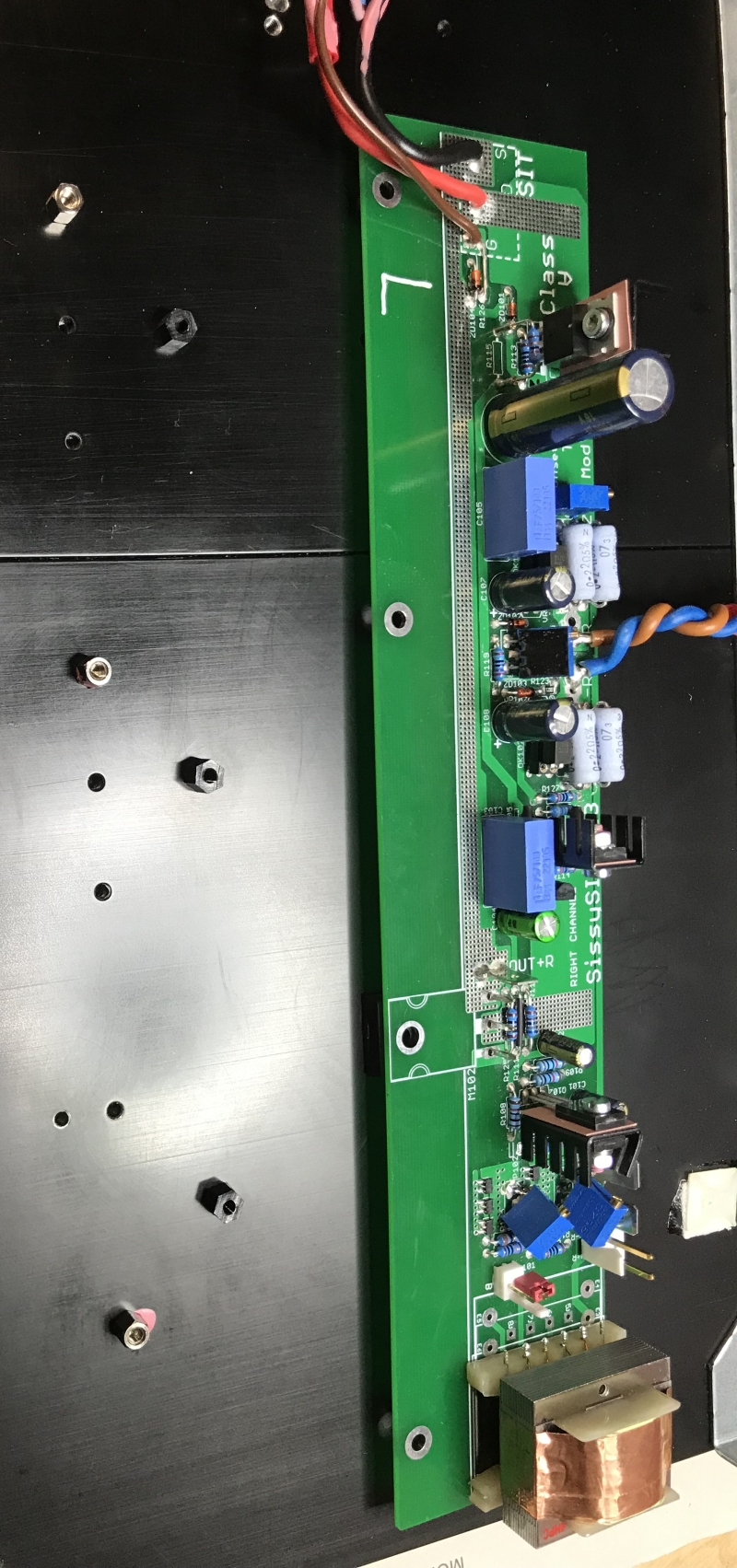

I collected the parts from being anodised and have started assembling my SissySIT, starting with the power supplies.
The rear U channel is now bolted onto the heatsink with some heat transfer goop between the parts. Toroid is in place on the U channel and I've started to hook up the cap bank boards. For the CRC resstors I've got these;
they're exactly the same height as the cap bank stand-offs so I'll solder them under the boards and put a little goop so the U channel will act as a heatsink for them.
Anyway, some general views of the ongoing build;

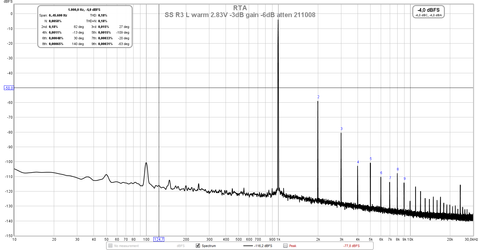

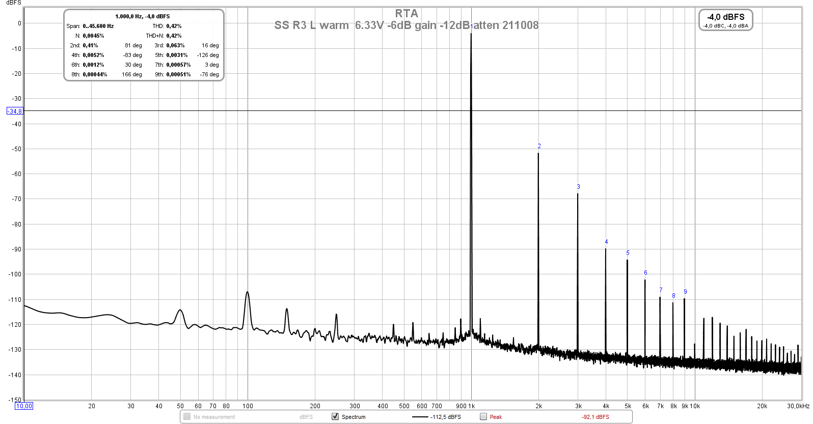

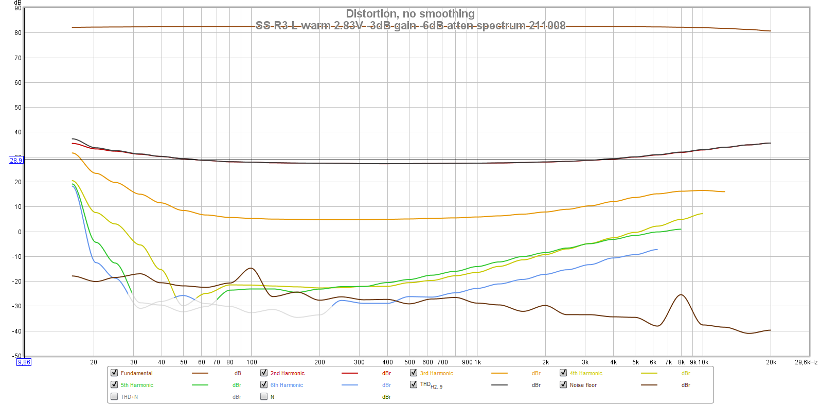

I finished my SissySIT R.3 boards a while ago and had been testing and adjusting them. With one of the boards I ran into an issue that took me quite a while to isolate and characterize.
But first, the positive facts:
- Bias is stable and solid. Does not vary with temperature variation or rail voltage fluctuations.
- Offset is stable and rock-solid against rail voltage variations
- Offset still varies somewhat with temperature. It starts out at -300 mV, moves above -100 mV within a few minutes, and then with warming up zeroes in. Once at equilibrium temperature, it’s nice and stable within a few mV.
Everything looks good on the scope, sine and square waves. Upper -3dB point is about 37 kHz on the right channel, about 33 kHz on the left, which is a bit higher than on my original SissySIT. Lower bandwidth extends to well below 10 Hz – looking very good there.
Distortion spectra basically look the same as with the original SissySIT.
Now comes the mysterious part:
The left channel (using the R board, in my case, because I mounted them inverted) can come into a condition of offset instability. This is characterized by offset rising quickly by about + 100mV, and then fluctuating by a few 10s of mV.
On the scope, the signals look as clean as before, and I haven’t found signs of oscillation.
DMM may show a higher AC noise at the outputs, but my DMMs are not really usable at such low voltages (going from below 100 uV to fluctuating at a few 100 uV).
In the distortion measurements, the spectrum looks a before, with maybe some more noise, but that could come from reduced averaging time. Because about once a minute or so, there seems to be a burst of something that might very briefly overload the input of the Focusrite 2i2 or REW’s -3dB limit, and REW starts averaging anew.
Bias is rock-solid through all this, totally unaffected from the altered offset or the fluctuations.
Current through the level shifter resistor R115, and therefore through the CCS and the IRF510, is absolutely stable and unaffected as well.
The interesting point is what starts this left channel-only condition:
A ) temperature – when the amp reaches its heatsink operating temperature (slightly below 50 degrees C), the upwards offset movement and fluctuations started.
B) I can trigger and manipulate the offset and its instability by touching the washer of the IRFP9140 with my finger (washer is grounded through heatsink …) or by gripping the PSU wires (+, -, gnd)
Once the instability starts, its there, I can’t end it by finger touch. However, switching the amp off and on again after a few minutes has it in its stable working point again.
I’ve since done some measurements, confirmed that the CCS and level shifter don’t move in value and stay stable. Touching the IRF510 does nothing.
I’ve changed the 9140, because the one I had in before was rescued from my original SissySIT boards, and maybe got damaged in de- and re-soldering.
Now, the instability has not been triggered by temperature – even with the heat sinks hotter than before. However, I can still trigger and manipulate it by touching the washer of the 9140.
I’ve looked over the solder joints, but the fact that the bias is rock-solid and the current through the level shifter resistor as well doesn’t leave many locations … and that fact that it can be triggered and altered by finger touch at a grounded or isolated area …
Is this maybe borderline oscillation, that’s hard to pin down ? Should I just up the gate stopper of the 9140 from 100R to 150R or 220R ? I only have 33kHz bandwidth now, but I guess that’s limited by the SIT and not by the 9140.
I wanted to experiment more before posting here by touching not with my finger, but a chopstick, and by measuring the gate current of the SIT, but I am sick and can’t spend time in the workshop at the moment.
Interested in your ideas on this,
