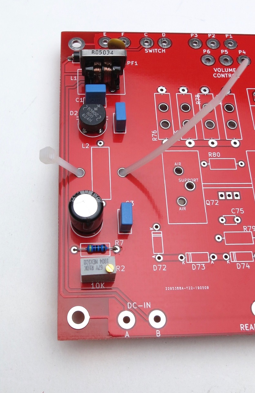

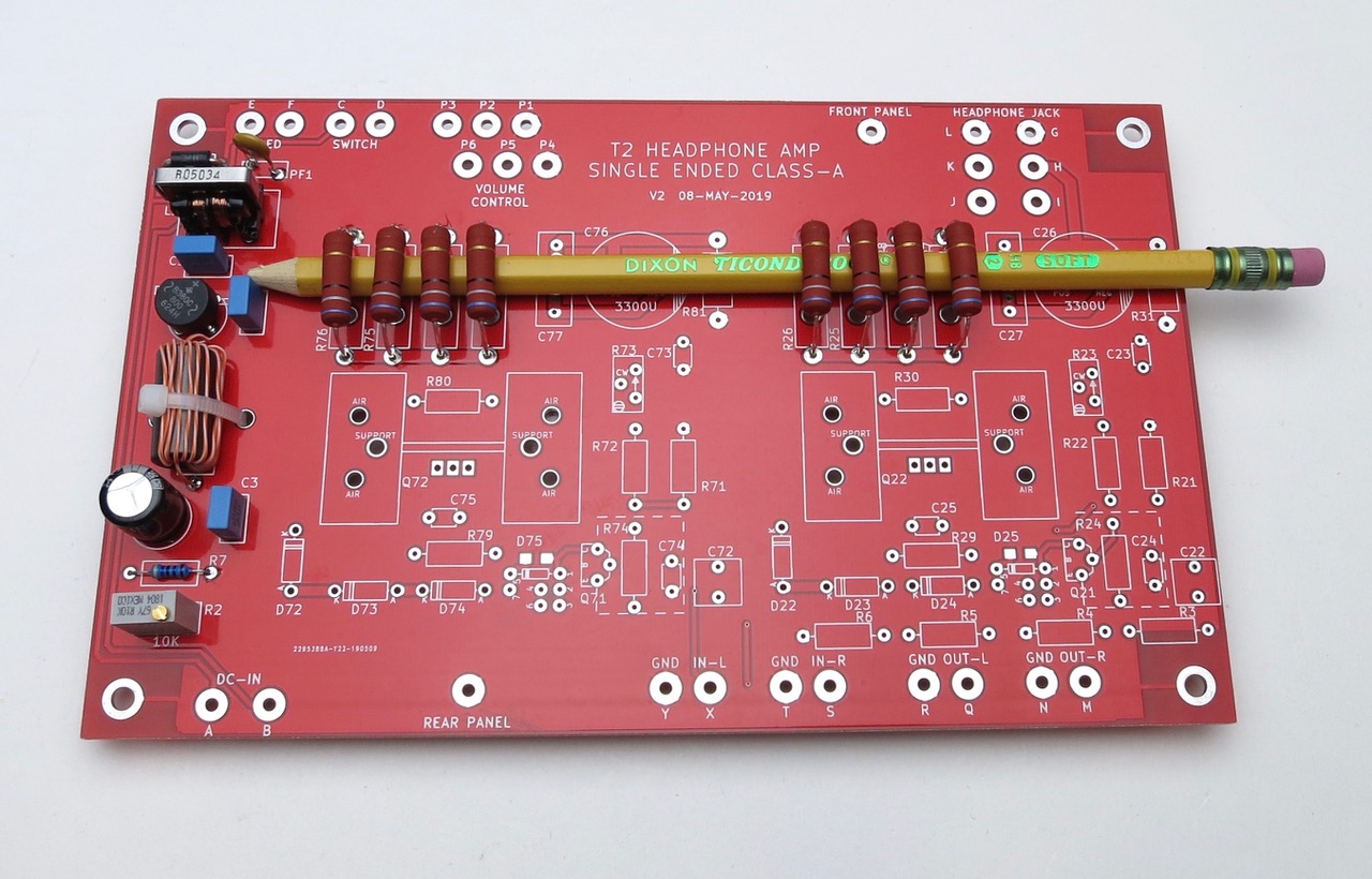

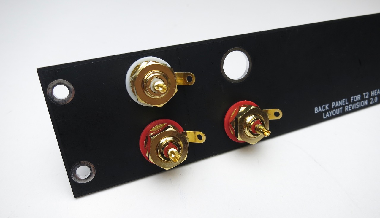

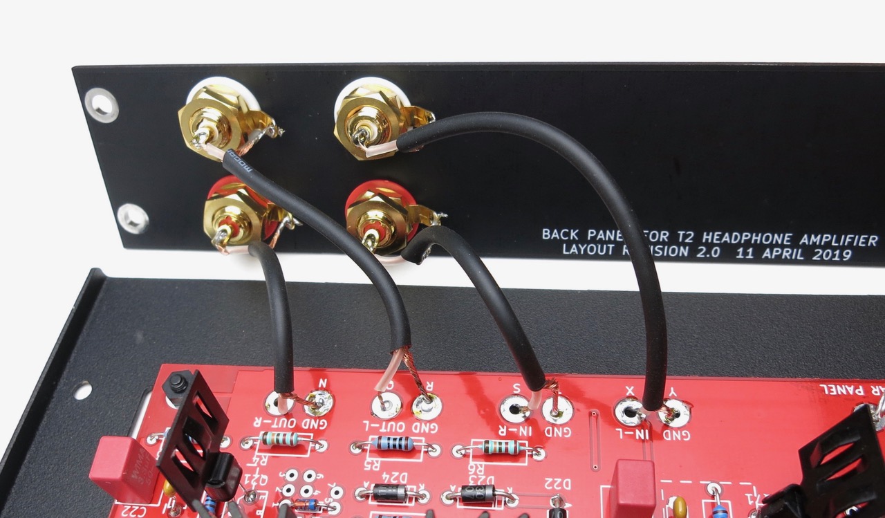

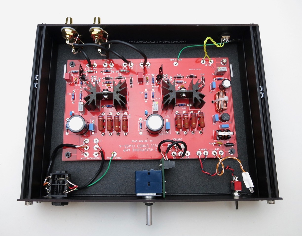

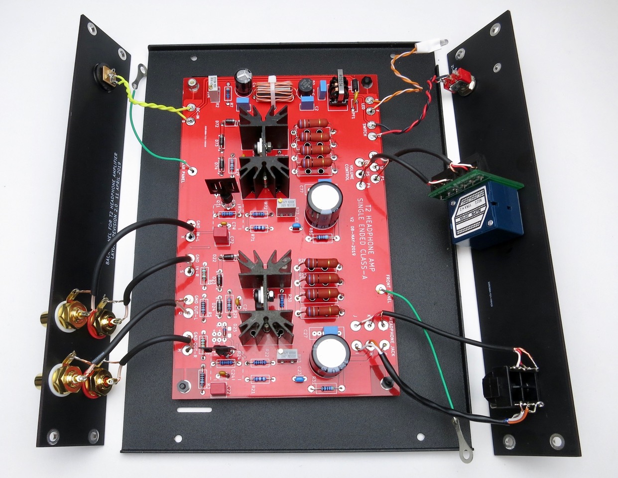

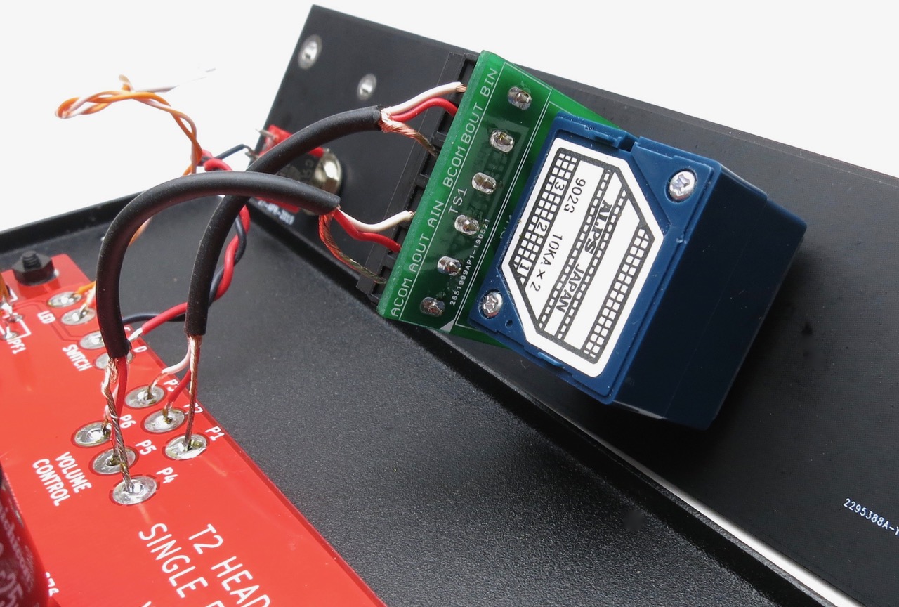

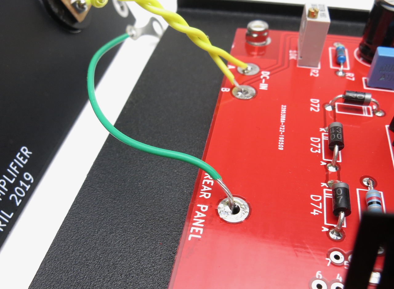

Single ended class-A headphone amp using two transistors: T2
Some photos of my build
762476d1560355601-single-class-headphone-amp-using-transistors-t2-img_2419-jpeg

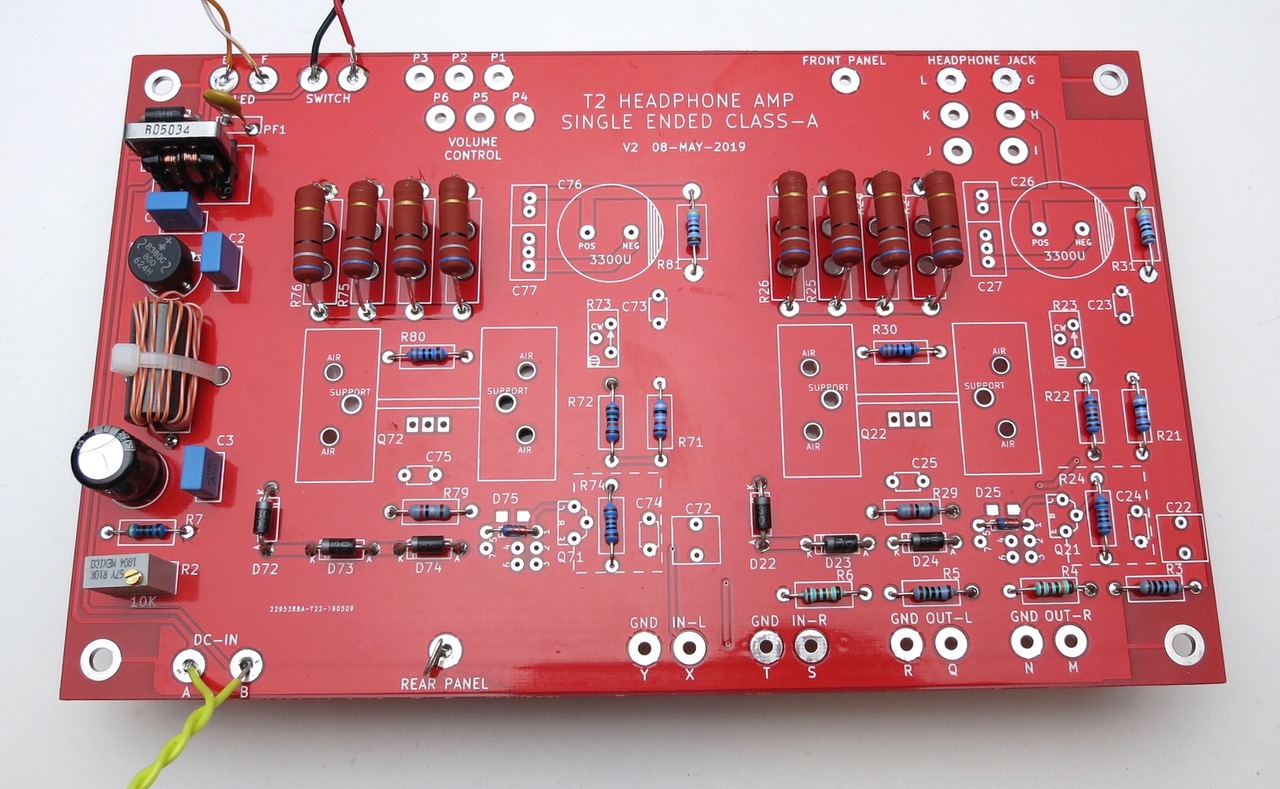

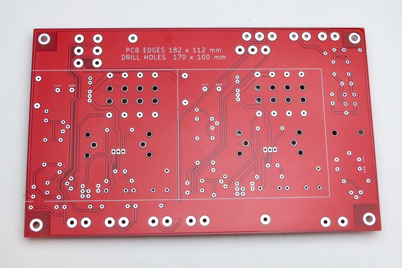

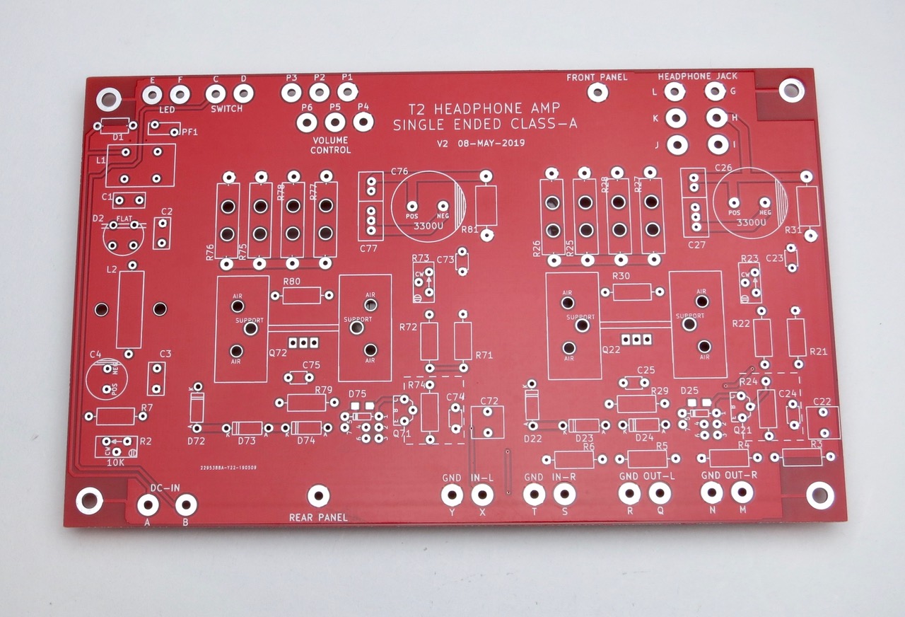

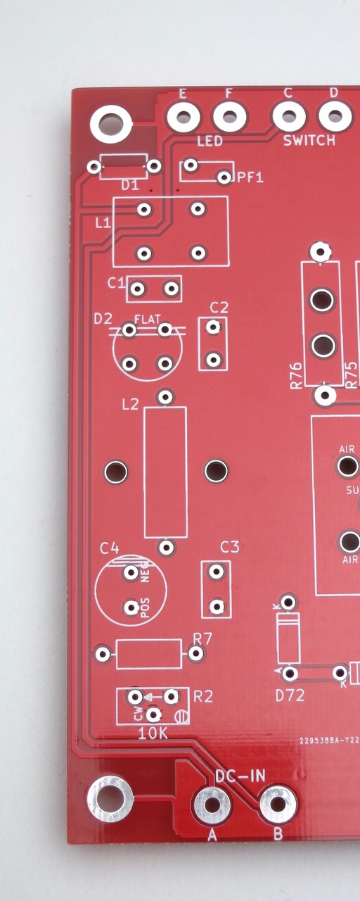

Top view PCB
762477d1560355601-single-class-headphone-amp-using-transistors-t2-img_2420-jpeg
Back view PCB
762478d1560355601-single-class-headphone-amp-using-transistors-t2-img_2421-jpeg
PSU section of PCB

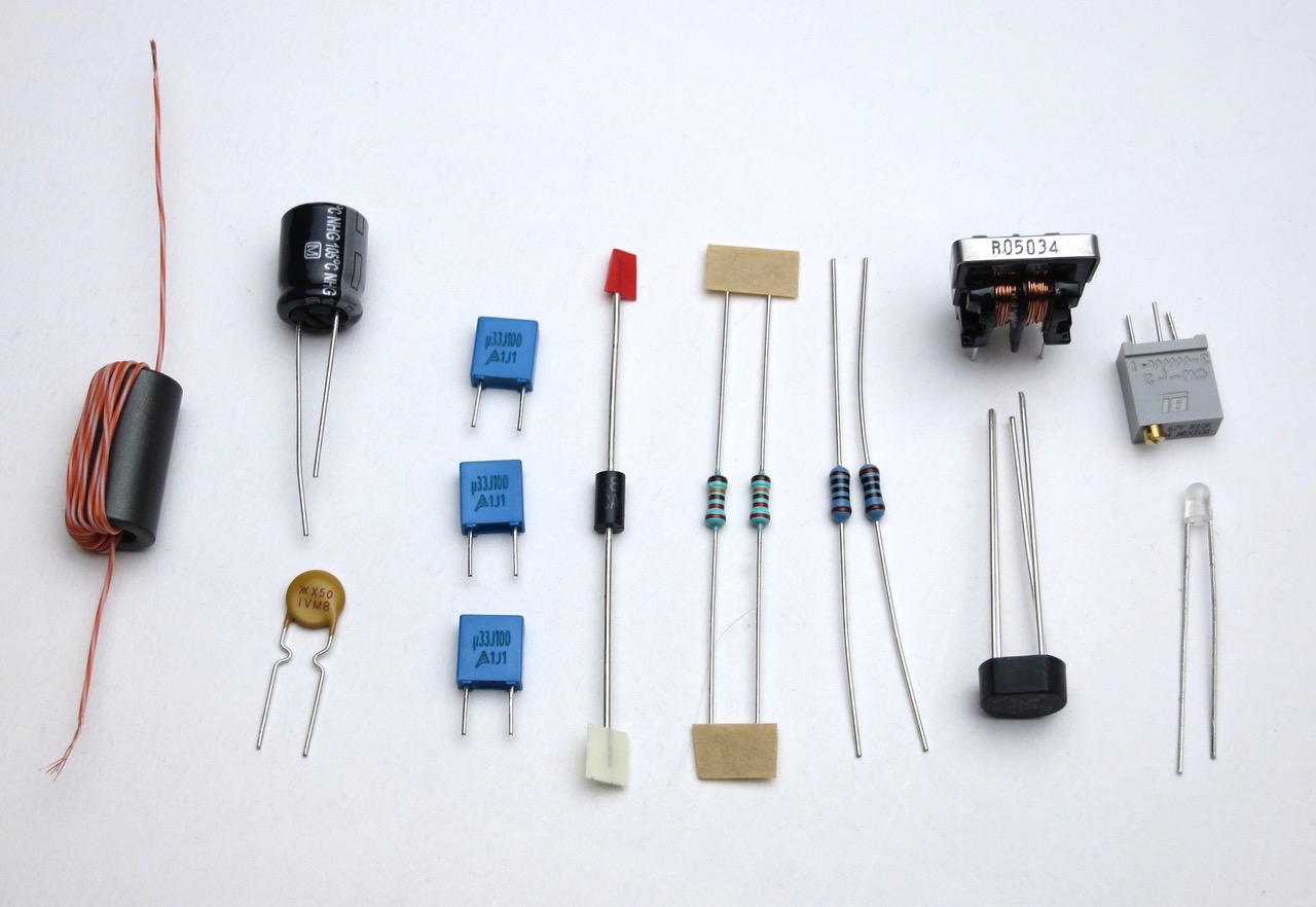

762479d1560355601-single-class-headphone-amp-using-transistors-t2-img_2422-jpeg
PSU components
762480d1560355601-single-class-headphone-amp-using-transistors-t2-img_2423-jpeg

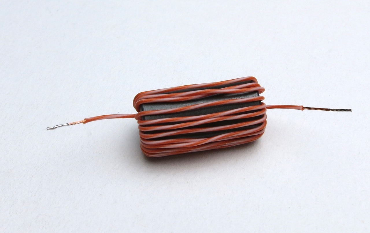

762481d1560355601-single-class-headphone-amp-using-transistors-t2-img_2424-jpeg

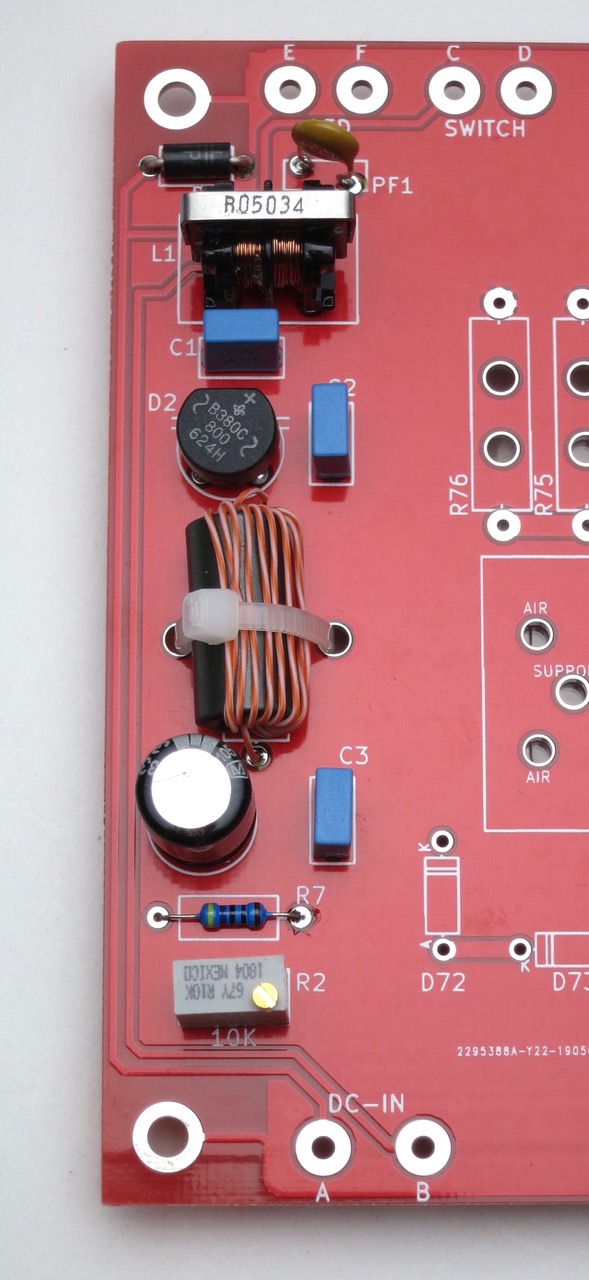

Ferrite core with wire installed
762482d1560355601-single-class-headphone-amp-using-transistors-t2-img_2426-jpeg
PSU section stuffed

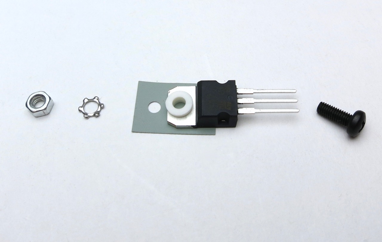

762483d1560355601-single-class-headphone-amp-using-transistors-t2-img_2427-jpeg

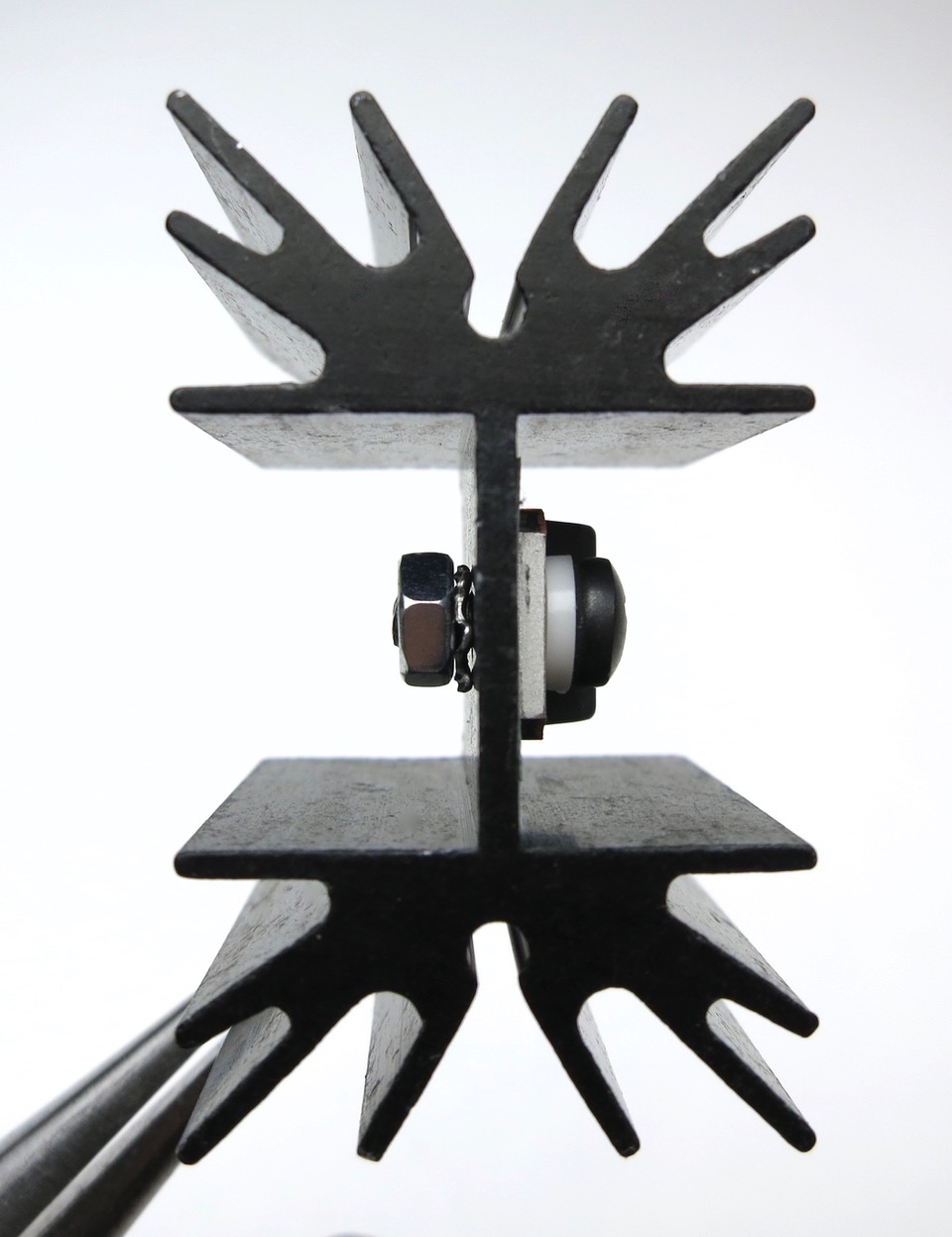

Custom tool for raising the power resistors.
762484d1560355601-single-class-headphone-amp-using-transistors-t2-img_2428-jpeg

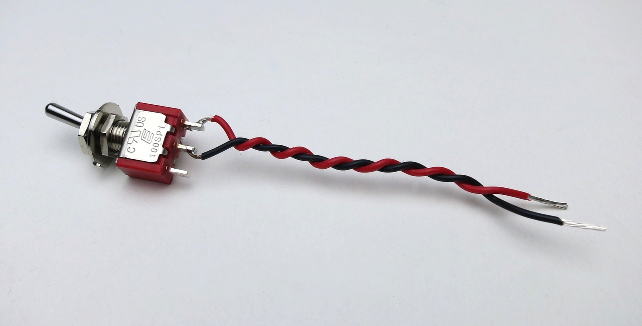

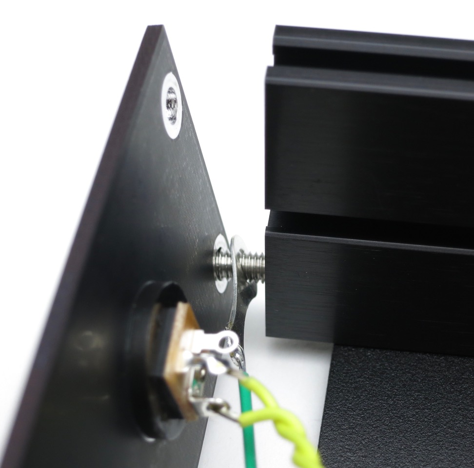

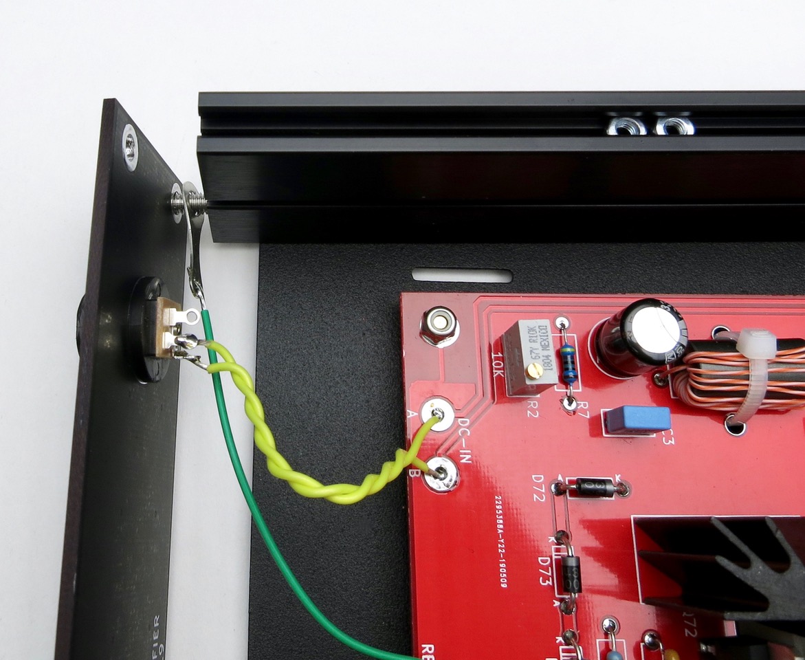

Power switch
762485d1560355601-single-class-headphone-amp-using-transistors-t2-img_2429-jpeg

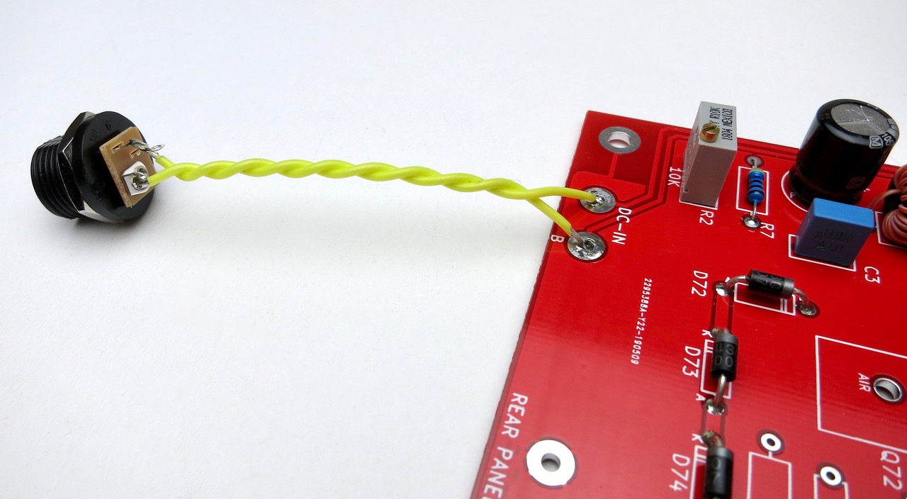

DC power jack

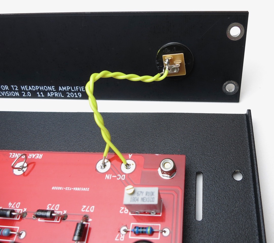

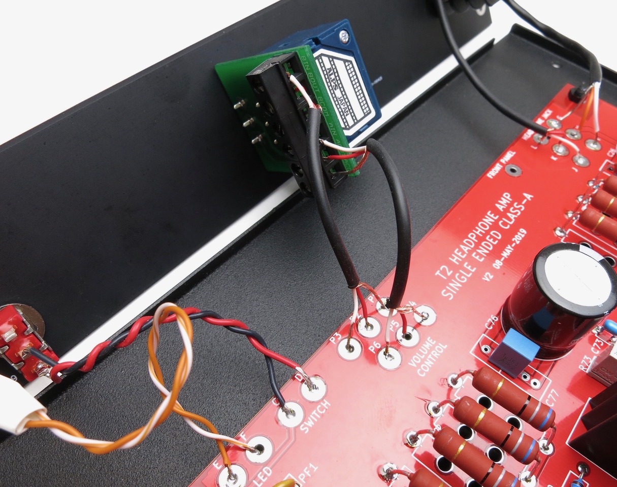

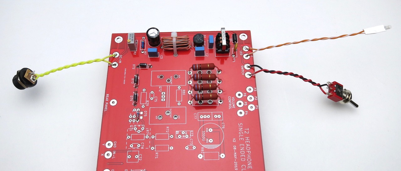

Continued
attachment.php

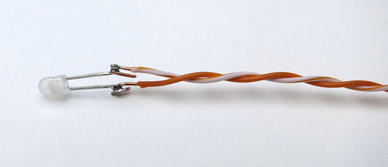

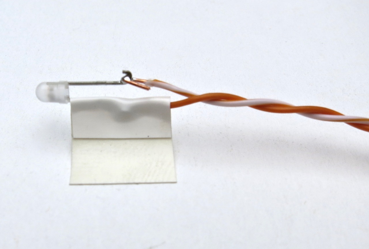

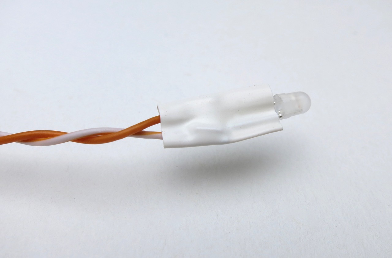

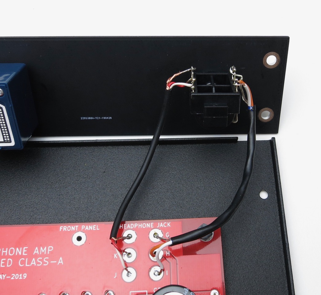

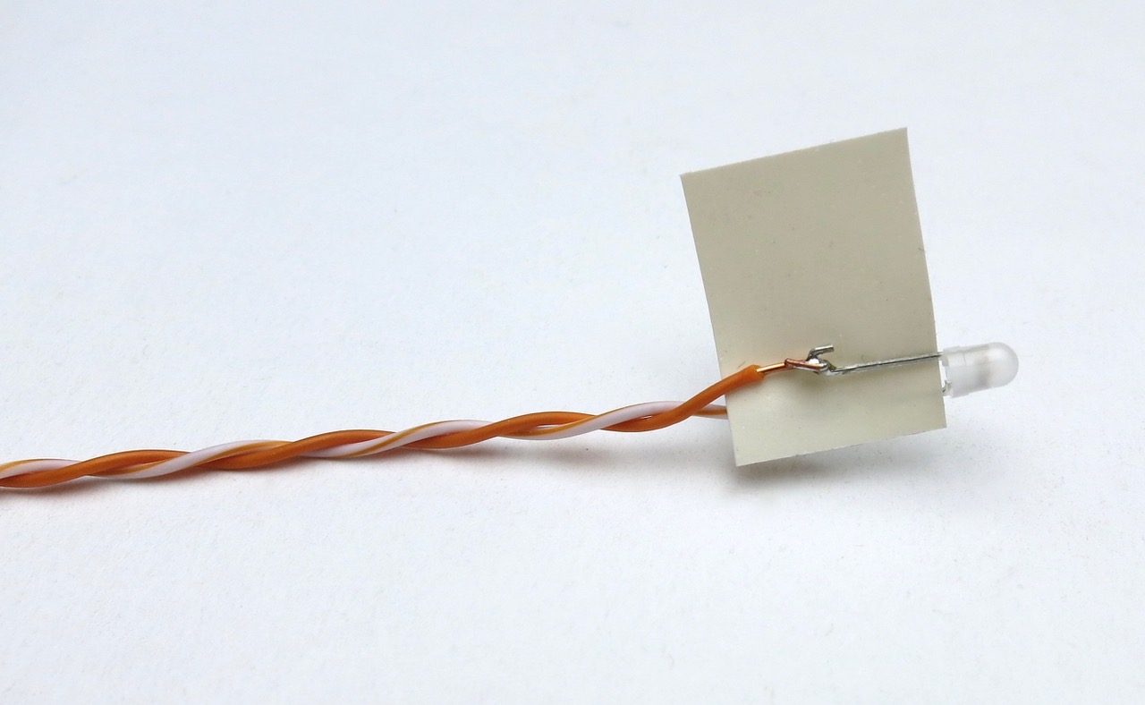

LED wiring
attachment.php
attachment.php
attachment.php
attachment.php

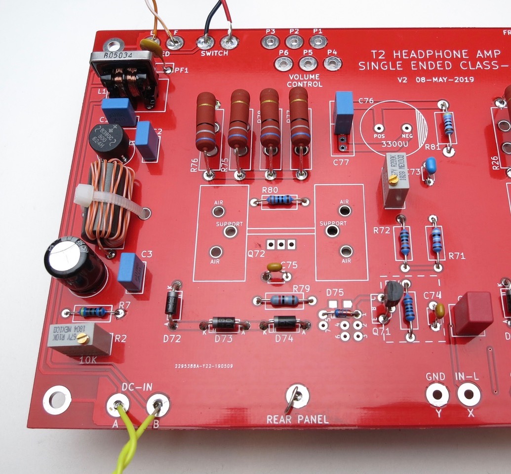

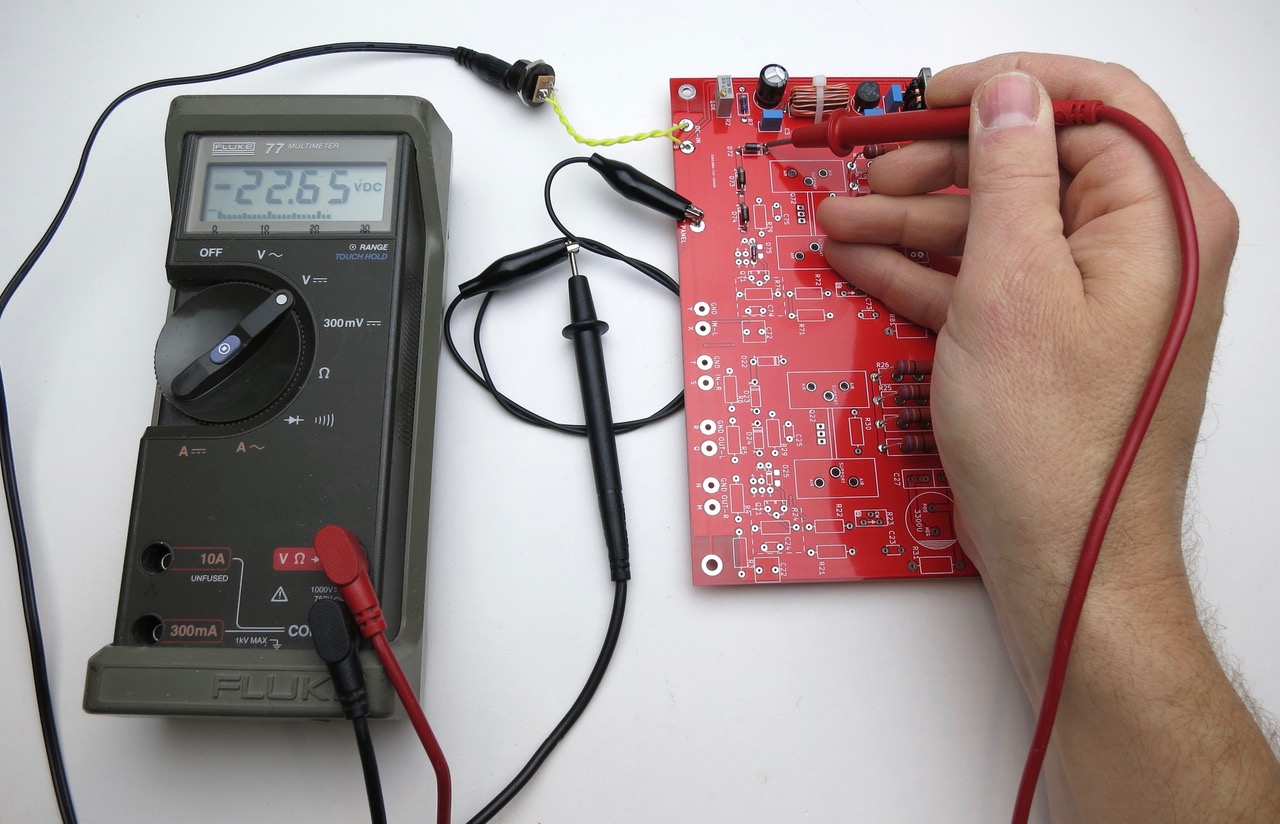

Board ready to test PSU section
attachment.php
Attach black to the panel ground point, read DC volts at cathode of D72. Proper reading will be -22 to -23VDC. Remember that the PSU is "upside down" in this project.

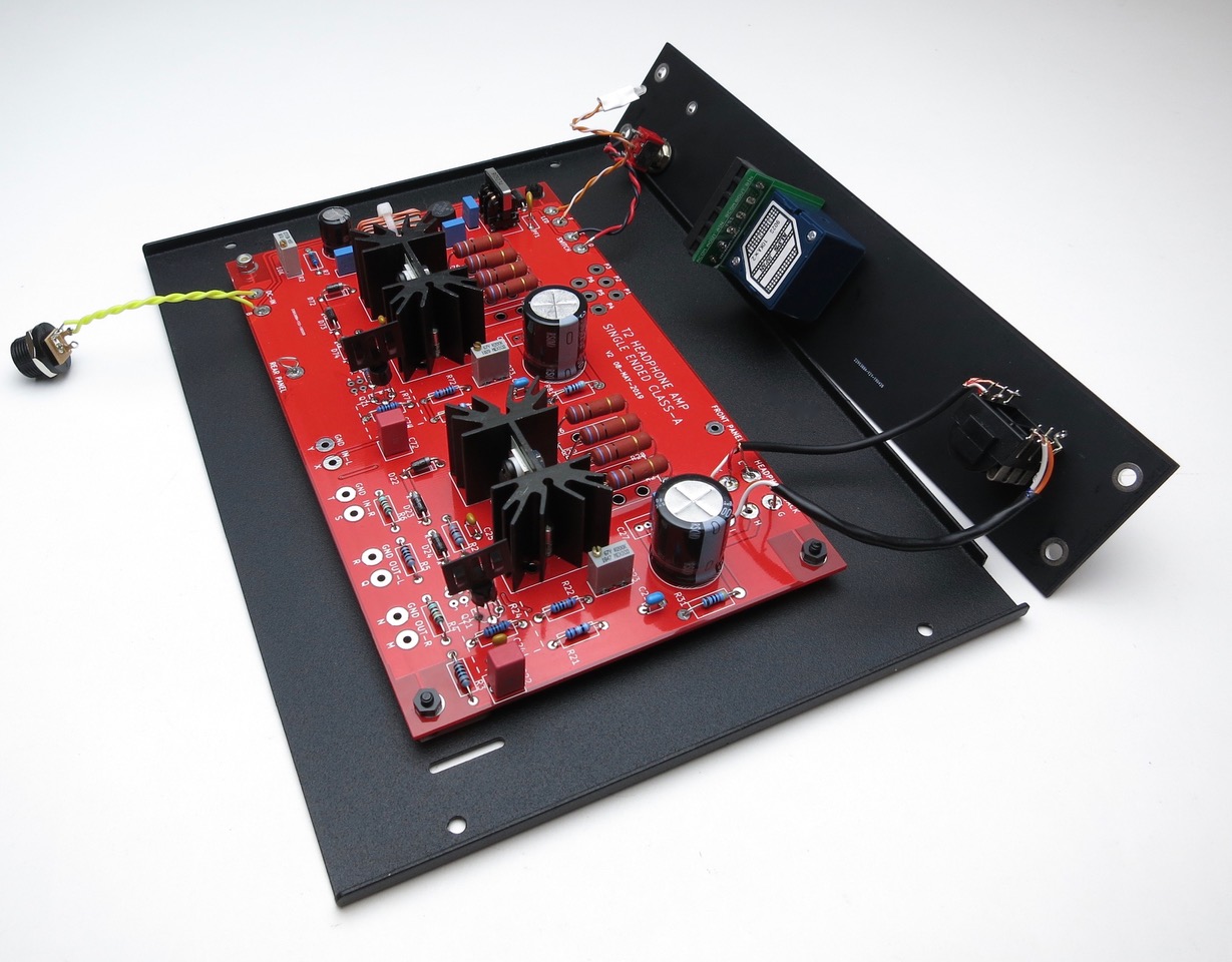

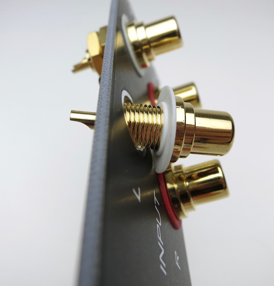

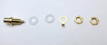

Standoff [specified in the T2 bill of materials] is M3, metric. I plan to use 4-40 standoffs because I have lots of 4-40 hardware around, but very little metric.
Sure, that'll work. One shade tree mechanic's trick for synthesizing a standoff, is simply to stack two or three 4-40 hex nuts instead. Now the distance between the PCB bottom surface and the chassis floor, equals the thickness of two or three hex nuts. Crude but effective and, thanks to the PCB overhead, invisible.
The diyAudio Universal Mounting Specification (link), used for lots of First Watt Nelson Pass power amps in the diyAudio store, has metric M3 tapped holes for board and transistor mounting on the heatsinks. So if you're thinking of doing a power amp one of these days, it might be a good investment to get an M3 bolt and nut assortment from Amazon or elsewhere. These will go into your T2 headphone amp build and they'll also go into your First Watt / diyAudio store power amp.
Sutemribor 320Pcs M3 Stainless Steel Button Head Hex Socket Head Cap Bolts Screws Nuts Assortment Kit + Wrench - - Amazon.com
Amazon.com: VIGRUE 810Pcs M3 Screw Assortment Kit 304 Stainless Steel Phillips Pan Head Machine Screws Bolts Nuts Lock Flat Washers with Storage Box: Home Improvement
You may also decide you want to replace the M4 bolts which come with the 1U Galaxy chassis, and use either black oxide or stainless steel socket cap M4 screws as mentioned in post #44. Both of the Beta Testers chose stainless steel, member adydula chose black oxide.

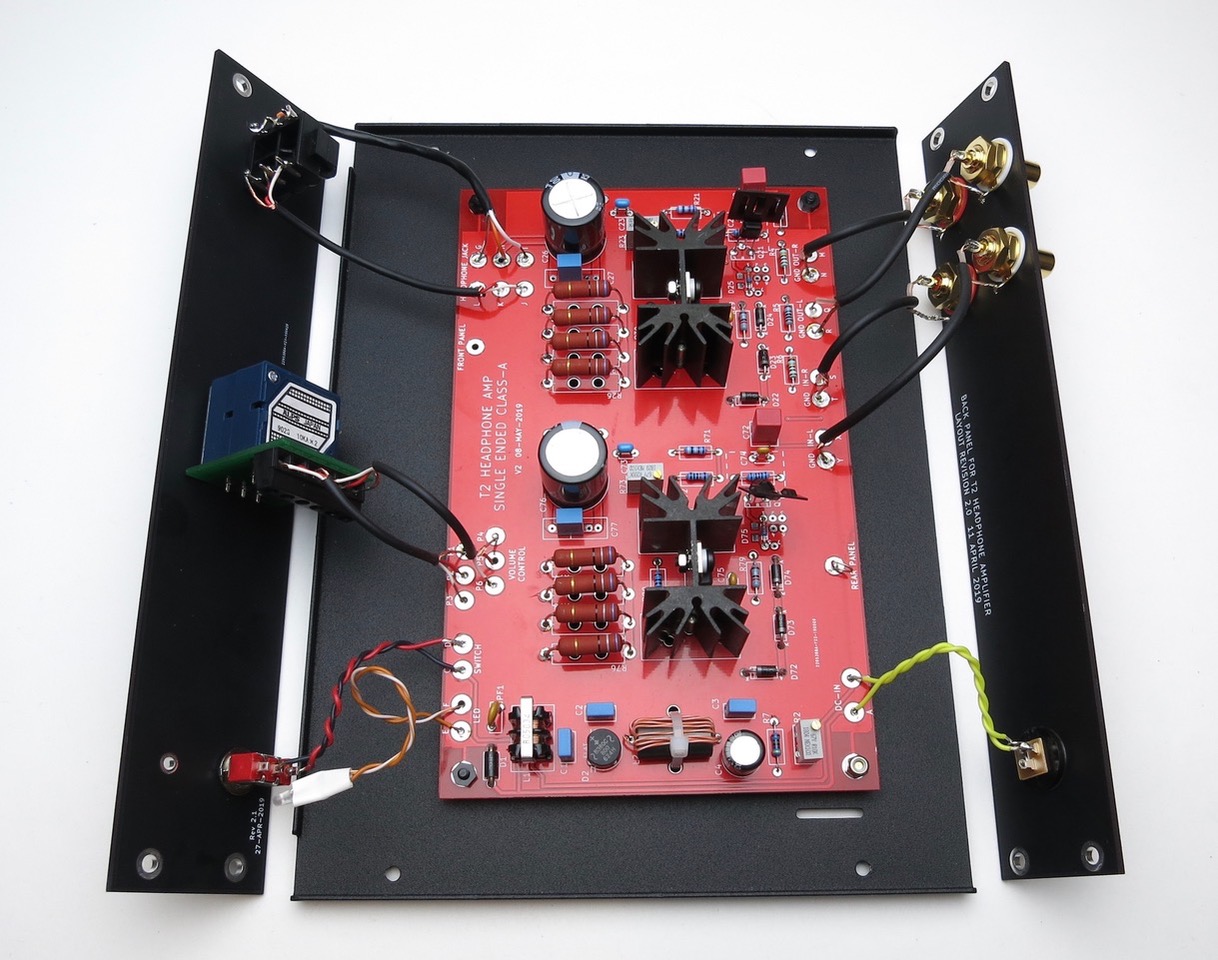

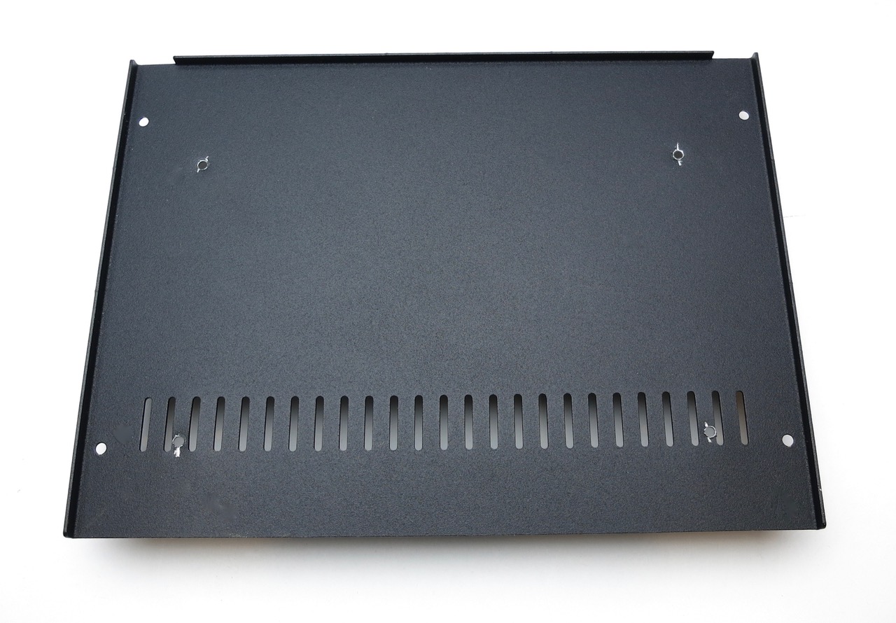

Building continued

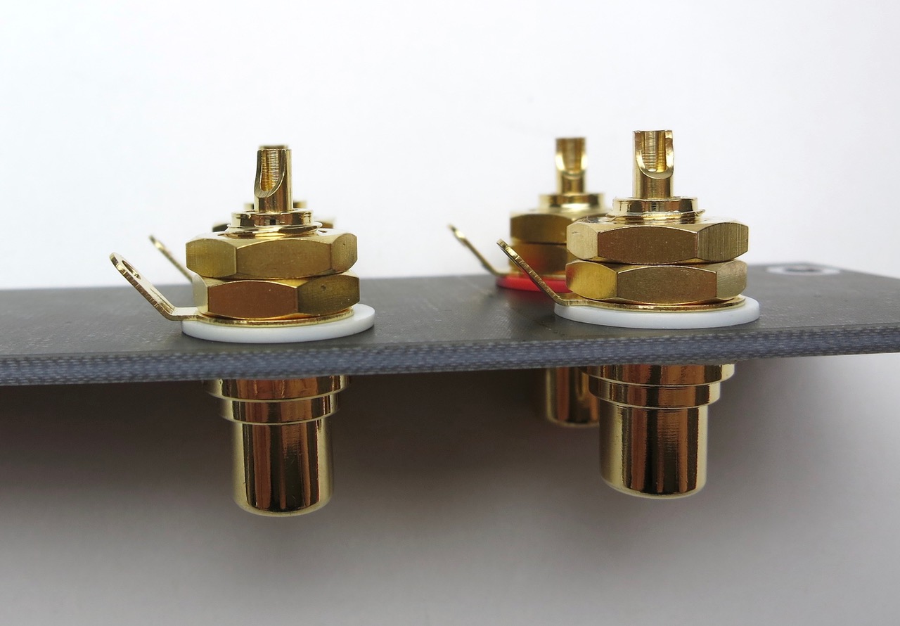

T2 continued

Thanks, I've used the nut for standoff trick in the past, but I have a number of standoffs now, and Frys is down the street from work and they stock some standoffs.
I'm sticking with English units for now, will worry about m3 if I build a pass amp kit that uses m3. Didn't know it was the standard.
Pretty sure I can pick up some M4 bolts at the local big box store, will need to see what they have. There is also an independent HW store by work here that I like to support, and they have a pretty good assortment of nuts and bolts. Unfortunately, good HW stores are harder to find these days.

If the number of turns is 8 or 9 or 10 or 11 or 12, you'll be fine. Don't be scared, use whatever wire you've got. 26 AWG solid core insulated "telephone wire" would be fine. Grab some wire, wind it on the core, and find out how many turns you're able to get. It might be adequate and plenty.
Post #60 shows the CAT-6 ethernet cable that I bought from amazon, then cut open to harvest the 28-AWG stranded wires used in my build of T2, and also used in both Beta Testers' T2 builds.
One builder told me he purchased "magnet wire" (wire whose insulation is an enamel coating) in 28-AWG, something resembling this. It is difficult to strip off enamel insulation, his plan is to use a chemical etch. Owww!
