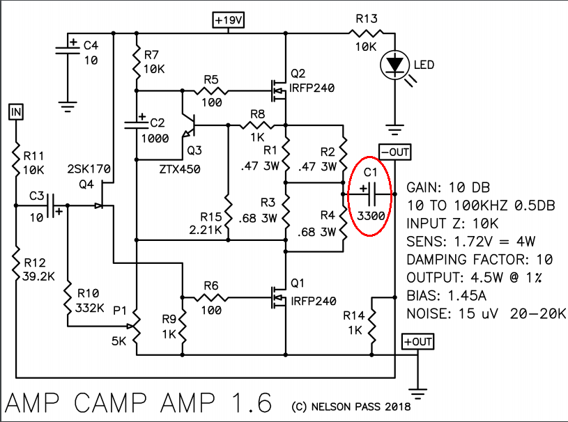

Single ended class-A headphone amp using two transistors: T2

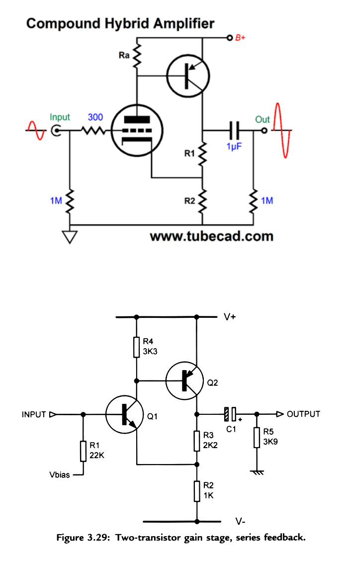

Hi wrenchone, I remember writing post #38 in your thread. After you decided not to pursue it, I did. That's when I began looking for previous 2-transistor amplifier designs, and found a great many of them, including the ones I attached to post #1 here (copied below). You are right, the 2T amplifier topology did not originate in 2018 or 2019, it is much, much older. Turning it upside down to use an NMOS output xitor with a positive ground is a slightly new wrinkle. Frequency compensation at the 2nd stage, including cancellation of the right halfplane zero, seems to be another.

Why would anyone want to design/construct an amplifier that uses a big ole' nasty 3300uF output coupling capacitor??😕
Well, you certainly wouldn't want to ever listen to this -- 😀
Or this -
6moons audio reviews: FirstWatt SIT-1
Or heavens above, perhaps measure the cap and see what horrible, evil, and just un-civilized distortions it imparts -
SYclotron Audio | Why are people obsessed with coupling caps?
SYclotron Audio | Capacitor Obsessions- The Zombie Awakes (edited to add data 2/21/18) (The intermodulation measurements are particularly interesting...)

Hmmm, if you want a Do It Yourself headphone amp project that's DC coupled from input to output, with zero capacitors anywhere in the signal path, unfortunately that means both of the DiyAudio Store headphone amp DIY projects are disqualified. WHAMMY has an AC coupled input, and Starving Student II has an AC coupled output.
I think the "Butte" DIY headphone amp does meet your requirements, it has direct coupled input and direct coupled output. Bare PCBs available so DIYers don't have to lay out a circuit board themselves. Google will help you find it.
The O2 / Objective2 DIY headphone amp is disqualified, and so is the original CMOY "headphone amp in an Altoids tin". Most headphone amp projects seem to have at least one capacitor in the signal path! T2, in this thread, has two.
Good luck with your DIY projects!
Oh, I can name a few which are DC coupled through the signal path.
Where should we start ?
Let's name a few which are not mine :
https://www.diyaudio.com/forums/hea...borberly-eb602-200-revisited.html#post5492307
https://www.diyaudio.com/forums/hea...ley-hood-headphone-amplifier.html#post5402030
The Pioneer Super Linear Circuit
None DIYA links :
the Headphone amplifier
The Cavalli-Kan Kumisa III stereo headphone amplifier
And a couple of my own :
The DAO SE all-FET Class-A ZGF Headphone Amplifier
UTHAiM -- Just for Fun
Current Drive for Headphones & The Super Linear Transconductance Amplifier
A few of them have Gerber files or PCB layouts in the public domain.
Best,
Patrick

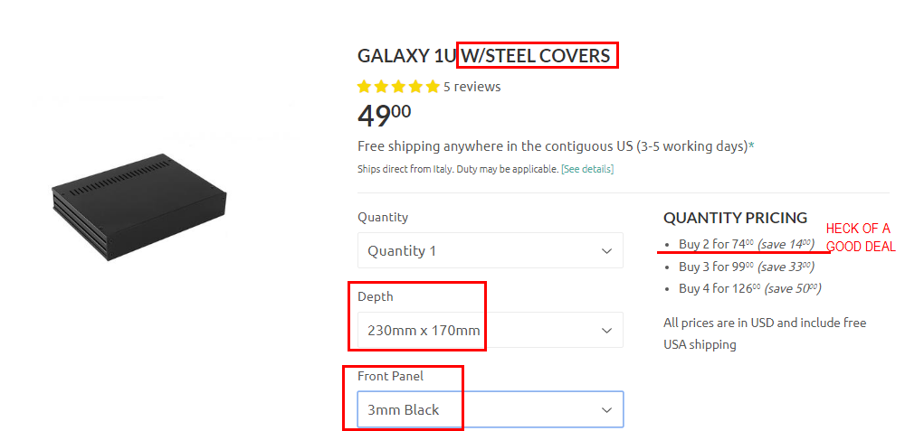

Hi Alex, I bought the Galaxy 1U chassis with steel covers, in the "230 x 170mm" size. I will try to make a LINK to that sales page on the diyAudio Store website.
The PCB for T2 is 182 x 112mm, so it fits comfortably in the 230 x 170 chassis, with adequate room for the ALPS Blue Velvet (RK27) volume control in front, and the Rean gold plated RCA jacks in back. Have a look at the build photos attached to posts #1-5 (still growing), it's not packed tight or cramped at all.
In case my web link doesn't work, I attach a screen capture image below. If you have any reason at all to buy two chassis instead of one, the discount is fairly dramatic.

You're absolutely 100% correct with your assumption...LOL.
I'll stick with DC-coupled designs any day of the week whether they're a op-amp based designs using the wonderful sounding LT-1363/64 or discrete designs such as those as offered from Schiit Audio.
Good luck with your AC-coupled design(s).🙄
Lol! DC voltage on source ---> straight through DC-coupled headamp ----> into expensive headphones ----> Amazon for new headphones. Good luck to you too, sir! 🙂 I would never design or use a headphone amplifier that didn't have a DC blocking capacitor somewhere in the signal chain (a DC servo won't react fast enough, either, to save the headphones). Like Mark's neat little design here 🙂
