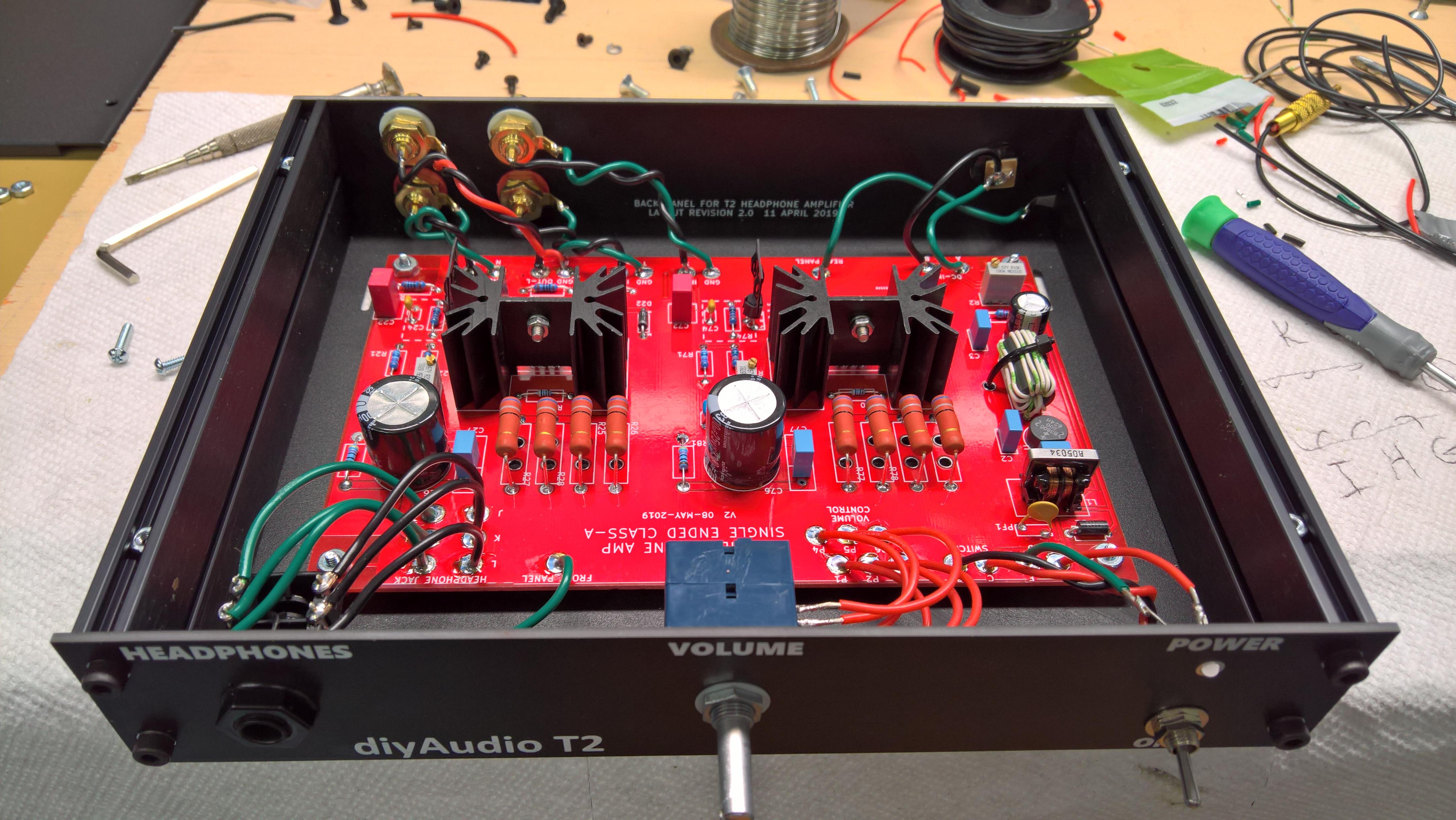

Had to do some DIY here....with the screws and mounting standoffs for the board. I found black 5-10mm allen cap bolts at LOWES 2 for 98 Cents! When I get a knob for this I will post a few more pix.
I am listening with the amp driven by a Schitt Bifrost Multibit dac....the sound is silly crazy good...I am gushing all over the place here its that good..

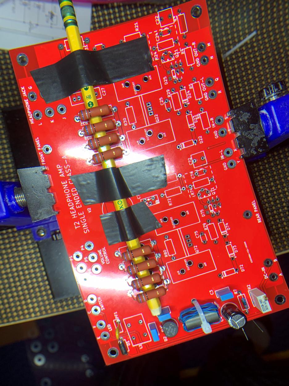

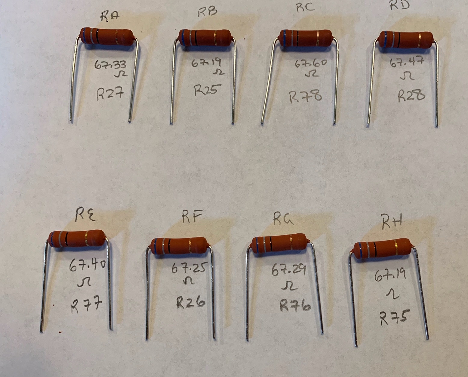

Also attached are a couple of photos that didn't seem to fit in earlier posts. One is the resistor elevator pencil trick as performed by Beta Tester #1. The other is a cropped picture showing one channel of T2 amplification. This picture emphasizes that T2 is a very simple circuit with very few parts.
edit- what about the third photo? Whazzat? It's an example of what you might see if you attempt unnecessary modification #2. I've never done this myself but Wildman the Beta Tester sure did.

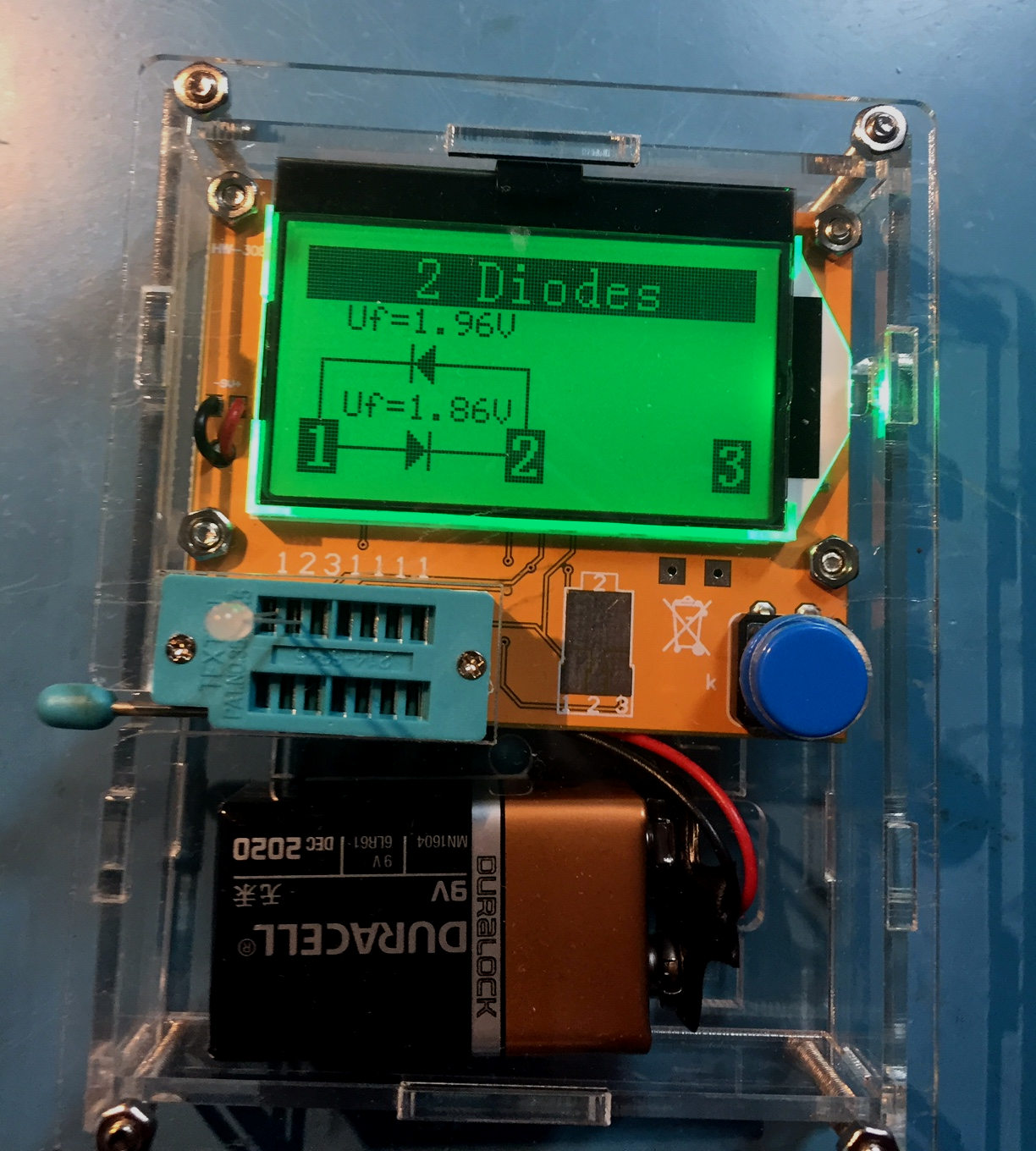

Builders may not notice at first glance, that the LED specified in the Mouser BOM and Mouser shopping cart (here it is) ...
is actually a bidirectional LED. Apply power one way and it glows yellow. Reverse it, connect power the other way and it glows green.
This means that the LED will glow when power is applied, no matter which way you hooked it up. You can't connect it "wrong" because it works either way.
Insert this LED into your Mega328 tester and run a test. Notice that it glows both colors during testing. Observe the cool and unusual output device schematic on the Mega328 screen. That's a whole lot of fun for only $0.36.

Here is the T2 front panel LED test result on a Mega328. It has correctly discovered that there are TWO light emitting diodes in the package.

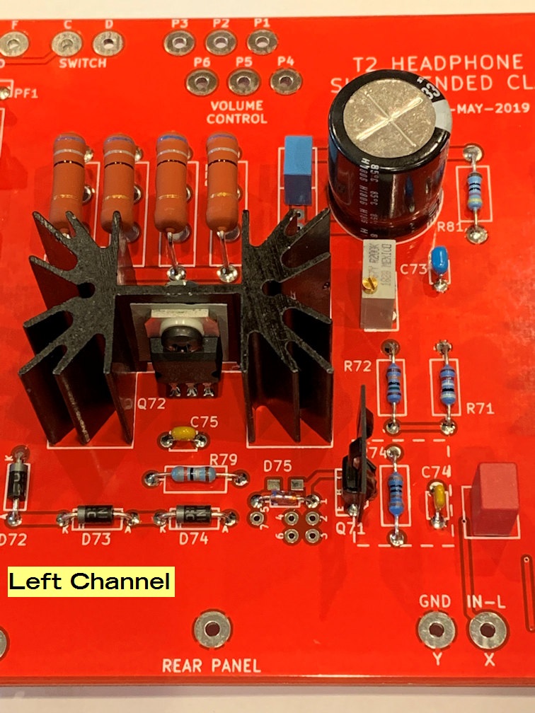

This is a nice amp design, and I am glad that folks are trying it as they will discover the wonderful world of simple SE ended Class A headphone amps that sounds so good. Just a couple of clarifications to reduce confusion by readers/builders of this amp who may go on trying to build this amp by looking at only the schematic. I was looking up P channel MOSFETs based on the schematic diagram symbol, but it's really an N-channel.
The schematic diagram shows a P-channel MOSFET, but the part number is an N-channel, and your description says N-channel. The arrow on the symbol should point into the die-pad, not away as shown. This is the second time one your schematics shows an incorrect symbol for an N-channel MOSFET, other time was in the M2X schematic here (both N and P channel symbols were flipped):
It would seem that your schematic software/sim software (KiCad?) might have the symbol notation reversed.
Here is what it should look like:

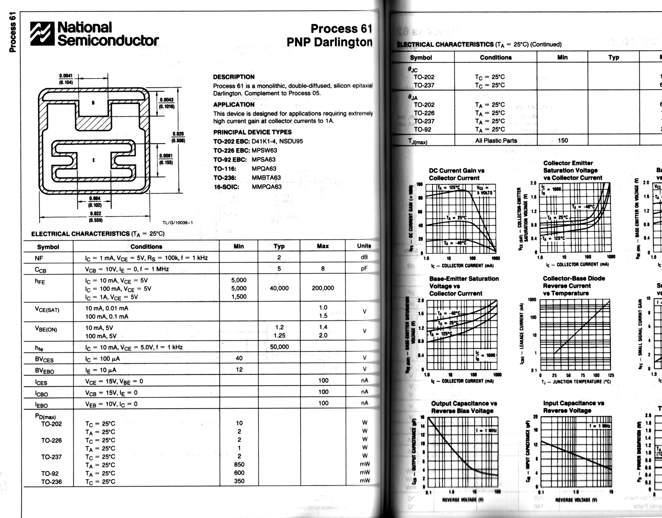

The semiconductor process description page calls the PNP input transistor a "monolithic" (all devices built in the same substrate) darlington, attachment below. You can see it has only two bondpads, one for base and one for emitter. The backside die attach (substrate) is the collector. The connections between the small input PNP and the large output PNP, are not made with bondwires spanning two separate die. They're monolithic.
I'm not too worried about builders accidentally purchasing and installing the wrong polarity MOSFET, since the circuit description in post#1 states the device polarity (N-channel) again and again, and it goes on to explain why N-channel was chosen, in detail. The MOSFET part number on the schematic, matches the part number on the Excel spreadsheet BOM in post#1, which also matches the part number in the shared Mouser shopping cart in post#5. They all say "STP16NF06" which is correct. It's an N-channel power MOSFET.
I've heard back from several builders who bought the whole Mouser shopping cart and successfully built a working T2 from those parts. The procedure is working smoothly, at least so far. Nobody has accidentally purchased a P-channel MOSFET that I'm aware of.
So I think I'll leave the schematics as they are, despite your concerns. Thanks for sharing your thoughts!

Some may not agree that the T2 circuit can be called a two transistor amplifier. For one thing, darlington "transistor" Q71 is, in reality, an integrated circuit with two transistors on the same die. And for another, it feels like cheating to call D75 a diode and not a transistor. Even though D75 has only two terminals, even though it cannot provide voltage gain, current gain, or power gain, D75 just seems like it needs to be called a transistor. To those who feel this way, I gently reply: you may be right. However I really like the name T2 and I plan to keep using it. Feel free to call it by another name (T2++ ??) if you prefer.
