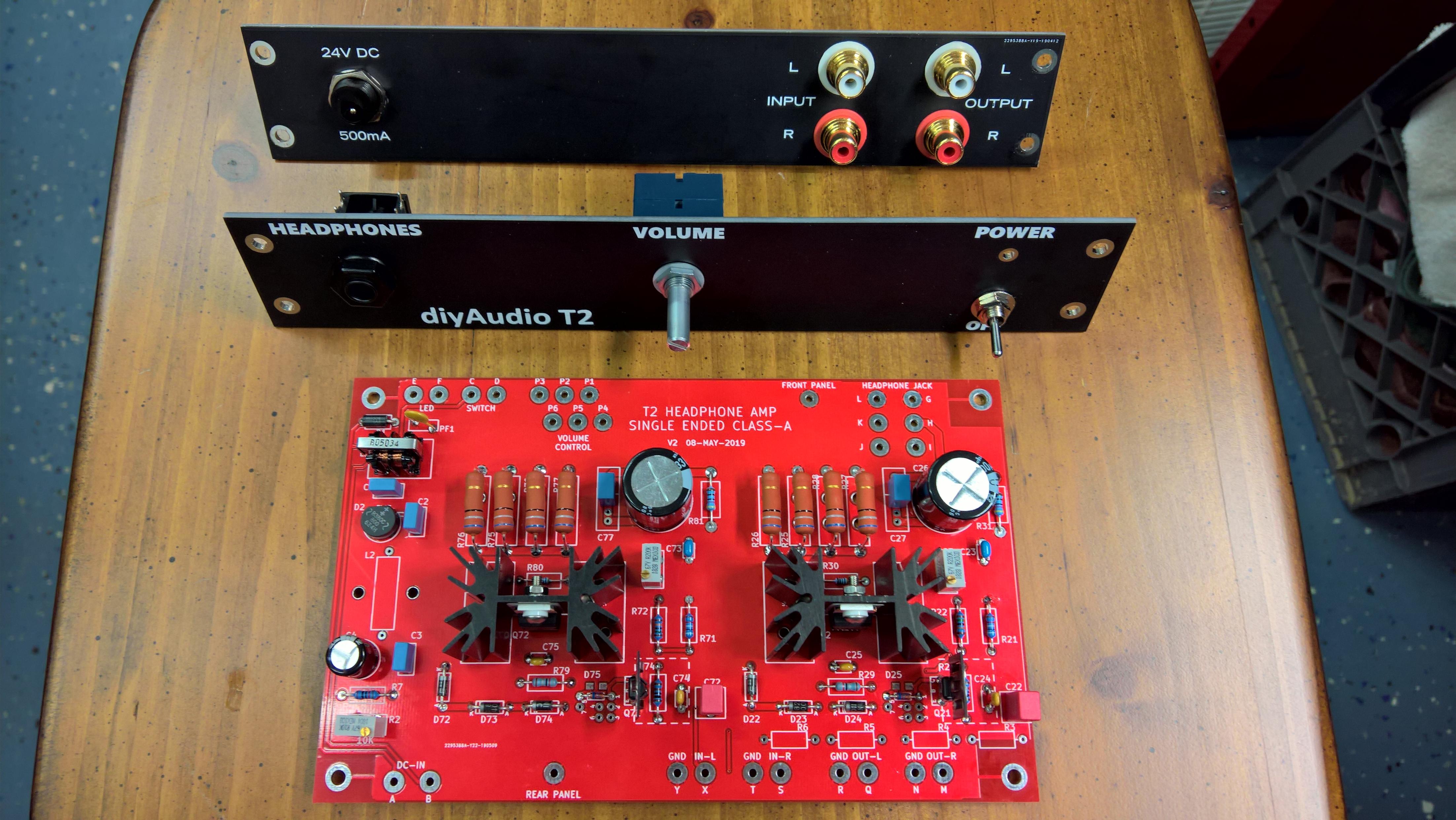

Stainless Steel M4 socket cap bolts for PCB front/rear panel mounting
The 1U Galaxy chassis from the diyAudio Store, ships with metal front and rear panels that mount to the rest of the chassis using countersunk screws. And the hardware kit that comes with the chassis, includes flat head screws with tapered sides that fit perfectly into the countersunk holes.
However, the PCB fab does not offer the option of drilling holes in the PCB material with countersinking. So if you attempt to attach the PCB material front and rear panels with the presupplied flat head screws, the screw heads won't be perfectly flush. The tapered sides of the bolt heads aren't aligned with un-countersunk holes. This may or may not be a bother to you.
I decided that I liked the color contrast of stainless steel "cap screws" to hold the black front and rear panels in place. You can see these in the photos attached to post #1 and #2. If anyone is wondering where I got them and how much I paid, the answer is: amazon.com. They are M4 x 10 mm stainless steel cap screw bolts with hex sockets.

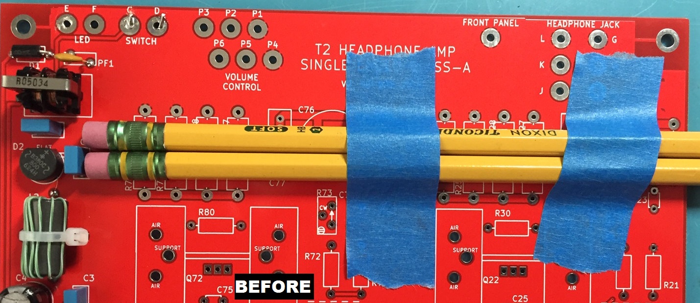

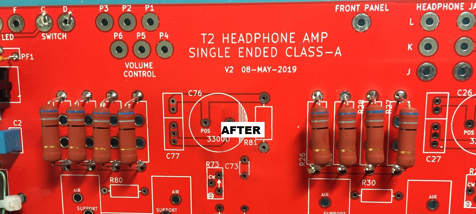

Here's what member adydula is talking about.
Notice the mistake in the before picture!!
The green metal barrel which holds the eraser is round, not hexagonal, and it's slightly larger diameter than the wooden hexagonal pencil. So after soldering the pencils will slide left but they won't slide right: resistor #2 (resting on wood) is too low and the metal barrel won't slide below it.
Solution #1 (good): before soldering, arrange the pencils with their eraser ends on the right, where they are not blocked by the power supply components. Now after soldering the pencils slide out effortlessly, to the right.
Solution #2 (ugly): after soldering, use great big diagonal cutting pliers to cut the left ends of the pencils off. You may need two "bites" to chomp off all of the green metal barrel. Now slide the amputee pencil stubs to the right.
_

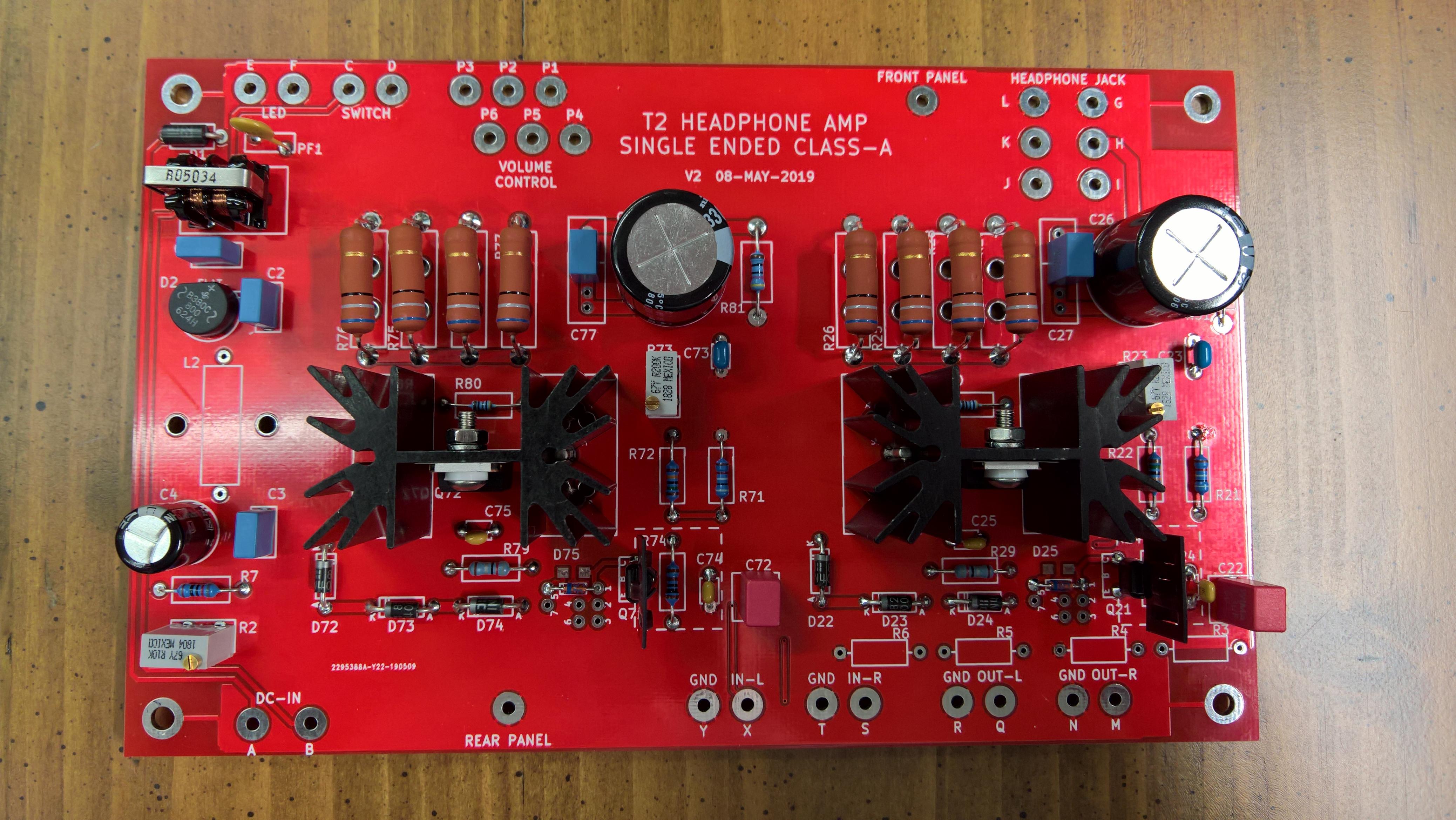

Ok, most all parts installed, just need to get the 28ga wire for the ferrite bead, should be here tomorrow, thanks AGDR for the Amazon source. The case came to day but I was out and missed the Fedex man, should be here tomorrow as well.
Then wire up, test and install...set the pots and hopefully listen and watch the heat boil off those big resistors!
Alex
Beautiful job Alex, congratulations! When you install the ferrite core, remember to also install resistors R3 thru R6 at bottom right. They drive the RCA output jacks.
Your board is super clean, with every last molecule of flux washed away. Very pretty!
