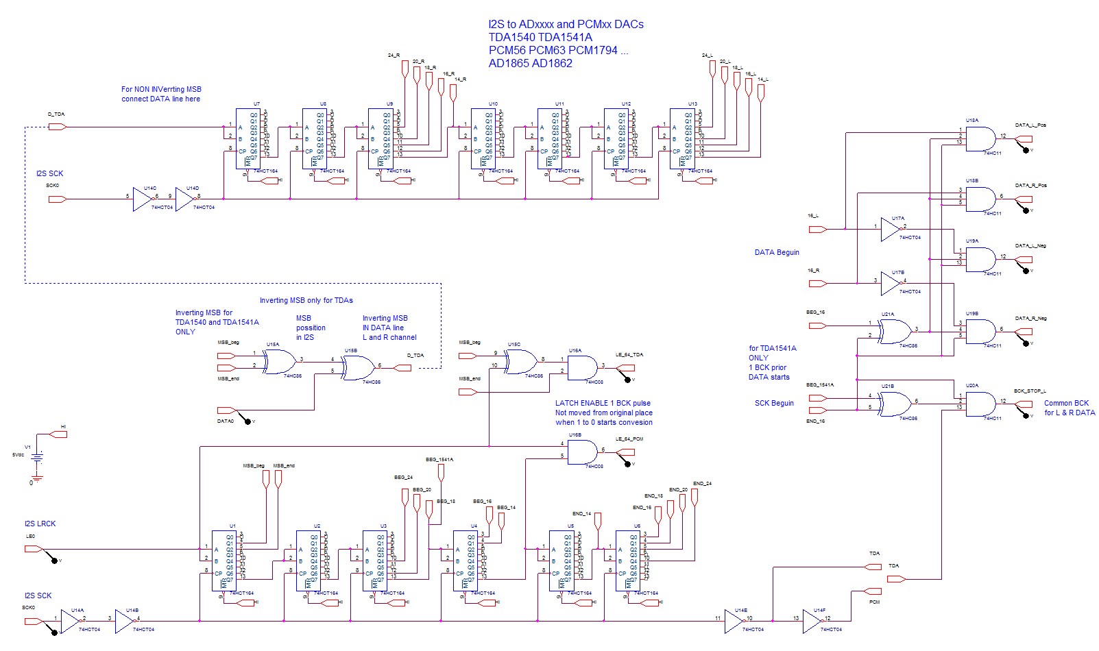

So, will anyone look at my diagrams of the logic I intend to use and confirm I did not make a big mistake? I can send an EXCEL file...

One circuit that can be used?
(I posted it earlier, probably in some other topic...)
Data are placed in the midle of LE interval, stopped clock, I2S input. MSB invert option, LE is not moved from original location, Inverted datas for balanced mode option, optional word length, TS and PCM/AD formats...
Could be used as discrete dac interface too, i didnt add some additional circuit...
Yes, but I stated from first post that this type of circuit idles not suited to optomise the TDA1541.
Creates an unnecessarily high bitclock. One main aim is to run at BCK at 16 X FS.
Here BCK will be 64 X FS.
We would be better off to just use WM8804/5 or CS8416 set to 16Bit IIS output with BCK = 32 X FS.

It does not "create" BCK, tis is the same range BCK from I2S bus. Just stopped...Creates an unnecessarily high bitclock. One main aim is to run at BCK at 16 X FS.
It does not manage BCK with changing frequency.
More change will be to make 16 cycles BCK from 64 cycle original rate per Fs.
(One Fs cycle in I2S format contains 2 x 32 bit word = 64 bit/fs)
But is ti acheivable I think? I can try to make something with glue logic 🙂
I can double the BCK and double each DATA bit?
(Method could be a factor - maybe something opposite of return to zero?)
Main digital interface is probably USB / I2S. with stadard 2 x 32 bit per Fs. Most people are using them.We would be better off to just use WM8804/5 or CS8416 set to 16Bit IIS output with BCK = 32 X FS.
I have very good experience with original Amanero and I will contionue with it...
With some modifications. I am thinking of sort of "nest" PCB for Amanero...
SPDIF and other input iterfaces are welcome off-course. I have some WM8804 and 5 and certanly wil be present as option...

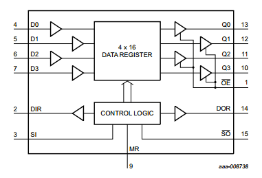

What I propose is to use 4 x 16 Bit FIFO's (74HC40105).
We use one FIFO as delay. The thing about a FIFO is that one full, the data flow stops even though the input clock keeps running.
With the FIFO full indication we know that 16 bit's are inside the FIFO.
This a single IC to do a lot.
The next stop, we need an elastic buffer that can absorb the 16 Bit data "burst" at BCK = 64 X FS and always output 16 Bit at BCK = 16 X FS.
It is obvious, that a single 16 bit FIFO is too short, so we cascade 2 pcs of 16 BIT FIFO chips.
Final logic, we have L/R data and using suitable logic we create an LE pulse that is 1 BCK wide and is also send into the FIFO. We also use this logic to invert MSB similar to how you do it.
That accounts for three of the four FIFO lanes, the fourth lane simply contains "high" and is used for flow control. Making sure we have 16 bit in the 32 bit FIFO, before starting the output clock.
The output clock run constant (once the FIFO is full) at 16 FS and we use it as BCK for the FIFO output and the TDA1541 BCK, we have LE, DataL and DataR from the FIFO.
We need 3pcs 16 pin FIFO IC's, some gates for inversion of MSB, a divider by 4 to make the new BCK, a delay of WCK by 1 BCK.

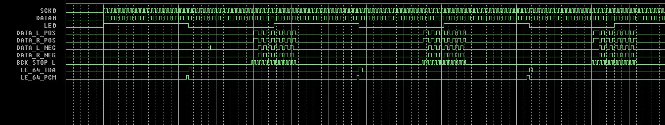

I drew out the timing diagram in excel and posted it here. I think it's a very neat way doing this.

The FIFO IC to use is 74HC(T)40105.
Simply because anything else is unavailable. I would prefer to use 74ACT2226, but they are essentially unavailable.
The 40105 is a 16 pin IC with a 4 X 16 memory, that is, in/out is 4 bit wide and 16 Bit deep.

I drew out the clocks and data etc. for each block here:

I figured we can use a 40105 FIFO for the 16 Bit delay and it gives us most of the flow control.
Our first stop, we delay WCK and align the falling WCK edge with the falling BCK edge.
Now, while WCK is low we enter bit's into one lane of a 40105, I call that FIFO0.
Once the first 16 MSB are in the FIFO we can keep the clock going, the FIFO will just ignore the extra bits, as we are...

Look at my timing diagrams.
Illustration
