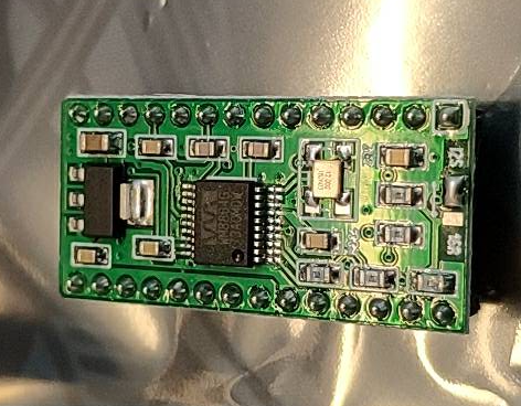

Look what the postman dropped of here at Casa al la Playa, at the Thai Riviera...
I need to see if I can improve the Power supplies and find a nice 12MHz crystal.
