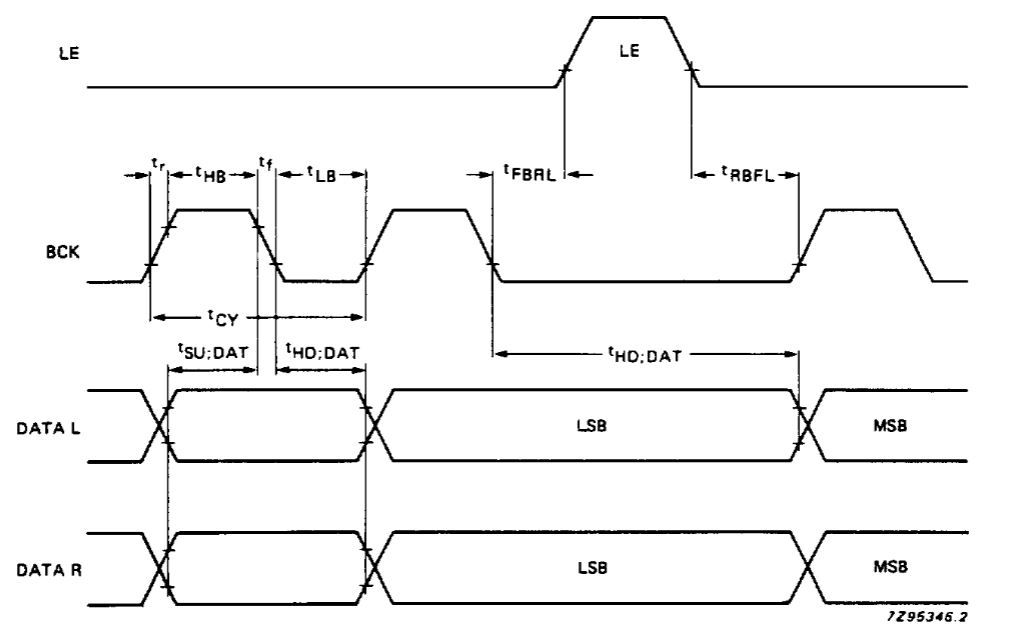

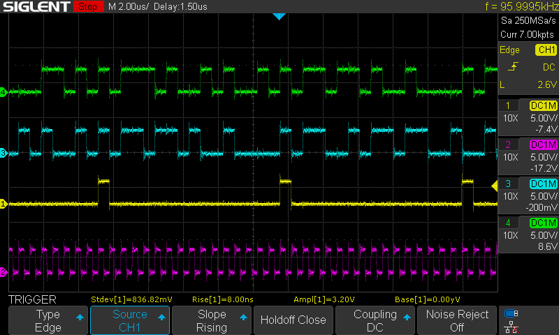

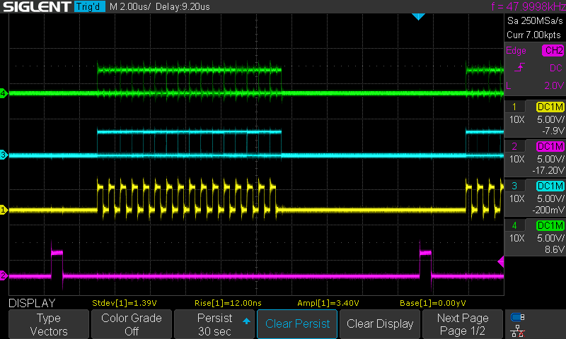

May I ask how your implementation of the TDA1541 sim mode signals look like?
According to the datasheet, the pulse width of latch signal should be kind of between the samples, althought the Tfbrl and Trbfl can be zero, maning in case of continious bit clock, it should be 1/2 bit clk period wide:
I've implemented this mode in York first with the 'stop clock' mode, so that the latch pulse is between samples (purple one):
And then I also tried implementation with continious bit clock but the witdth of latch pulse is equal to one period of bit clock.
This is due to limitations of the MCU. Possible to overcome but requires use of different pin so I want to avoid. This is how it looks:
So far experiments show that TDA1541 is totally with that but need to run more experiments to make sure that LSBs are fine.

You are reading too much from that TDA1541 datasheet timing diagram. Datasheet does not specify anything about the length of LE pulse. Only that "the converted samples appear at the output at the positive going transition of the latch enable signal". Even the bit clock edges can be aligned with LE pulse edges (0ns minimum tFBRL, tRBFL) so timing wise it seems quite lax compared to e.g. some DS dacs.
Same thing with other DAC chips using LE. E.g. in AD1862, PCM63 or PCM170x datasheets the minimum length of LE is specified, not maximum length. In those DACs LE falling edge is the trigger.
What TDA1541 datasheet timing diagram shows is a stopped clock operation. This is somewhat odd as the datasheet does not state anything else about it.

Actually, let's look at the datasheet a bit more.
First, unlike the standard way of latching data on the rising edge of BCK, in SIM Mode each bit it latched on the falling edge.
Tfbrl, Trbfl, Thd;dat can all be zero.
Tsu;dat must be at least 32nS, thb/Tlb must be > 46nS.
Tcy must be > 156nS thus max BCK per datasheet is 6.41MHz.
First the implication of Trbfl is that when the falling edge of LE happens is immaterial. Wordselect (LE) hold is also stated as Zero in the TDA1541A datasheet (32nS in TDA1541 non A), meaning once the leading edge of LE/WS is processed what happens on LE is inconsequential.
We need to bring it low eventually to prepare the next LE cycle and this needs to happen at least 32nS before the rising edge, but how long LE stays high is inconsequential.
You can run LE directly as LRCK and I have seen hardware designs that work that way.
So for LE the ONLY thing that matters is the leading edge happens no earlier than the falling edge of BCK is below the threshold of the TDA1541.
The only timing that is relevant to the TDA1541 Jitter in SIM Mode is the LE rising edge.
My own conclusion is that if the LE rising edge is aligned with the BCK rising edge and LE goes low on the falling BCK edge after the MSB (that is when the bit after MSB is latched) all strictures are fulfilled. As we need to detect the MSB anyway to invert it, this minimises hardware logic or programming.
A further indirect conclusion, SIM Mode is likely the TDA1541 "native" format, so when using IIS input additional logic is inserted that converts IIS to SIM internally and BCK runs faster. This logic likely adds additional noise & Jitter on top of what happens in SIM Mode.
Which together with being able to use the slowest BCK and the most limited edge rate makes SIM Mode very desirable when operating the TDA1541, so the option of using 16 Bit IIS while better than nothing, is still too subideal. But it provides a fallback.
