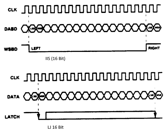

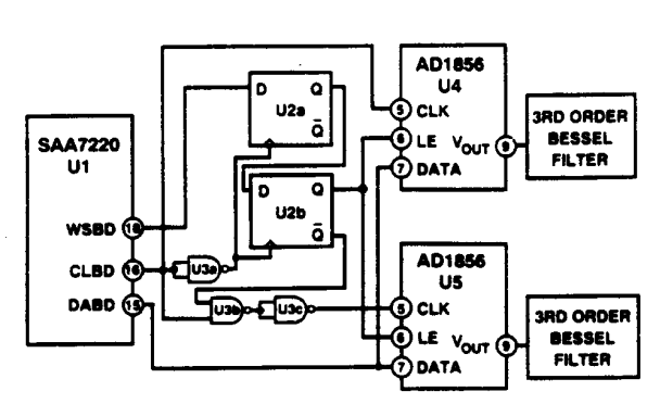

Conceptually it's easy enough.
We want to extract two parallel 16-Bit Data streams from standard IIS with 64 Bitclock cycles per sample and invert MSB.
We want to output this data as TDA1541 SIM datastream with LE pulse and 16 Bitclock cycles per sample.
We also want a fixed DEEM Clock synchronised to MCK at 8 X 44.1/48kHz.

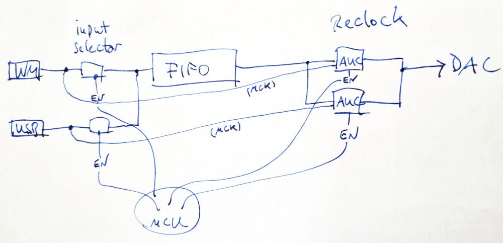

With 3state gates you could solve the input selector and a final reclocking stage:
I could. I tend to use something 74xxx16244 as selector for multiple I2S inputs in commercial designs, using the OE pins. It makes a nice layout as result of the flow through design and decoupling arrangements are good due a sensible pinout.
I would avoid this for the master clock.
In some of the lower end stuff I use NC7SZ157 as clock selector. Higher end gear uses relays.
I am very much trying to avoid using anything that needs code, if possible. This is DIY. I don't want to do what I would for work.
Anyway, sorting this out is the least of the problems here.
Thor
Exactly: hence my proposed solution doesn't even need a clock selector.

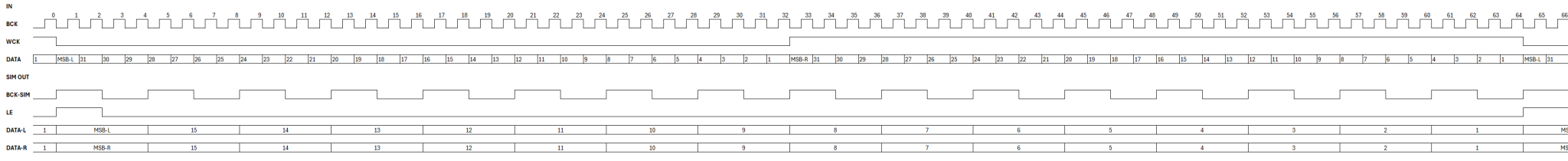

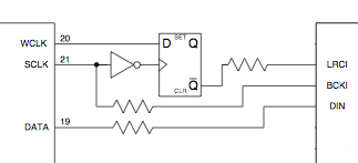

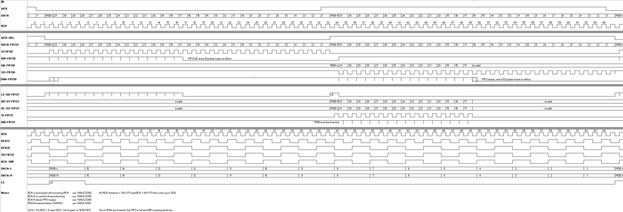

Ok, I put on the Captain Morgan cap and went outside under palms and had something very cold from a very big sweaty glass. Watching cats, birds etc.
I figured we can use a 40105 FIFO for the 16 Bit delay and it gives us most of the flow control.
Our first stop, we delay WCK and align the falling WCK edge with the falling BCK edge.
Now, while WCK is low we enter bit's into one lane of a 40105, I call that FIFO0.
Once the first 16 MSB are in the FIFO we can keep the clock going, the FIFO will just ignore the extra bits, as we are not clocking out. We now have 16 Bit in the FIFO ready to go, but no clock on the output.
When WCK goes high we enable the output clock on the FIFO and keep the original data going.
We now have the 16 MSB of the DataStream L/R and we clock these into the next 40105, I call that one FIFO1.
By using FIFO0's DIR Flag and delayed WCK with an EXOR gate we can make the 1BCK wide LE pulse that also enters FIFO1/2. And we can use this pulse to invert the MSB's while they enter FIFO1 using another two XOR gates.
When FIFO0 hit's empty we stop the SI clock to FIFO1. The 16 bit's we entered into the FIFO1 have rippled as far right as possible, we have 16+n (where n is likely 4) bit's in the 32 Bit FIFO made up from FIFO1 & FIFO2.
We have a continuous clock of BCK/4 running on the output of FIFO2. So for every WCK period we clock out 16 Bits. The data in the FIFO varies between 8 Bit's (shortest) and 20 Bit's.
So here the full timing diagram. I think the logic that remains to solve is trivial.
We need 3pcs 74HC40105, 1pc 74HC86, some flip-flops to divide BCK & MCK and our output reclocker latches. Some more gates to handle clock gates.
And we get a nice buffered stream at BCK IIS / 4.
Again, anyone see any mistakes in the timing diagram?
