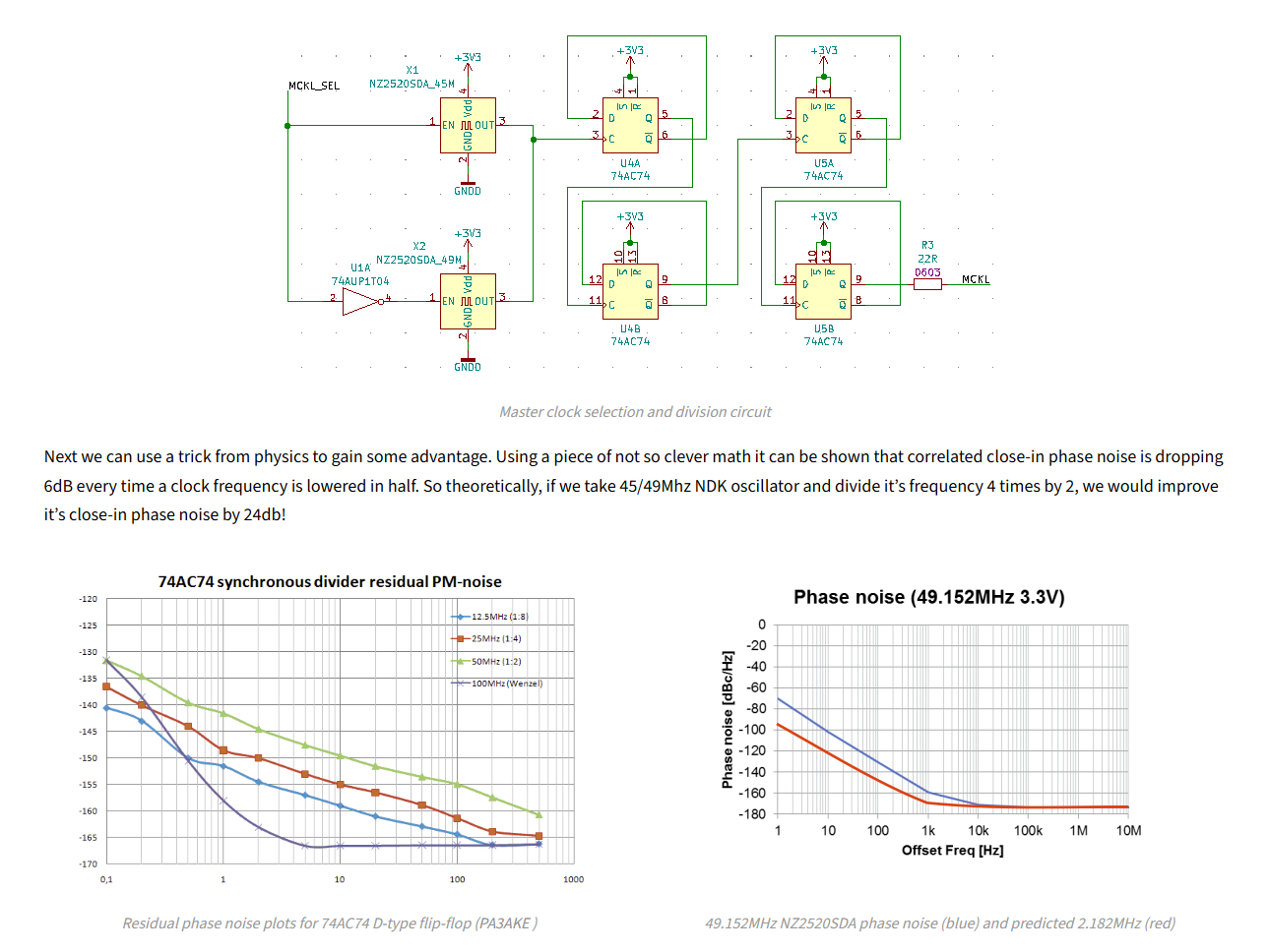

Each time we divide our clocks by a factor of 2 we lower Phasenoise by 6dB.
So if we reclock IIS BCK with MCK (_Bar to have reliable setup) and divide the resulting clock by 4 we have cut remaining jitter that reclocks LE by a factor 4 or phasenoise by 12dB, compared to reclocking with MCK, presuming our divider logic is low noise.
In normal I2S stream we have 4 cycles of MCK in one BCK cycle.
that is 8 time stripes in one BCK. When ew use just one F-F we have 1:7 ratio and BCK comes out with half of MCK cycle with oposite edge...
When we use 2 F-F ratio of time in one BCK is 2:6 so it is better.
But maybe the best situation is to have 4:4 ratio of time, same rising egdges in the middle of BCK

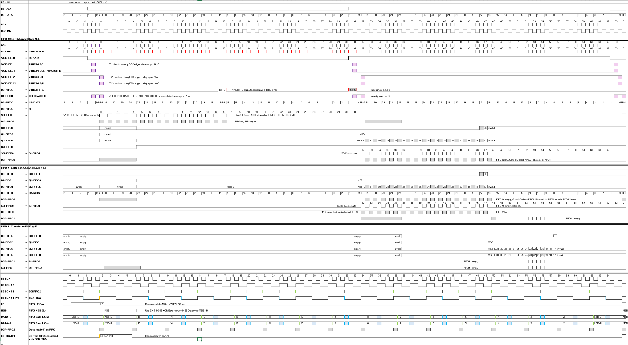

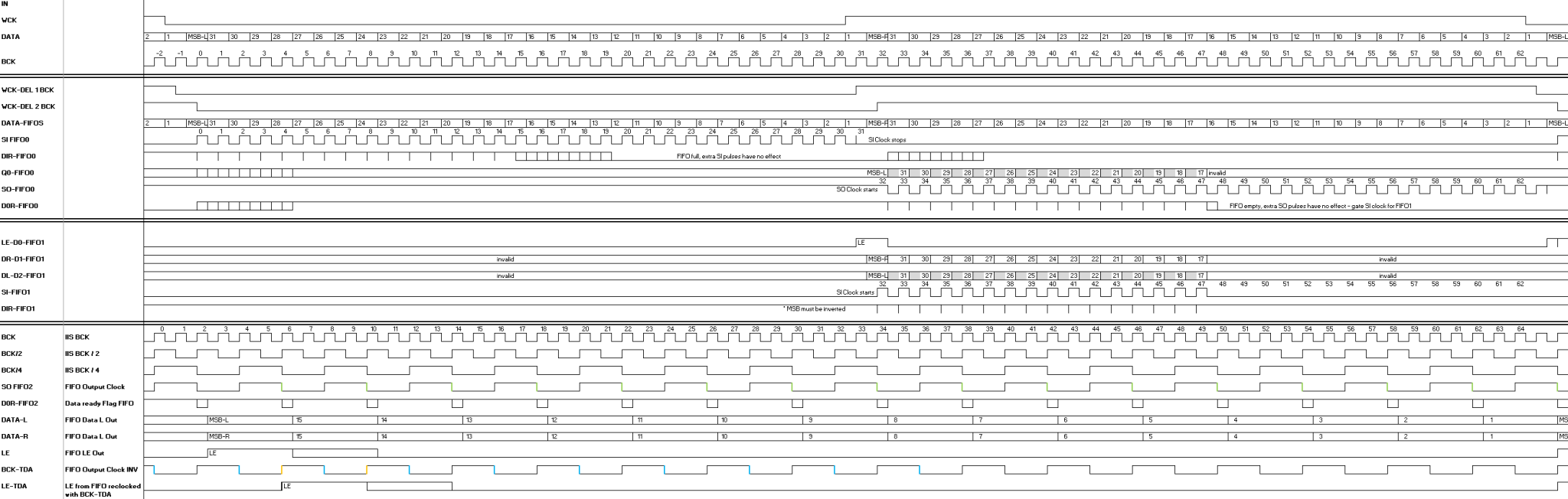

Ok, I updated my timing graphs including the appx FIFO Delay etc. All this is for 192kHz with the IIS BCK Cycle ~ 80nS. The negative spikes on SI/SO are actually up to ~ 20nS wide. Putting this in means I have to redo the whole spreadsheet with double the number of columns.
I'm presuming a really fast (74F74, 74AC74 or 74AUC1G175) Flip Flop for the LE reclocker (take something slow and the setup time may not work).
It shows all relevant edges and data clearly marching into the TDA1541 in correct order and timing.
Where there is a risk of meta stability and/or timing uncertainty I have drawn this in.
As we can see, we can use the first FIFO (the one that stores the left channel 16 Bit Data to align it with the right channel data) can also give all the necessary timing to gate the the SI Clock (input bit clock) for the flow control together with a 1/2 BCK delayed WCK.
We may need to see how the LE & MSB Inversion behaves in the sim. I'm still thinking how it will work best, we need a "cutoff" before the next rising edge of I2S BCK, but some holdup time. Double inverter perhaps.

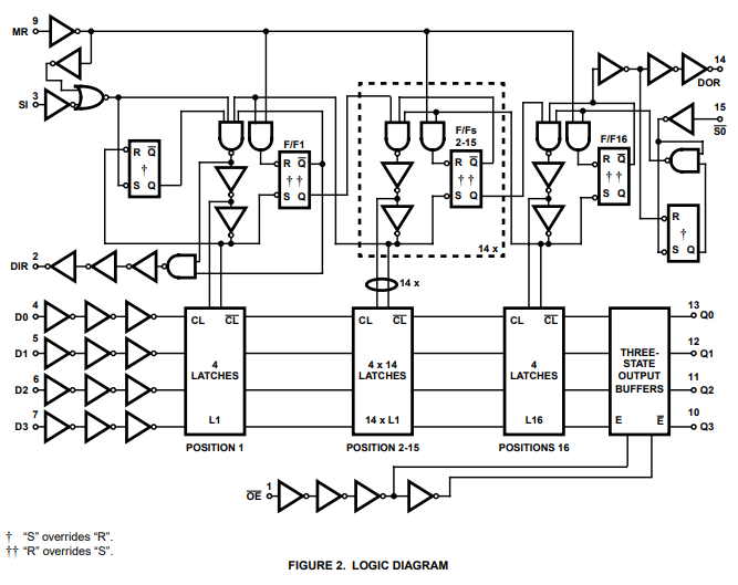

Here a more detailed schematic of the 74HC40105 internals. It may make it clearer what goes on inside.
And I just had a BBFOTFO*.
The relatively slow FIFO's cause some uncertainty and headaches for the project.
The solution, cascade FIFO IC's differently.
First, one FIFO (#0) gets loaded with the 16 Bit's for left. One of the 4 lanes is used. This is done by gating the SI (input) clock so it runs at WCK = L with a delayed clock.
We run the the output of FIFO #0 into the next FIFO (#1) say D0. The actual data from I2S connects to D1. FIFO #0 /SO (output) clock connects to FIFO #1 SI.
After 16 BCK out FIFO #1 holds 16 bit L/R and FIFO #0 is empty. We should actually also enter the LE "marker" into FIFO #1.
There is no reason to use BCK as the output clock of FIFO #1 to transfer data into FIFO #2.
Flow control can be left to the FIFO expansion system.
The logic is simple, while FIFO #0 is empty, we stop SI to FIFO #1 and connect FIFO #1 SO to FIFO #2 DIR, so FIFO #2 can "pull" data from FIFO #1 as fast as it can.
With FIFO #1 full, FIFO#3 will hold 4 bits. The next 12 Bit will ripple into FIFO #3 at the maximum speed the FIFO's are capable of, around 30MHz according to datasheet.
As the final 4 bit of the previous sample and LE are clocked out of FIFO #3 the remaining 4 Bits in FIFO #2 transfer into FIFO #3, which now again holds 16 bit's with the MSB/LE marker.
FIFO #0 and FIFO #1 are empty. WCK goes low, we start again clocking into FIFO #0 and the cascading between FIFO #1 & #2 is cut .
We do inversion of MSB after the FIFO using the LE pulse. We reclock/latch LE with BCK, creating the correct timing for TDA1541.
This minimises any additional logic and relies on the FIFO's internal control for managing most flow control and WCK for the rest.
I think we are zeroing in on a solution.

Ok, the logic diagram has grown enough to no longer fit vertically on my screen....
I added more colour to make it easier to follow. previous versions had some errors.
Working backwards, from the TDA1541 inputs.
As it stands, we use a pair of 74AC74/74F74 Flip Flops (lowest added phase noise except AUC logic) to divide BCK by a factor 4. This gives our output clock with low jitter and delay.
We add another 74AC74/74F74 flip to re-clock BCK by MCK.
We use the final 74AC74 as latch to correct LE Timing and re-clock the LE with our divided BCK, which is the crucial clock in our system.
We use BCK/4 for the FIFO output clock and BCK/4 INV to clock TDA1541?
We then add more 74HC74 for the DEM clocking. Coming to that later, but 48kHz FS is 768kHz BCK. Divide by 4 for 176kHz, @ 96kHz we get 384kHz DEM (optimum per @lcsaszar) and 768kHz @ 192kHz (with 3.072MHz BCK). A slight compromise, but all these frequencies are "normal".
The final 74HC40105 FIFO of 3 FIFO IC's in the system provides the following signals:
LSB FLAG aligned with LSB
MSB FLAG aligned with MSB
DATA L
DATA R
A pair of 74HC86 gates invert the MSB when MSB Flag = H. We use 1/2 74AC74 to use the LSB to derive the LE pulse from it.
We use resistor dividers / pullups with ~ 3kOhm output impedance ( ) to give reduced signal swing and slew rate limiting (36nS rise time to 70% of 1.8V) for TDA1541. Very simple. For LE we make a "flying" attenuator. Ok, Last FIFO and TDA1541 are taken care of.
The FIFO before this is connected as extension. I need to think a bit more if we need extra flow control here of just let the final FIFO "pull" data as it comes out. On a quick think I see no reason to stop new data to go straight to the output FIFO if there is space. The Input of this FIFO get's it's Data inputs from the next section.
Now comes the really interesting stuff.
We use 74HC74 (both flip flops) to delay the WCK (1.5 BCK) and an XOR Gate (1/4 74HC86) to get the MSB marker that get's into the first FIFO (FIFO #0) D1.
We use inverted BCK (1/4 74HC86) to invert BCK and one of the delayed (and inverted) WCK to drive a 74HC161 counter that creates the LSB Marker from the 74HC161 TC output to FIFO #0 D0.
I2S Data enters into D2 and D3 is unused (tied High).
Once 16 Bit's of Left Data are latched into FIFO #0 together with LSB and MSB flags we stop the input clock (2 X 74HC08) by using an OR of FIFO #0 DIR and the delayed and inverted Word clock, to gate BCK using a second 74HC08 Gate.
The SO line of FIFO #0 and the SI line of FIFO #1 are linked.
The delayed WCK and the DOR line of FIFO #0 are OR'ed (2 X 74HC08) to enable the BCK to drive these two lines.
On the rising BCK edge Data and Flags on the output of FIOF #0 and the I2S Data line data bit are clocked into FIFO #1.
The falling edge of the gated BCK updates the outputs of FIFO #0, the new word takes on average of 36nS to appear, fast enough to be there before the rising edge. But because we have an interlock with DOR of FIFO #0, if necessary the SI clock is delayed until FIFO #0 has valid data. Once FIFO #0 is empty the clock is stopped.
The system now waits for the WCK falling edge to enable data going into FIFO #0 and everything starts from the beginning.

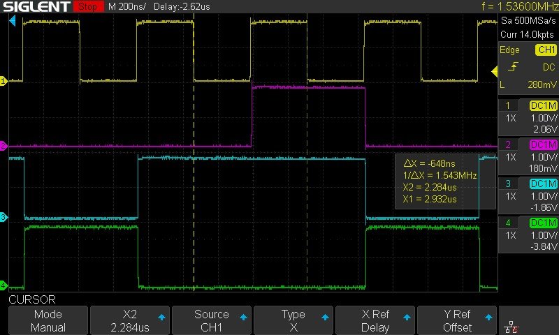

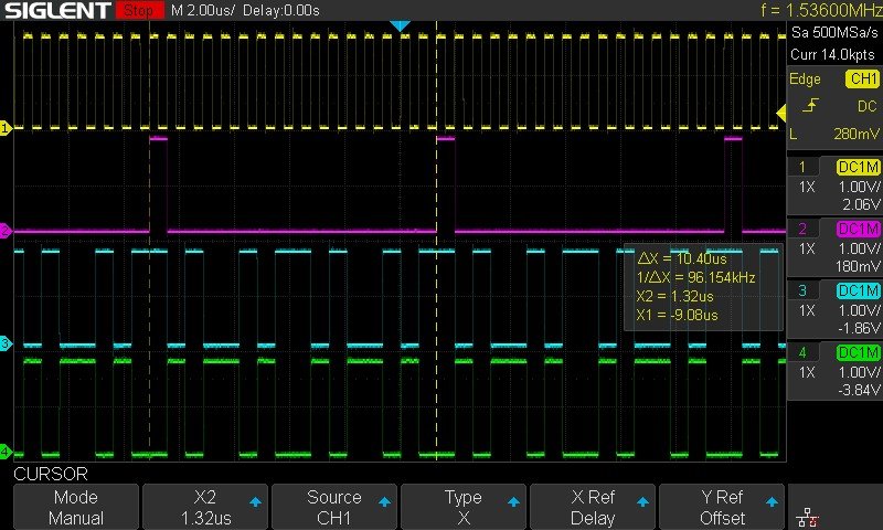

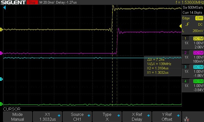

I took couple of scope shots from my STM32H7 USBI2S sim16fs output. FS is 96kHz, channel 1 plays 0xA5A5 and channel 2 0x5A5A. As can be seen with 16fs there is not much timing room for LE. According to datasheet the separation of BCK and LE edges could be 0ns but I doubt that could work with 16fs. The 7ns on my board is probably sufficient.
Reactions: eclipsevl
Really? Rising edge of LE should align with the rising edge of BCK, the TDA1541 in SIM mode loads data on the falling edge. Realistically, the LE rising edge must happen before the following BCK falling edge.
So after the falling edge of BCK we have 1/2 BCK to use a latch to the LE pulse with the rising edge. At 192kHz FS this is 162nS...
The 74AC74 or 74F74 I intend to use have around 3nS propagation delay from CP to Q.
To me, tons of timing room.

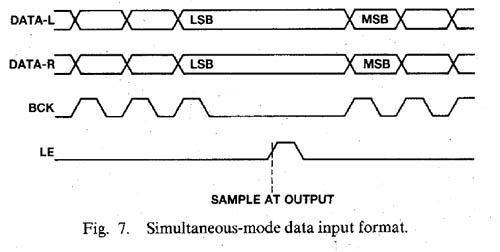

Ok. I seem to have misinterpreted the datasheet as it is not very clear on this. I need to change the register controlling the data sampling edge from rising to falling.
There are jobs for software on 32 Bit MCU's with non-guarateed timing.
The I2S timings of STM32 MCUs are quite well guaranteed. Propagation delay limits or part-to-part skew of 74xx74 is not very tight either.

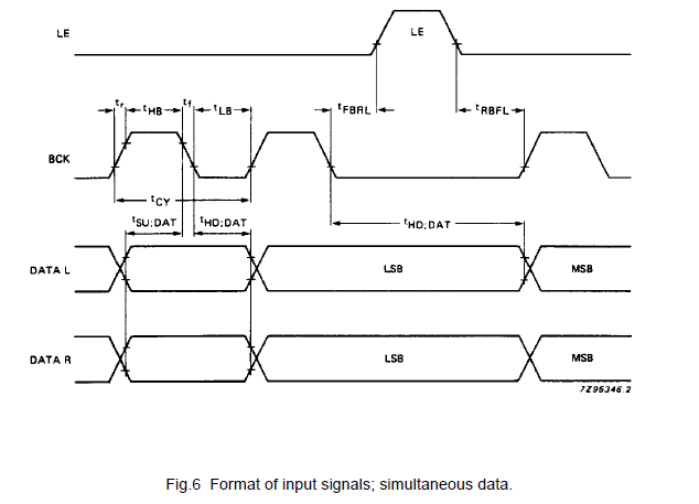

Really? Here from the datasheet:
Fig. 7 shows the second possible input data format. In this mode the DATA signals of the left and right channel are applied simultaneously to two different input pins. Only one bit clock signal is used to clock both data signals into the converter.
The positive slope of the latch enable signal is used to indicate the end of the data input action and to determine the moment at which the outputs change their sample values.
This input format is especially suited for those cases in which the circuits in front of the DAC use a nonstandard serial format.
I thought is pretty clear.

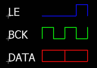

The TDA1541A datasheet contradicts the above. The minimum time for both falling edge BCK to rising edge LE and rising edge BCK to falling edge LE is 0ns.
With BCK continuous at 16Fs yields LE as short as what is shown below.
Correct, the MINIMUM time. Not the ONLY time.
When designing serial logic it is best to leave some space.
I probably wrote this a bit badly, I did not mean to imply that this is a hard requirement, but an easy way to ensure that all timing requirements of the TDA1541(A) are fulfilled.
The hard requirements are that the rising LE edge doesn't happen BEFORE the falling BCK edge of the LSB and that it happens before the next falling BCK edge.
Placing it right into the middle of this window, given all possible timing uncertainty etc. seems commonsensical to me.
There is no limit to the length of the LE pulse, other than it must be low for the required setup time prior to it going high. So making it 1BCK long again is commonsensical and simplifies the circuit.
Thor

Earlier in this thread (in post #66) another member asked me to post a picture of the SIM signals of my board. Doing as asked is not promoting my solution.
Also the datasheet I have is for TDA1541A and has the same diagram as shown above in post #135. That diagram is not very clear which caused my misinterpretation.
The title in this thread asks for collaborators. Usually it is best to have alternative solutions available in case things do not go as planned. Another reason for alternative solutions is that needs vary. With solution as my board those using only USB do not necessarily need any additional board but they may still be interested in both solutions. And if my board is not satisfactory it should be possible to implement similar functionality to @eclipsevl's York boards as implementation on STM32H7 was trivial.
