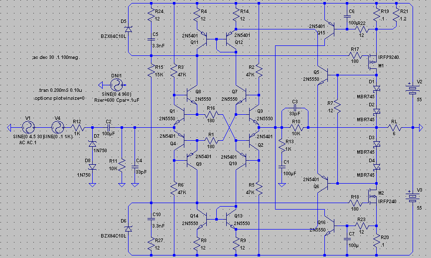

Hey Ken, could you achieve less barbaric clipping by changing Q15's collector over to the left side of R10? This way, the VAS won't dump current into the limit transistors.
- keantoken
- keantoken
Highlee interessant... But what effect does that have upon offset?
As long as it don't leak any DC, I suppose its OK. Is that realistic?
That clip is for safety, current limiting. Yet the barbaric side effect,
feedback related transistors are shut off by it. Tricking the NFB loop
to do this dirty work is preferable in that respect over shorting drive
to the rail. I think I would still leave the Barbaric Zenier in there...
Berberis is sour berries you put on rice.
Whatever, shouldn't current clipping have a higher threshold into
8ohms than input voltage clipping? I guess this isn't hard to adjust...
Throw another Schottky to the drive, just so's if the loop don't
succeed in stopping the overcurrent, the protection circuit can
still function as was originally intended. And there needs to be
resistors too, so's BOTH limits are still able to activate at once.
The way you got it now, can have an infinate output current
into a shorted load, so long as the DCs balance... Supposin
the Schottky stack was to overheat? Even though thats not
real likely... I like not to sabotage my insurance.

Didn't think my crazy current drive was all that broke.
Why we throwin another whole EF stage at fixin' it?
Already handles the full swing @96K, we need more?
I ain't fond of mixing caps and clipping, sounds like a
strategy for error storage and delayed recovery? Show
me the plan when you got something direct coupled.

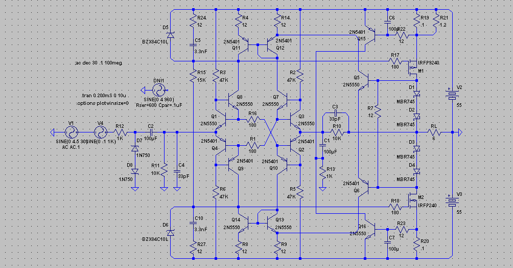

The caps I describe would, infact, cause current limit only on bass and low frequencies (too low frequency for SOA), which actually supports your idea of a "preserved clip" where only the troublesome noises are clipped (the cap would cause clipping of the bass but wouldn't clip others). I don't have much experience with this charge storage stuff you're always talking about, so maybe I'm missing something. My understanding is that although a cap would store energy, it actually extends the dynamic range where extendable rather than a direct coupled clipper that would clip out things other along with the troublesome signals. The cap extends power output, and in no way detracts from it, albeit behavior is the same at the low end of the frequency spectrum. Unless of course, we overdrive the Q15/16 and run into a diode type effect, but I don't see how this would happen in reasonable operation.
Got to sleep now. Cya
- keantoken
- keantoken
When bass clips, every frequency above is obliterated for the duration.
I'm not sure how you would suggest the cap has prevented this effect
from mutilating smaller signals at higher frequencies?
If you wish to selectively current clip subsonic bass that shouldn't be
in normal program material to begin with, that might be an acceptable
compromise. Still have to watch SOA isn't violated in either the short
or long term. I'm not sure why I would want a higher current limit at
higher frequencies? Tweeters just don't eat that much current...

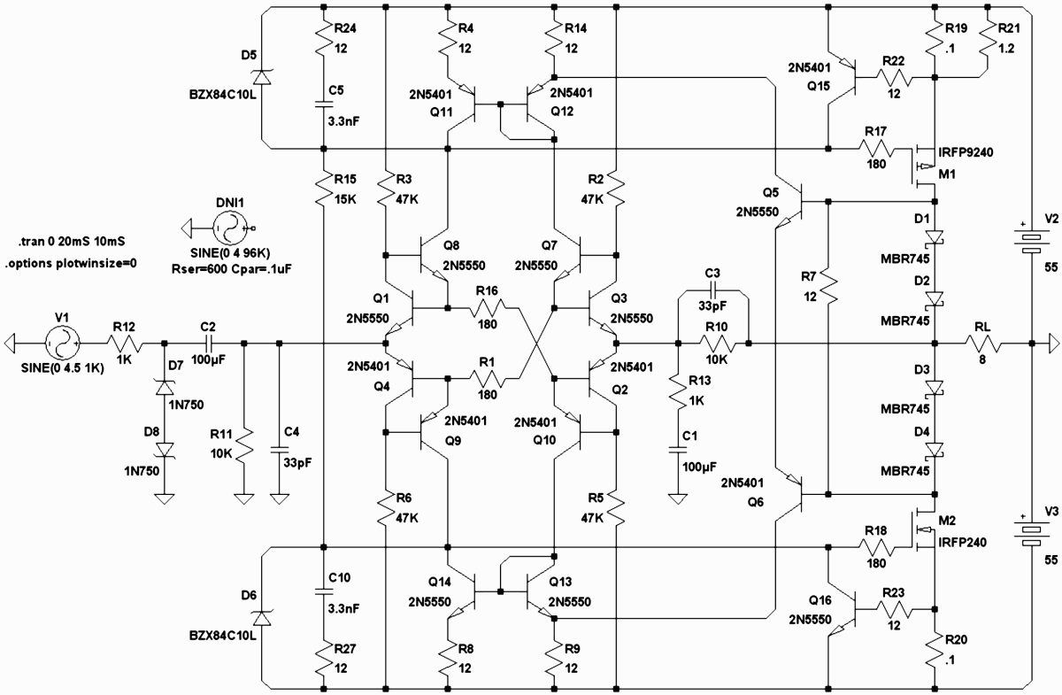

Re #522:
Remind me again why I want to store a long duration response to a short
duration problem on a 100uF cap bled by 1K thats also my one and only
DC servo reference for this whole amp?
From collector I got 10K in series to the feedback node. And a Schotkky
to the drive, just incase the loop has failed. Won't need that diode if
Barbaric limit is handled from a separate and parallel drain watcher...
VBE and HFE difference in Q15 Q16 is a nuisance... Focus on that for a
minute. Maybe its just VBE...

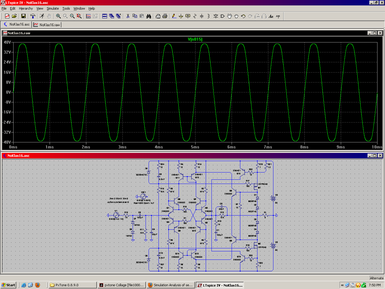

If all else fails...
The schottkeys you used have 740pF of capacitance, I fear they may corrupt the signal path. I suggest to use a silicon or a smaller schottkey.
I didn't see the concern for DC offset with the #552 before. Imbalance of Q15 and Q16 could cause the DC offset to drift during clipping. It looks like we can scratch that one off. Try this.
I grabbed a handful of vitamins yesterday, I think my brain is in gear lately. Gotta figure out how those work...
- keantoken
- keantoken

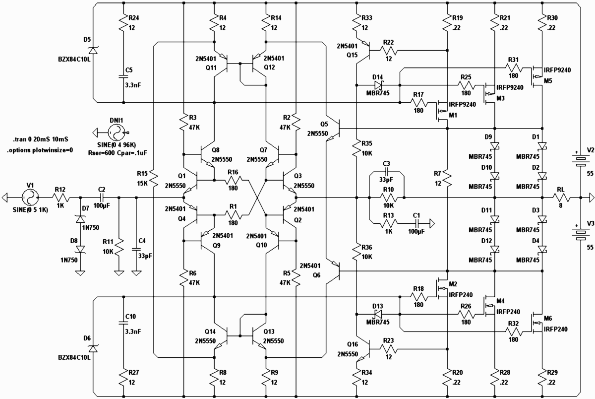

Then I'd just put a barbarian drain watcher on another drain and ditch teh Schottky.
Hey, notice I moved R15??? Effect is negligible, mo pointless symmetry for what?
Pretty picture? I shoulda left it unbalanced, just to make peeps ask the question.
I'm happy now with how the output soft and hard current limits.
Try dropping the load down 4 ohms or less, see how it shapes.
I had a beast of a time getting Q15 Q16 reliably biased to always
have the same threshold, I'm not sure this is the simplest way it
could have been done.
I'm not entirely pleased with the soft voltage limiting at the input.
Kicks in too early, and doesn't knee hard enough to stop a really
big input signal from eventually causing much uglier true clipping
that can shut off transistors and/or store error. It don't exactly
recover from a real clip the cleanest way you could hope for.
I managed to Muntz out half the parts in the Schottky stack at
the cost of loss of full symmetry, and a slight increase in 1W H2.
But the output voltage swing can travel quite a bit further now!
Q5's collector can actually get into trouble on high enough swing,
largely the reason for the poor clip recovery I mentioned above.
Still a work in progress, but you can see my design philosophy:
Smooth out and/or prevent every other possible misbehavior you
might actually hear (or smell burning) , and nitpick about sub-
percentile harmonic distortion for small signals last.

Well, I'm not deliberately trying to distort any signal under 45V and 6A.
Yet soft voltage and current limiting knees probably shouldn't have too
abrupt an onset. Hard to say exactly where they have to begin? Might
be something that has to be tuned by ear after the fact. Perhaps there
should be front panel controls for it?
Not exactly the same distortion controls as one might expect for an MI
amplifier... Especially not the current limiting... Then again, something
to be said for the Ron Popeil approach, "Set it and forget it."
