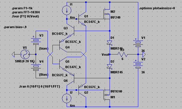

Hello everyone, I'm gonna post this here to get it off my mind.
This was inspired when I read about the Bernie Olliver "Null point" in one of the Krill threads. This same idea should apply to any two diodes working in this way.
So here it is. I coughed up one of my goofy schematics into the simulator for the sole purpose of finding the null point (you can use any version of the Allison provided you can alter the bias voltage). For the MBR475 models with LTSpice, the null point is at about 1.37A. Tweak bias voltage of the Allison until you get there, and if you want to go further you'll have to tweak using the .four THD analysis.
So, it is still possible to have very low distortion levels with the Allison in class AB. The Allison AB begins to rival the class A Allison when you take into account that it is more powerful on power peaks (the class A version has output current limited to 2x the bias current). Now, I'm curious if it rivals the EF at null point.

keantoken,
Can you point me to the krill thread?
How about posting some results? How is this different/better than the adjustable Allison A/B?
How do you come to this conclusion? For me, Schottky crossing distortion
forever goes down as bias goes up with no special sweet spot. An exact
bias shouldn't even matter where square laws rule, but even Schottkys
aren't perfect. What makes 1.37A some sort of magic number for "Null"?
Yet we aren't talking bout a whole lot of crossing distortion, even if biased
significantly closer to class B. Even approximated square law curve is good
that way, and thats the main reason to prefer them over log law bipolars.
Schottkys can approximate the right curve better than anything else but
MOSFETs or beam power tubes, and do so with minimal voltage drop and
minimum heat dissipation where actual curving decisions will be made!!!
I think it does make a difference the diodes are Schottky, and not just any
diode would do. Diodes must also be able to turn on and off without glitch.
Because doing so serves to keep back EMF from loudspeaker and bootstraps
from turning the power devices completely off. A bleed resistor across the
voltage gap (but not connected to the load) can then provide a minimum
do-nothing current to the power devices at all times.
Power devices that never turn off, implies conditions that make it fairly easy
to insure the entire drive train should never have to turn off.
Right now: I'm favoring about 300mA Schottky crossing, plus another 100mA
of do-nothing current, with acceptably low distortion.
It's not the circuit I posted but the concept!
There is some point observed by a guy named Bernie Olliver, where the transfer curves of two BJT's cancel out and distortion drops. Here is the post I mentioned:
http://www.diyaudio.com/forums/solid-state/151295-krill-next-generation-9.html#post2085739
This will work with any Allison circuit, and with the bias current I specified if you use LTSpice's default MBR745 model.
It may appear that distortion steadily decreases with the transition into class A, but this is not true. Keep going up in small increments from, say, 100mA for a bipolar EF stage, and looking at the THD number until it starts to increase again. Then turn it down in smaller increments until you find the null point.
- keantoken
