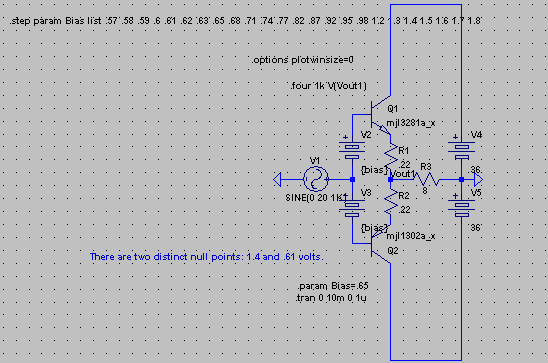

Simulation Analysis of several unique Allison-based output stages.
The null point is between full class A and class AB. For a bipolar EF the first AB point doesn't cancel completely, but if you keep going up you'll get to another point that cancels better... It is very easy to miss. I think this same behavior would show up if you added together two exponential curves (one inverted along the Y axis) and varied the Y intercept.
If want a good mix between A and AB, I say the null point is the way to go. the first watt will be class A, and the rest will distort minimally.
I've attached a demonstrative file for the Null point. The two null points, for class AB and for Olliver's, are at .61V bias and 1.4V bias. Rename .txt to .asc.
- keantoken
  • Null Point.txt
    Null Point.txt

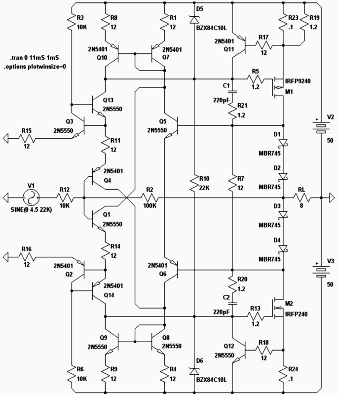

This is DFenriz inspired input stage. I thought it looked to me kinda like Allison?
But turned backward of the way we usually do, his emitters connected to load...
Unlike Fenriz, I connect the node between Q2 Q3 emitters to GND. So, in this
configuration, we have an inverting amp.
Anyways, what I show with the Schottkys and the reserve current bypass are
exactly the same what I would do with any "normal" Allison, and for the same
reasons.
You can see I've abandoned my usual 0.1R in series with one Schottky in the
output gap. This last vestige of Class-A resistively crossed Allison is gone.
Square law crossing is still plenty smooth, even though deliberate underbias of
two Schottkys here creates a very small, almost Class B crossing, its glitchless!
And remember: I got another 120mA+ shootin thru R12, so my power devices
are never actually sufferin' class B. Its only the Schottkys what ever turn off
and/or forced to operate on the curve.
Pick-a-bias, any reasonable bias, a square law will cross it. Thats why I don't
have to worry or maintain what is exact bias for square law "Null" ???? It just
don't matter that much when your diode got the magic curve..

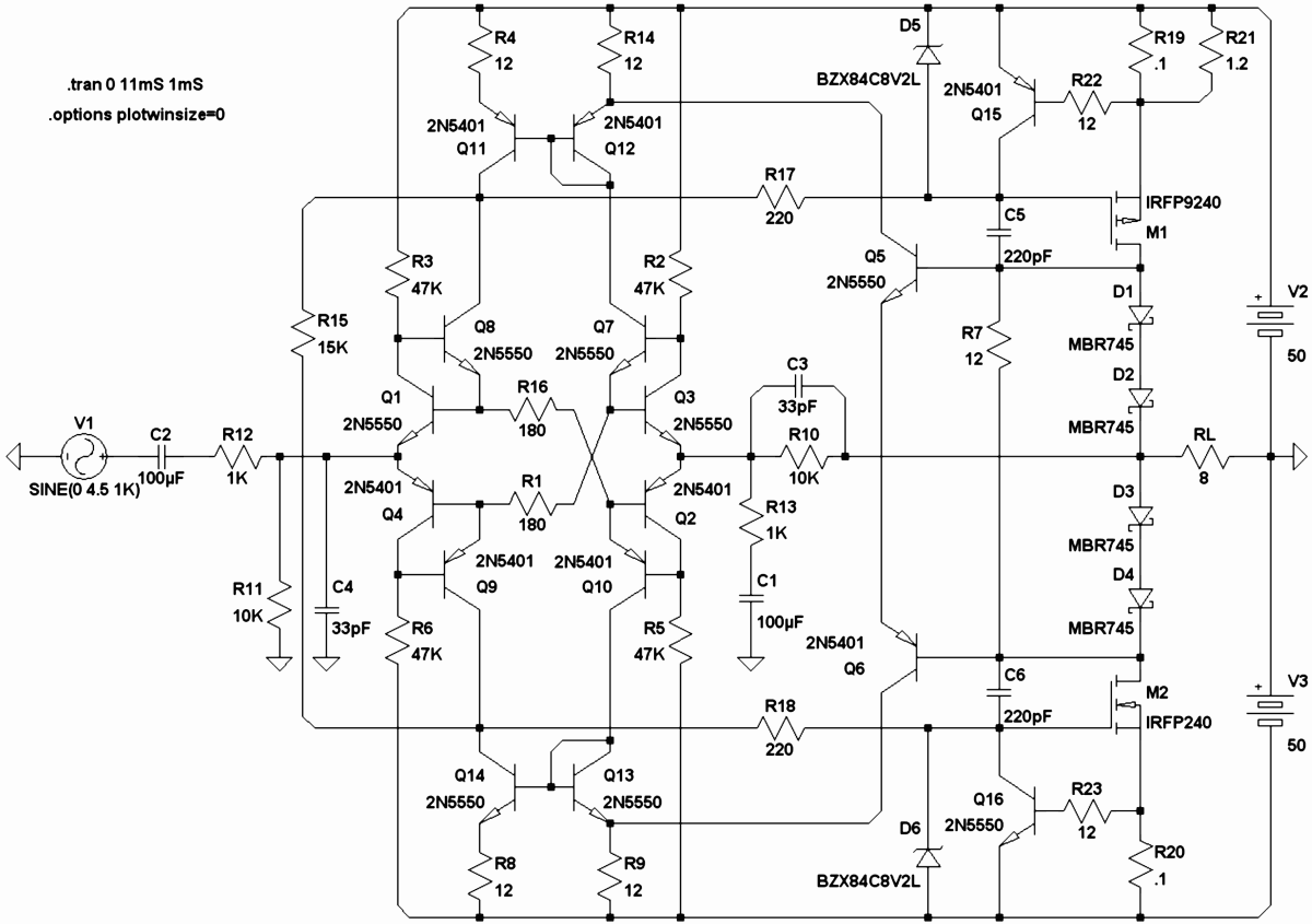

Sim busts into brief random oscillations with or without Zeniers and/or Current limiters.
Doesn't seem to matter what in/out comparator up front, always the same symptom...
I don't think it helps that I wrap CDOM around the component that defines clipping.
I need to define clipping level thresholds up front somewhere, so that errors don't
get stored in the CDOM. Sticking to the rail after clip and all that nonsense... Back
to back pair of 4.7 Zeniers to GND at input emitters is helpful, but doesn't quite fix
everything.
Schottkys across the comparator, surprise to me, don't seem to clip output Voltage.
Instead, they seem to clip the slew rate. I don't got my mind fully wrapped around
how the phase of that style pre-clip got shifted 90deg??? Maybe need to ditch C1?
An alternative is to reference Cdoms at the junction of Q5 and Q6.
Why not try adding local feedback to Q5 and Q6, like the way we traditionally compensate the Allison? Gate resistors on the MOSFETs would strengthen this compensation by adding significant HF impedance to the gate capacitances.
Also, with the current diode biasing I'm sure there is crossover distortion. Probe at Q5/6 emitters and you will see. HF spurs like this tend to aggravate resonances, which can become oscillations (also, try increasing your timestep to a very small value and then see how the oscillation changes - circuits often oscillate sooner when you increase the timestep, due to aliasing and frequency implications of sample times). And just to note, I don't like crossover distortion one bit because the crossover point is very, very hard for an amp to compensate for, and at high frequencies can saturate the compensation (this will be more significant for high-OLG amps), resulting in 20KHz THD death. During this spike the output stage's own gain becomes unreliable, making delicate control impossible for the amplifier.
- keantoken
Local feedback between the emitters of Q5Q6 throws it into worse oscillation.
There is NO significant crossover distortion, believe it or nutz... Like Visch B.
A drop in the bucket of overall THD, which is always my last/least concern
after shaping every other misbehavior one might actually hear. I havn't tried
CDOM on Q5Q6 yet, get back to you on that...
In the meanwhile, chew on this one? I think I got it mostly stable, and upped
BW to at least 96K with only a little rolloff... Clipping is controlled up front, so's
not to store a charge on CDOM. Nor get in a situation where an opposing gate
is finally overdriven into complete cutoff. The cap I added is a bit of a problem
that it tries to shut off the opposite gate in spite of everything, so it needs to
keep some resistance in series.
I had to bump up the power rails, since I didn't have an appropriate Zenier
threshold to clip just below the old 50V rail. I suppose I coulda changed the
gain instead of moving the rail up 5V, but I opted for rail cheat... Whatever...
Why no default Zenier models lower than 4.7, nor between 4.7 and 6.2?
I didn't feel like drawing a big twin stack of Schottkys, which woulda been
the ideal soft pre-clip solution (for fastest recovery) except the parts count.
If I knew anything bout programmin DSP's, I'd see what happens when you
soft clip only the lowest/biggest root note by adding or subtracting musically
relevant harmonics to it. Leaving the rest of the music untouched by IMD.
Like the offending clipped tones each had its own independant MI amplifier.

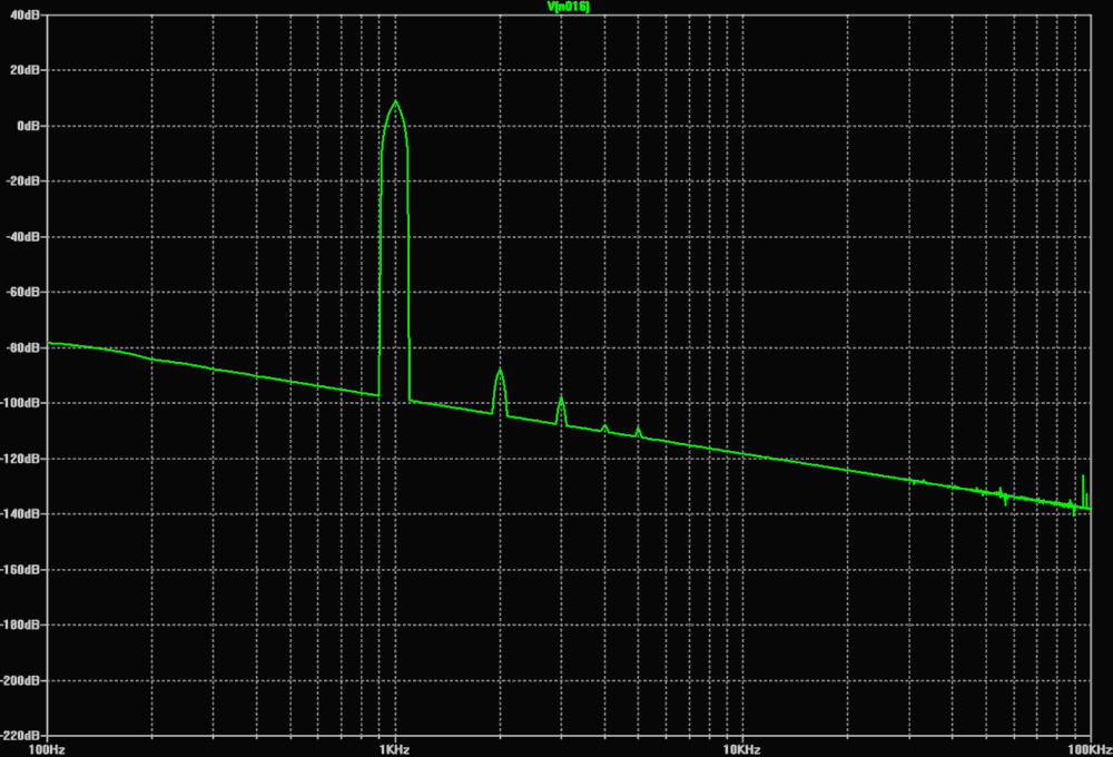

As for terrible horrible diode crossover distortion... This is 1W into 8ohms at 1KHz.
The Schottkys cross about 350mA, the MOSFETs cross about 450mA due to the
100mA always-on reserve current that bypasses both the Schottkys and the load.
I did create a 96KHz dummy loop to trick LTSpice to compute an FFT this smooth.
It wouldn't have looked this clean if it took all the math shortcuts it normally does.
That distortion is taken down by the feedback of the frontend. I won't deny it, things are working very well here.
It looks like a nice amp to me. Is it stable now that you've made an FFT?

Distortion slightly worse, but stability now way way up....
That cross couple comped version was faster, but fights
against Q5 Q6 absolute control of the crossing and never
quite "unconditional" enough to satisfy. It had to go.
I moved CDOMs around several places before deciding this
placement offered the most benefit for least side effects.
And like before, I'm finding a small series resistor along with
CDOM heps the phase not roll too quickly. After all, there is
always some other parasitic phase shift, even if you are far
from the other pole(s).
I'll post up the drawing later. Almost buildable at this point.
I don't have 55V power supplies, so I need to modify a few
things (like the pre-clip) to work better with 24V rails.
