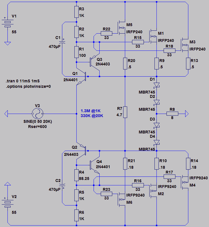

The object of R1 (schematic #583) is a constant current source across VBE Q3.
Resistor across VBE assures Q3 can be turned off anytime, if I wished it so.
Real SCR would not have external access to base of Q3, and can't be turned off.
R7 also assures Q1 could be turned off anytime, if I wished it so. I deleberately
do not allow anything to be turned off. But thats another story, not an SCR...
Your drawing #584 Q3 would latch like SCR as well, without R2 being there.
But you have neglected to use R2 as CCS to increase emitter impedance Q2.
10K? A much smaller resistor across Q3 VBE would slope like 100's of Kohms.
If looking too much like discrete SCR worries, return collector to the other side
of the Allison's voltage gap.
I have a newer version of drawing does exactly that. Plus some Schade from
collector to base of my Q1 (and its compliment) to linearize and nail down error
voltage gain, in the event some error is unfixable. Considerably more stable...

Sounds right to me. Did you notice that your arrangement is eerily similar to that CCS? Except in this case the bias voltage changes to produce output.
BTW, C2 is backwards. 😉

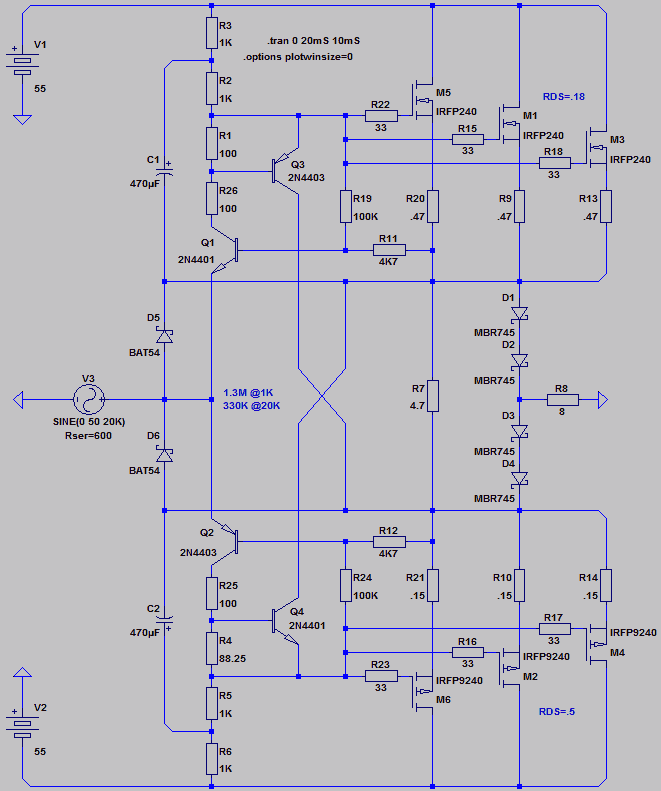

Sanity check feedbacks added.
You right, C2 basakwerdz... I'll fix that next spin.

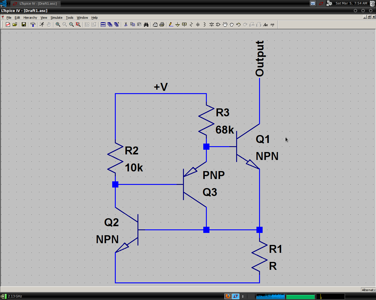

"to that CCS", what ccs or post# we talking bout? You lost me.
----edit----
Oh, #584 "This CCS has a knack for oscillation.", I'm back on page...
I agree, nothing there to keep error voltage gain from going apesh.
Once an unfixable glitch happens, its completely lost its marbles.
Too little voltage on both collectors requires bases saturate, so
probably sluggish. Q2 collector idles at same voltage as its base.
In operation Vce changes very little, and Ic changes are in uA, so I don't think saturation is a big problem. If used in an analogue saw generator with fast enough pulses, a schottkey B-C will decrease recovery time, best to choose high current, low Cj. If you want to increase Vce you can put a diode at Q1's emitter, maybe an LED, or a shorted MOSFET. Or just a resistor to be boring.
In simulation the CCS doesn't show any latching or motorboating, although it does exhibit ringing and often legitimate oscillation.
In describing the CCS I neglected line rejection, which is different from output impedance. Line rejection for this CCS is unfortunately not high because R3 directly injects rail noise into the output current.
- keantoken
- keantoken
One day you will discover for yourself not to run BJT
collectors at or below base voltage in audio circuits.
Unless you have huge amounts of drive both directions,
or speed does not matter.
Even worse in MOSFETs for entirely different physical
reasons. I break this rule, but provide plenty of drive.
Most models won't show you either problem.
