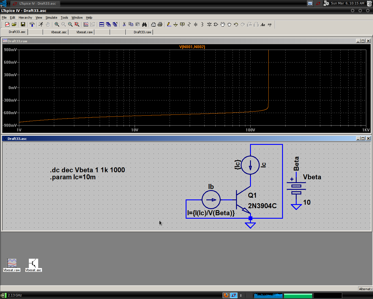

I think saturation is the latter definition, with the first definition not being accurate.
If you look at datasheets, you will readily find the VceSat graph. This will tell you the Vce where Beta falls to 10. I see this as hard saturation, where the transistor begins to stop behaving like a transistor. Another is the Vce-Ic graph, where you can see the Beta of the transistor is roughly dependent on Vce until about 2-4V.
Usually, VceSat is below 10mV for small-signal applications.
Here is a special graph. Bottom axis is Beta, Y axis is Vcb. Beta begins to die at about -300mV. Vcesat for this model was reasonably close to this datasheet, and I haven't had any indications that this is unrealistic.

These all describe saturation by it's symptoms. It seems clear to me that hard saturation is when the B-C junction of a transistor begins to act like a forward-biased diode, ruining the entire behavior of the transistor. When this happens, the recovery time and other time constants in the B-C diode contribute much more to the final operation of the transistor.
"Storage charge" is a fancy term but it doesn't tell us crap about what actually is happening in an electrical sense. It is just charge? Is there a series resistance with the charge? Is it a limit on the speed of electrons? Is it a dynamic impedance in series with the junction capacitance?
I think a dynamic impedance is most likely the case. In the match, it appears that most webpages forget about seeing time constants as impedances and just try to get on with mimicking the curves. As a result, what we see are confusing abstractions we can't relate to. I am sure someone could lay out the math spice model as a set of IV sources, capacitors, and resistors that that would make things very clear. Surely it's already been done, with the most modern models.
Perhaps it is possible to understand by visualizing the junction capacitance. A thicker dielectric (depletion region)=more resistance=larger time constant. Higher voltage transistors need a thicker dielectric, which seems to agree with the Baker Clamp article. But, this means small-signal transistors are fine, right?

Also, as I understand it a diode is considered forward-biased if it has a positive voltage across it, even if this voltage is not enough to turn it on. This may be why they say saturation is when Vcb<0. Just a guess...

If we see the transistor as 2 diodes, then Vce=0 should roughly be where all transistor action stops. I've found that the breakover voltage of the B-C and B-E junctions aren't always the same, so this relationship is not precise.
The text you quoted contains an error I made, I meant to say Vbc. I keep mixing them up!
Your explanations are helping. You seem to be confirming my suspicion that when the B-C diode becomes forward biased, it's recovery time and time constants (not to forget natural diode action) are what degrades the net gain of the transistor, even though the B-E junction is behaving like any normal diode. But this would mean that charge is stored in the B-C junction, not the B-E junction.
So far none of this points to driving small-signal transistors at Vcb=0 as a bad idea, all other things considered.
You say that it's closest to a dynamic capacitor on top of the Vbe junction. Do you mean in series with the base? Parallel to the B-E? Parallel to the B-C?

Kenpeter, I have found that the beta of the Allison transistors is unimportant, as long as they have normal transconductance (the bases are connected to a very low-impedance high-drive node). This is true if you don't use a very large resistor in series with the base for compensation.
Most of us know that transistors are more linear with more than 2V Vce. However I never heard of an abrupt decrease in speed below this. Where do you draw your conclusions from, and where can I read about this?

I can't describe BJT storage time effects much better than I did in post 608. What don't you understand about it?
Rick
Rick
All I know is that it is taking time for electrons to get from here to there. I want to characterize this phenomenon in terms of a dynamic reactive network. This would be meaningful for me and others in the hobby, and help me to know what I need to do to adjust to it.
