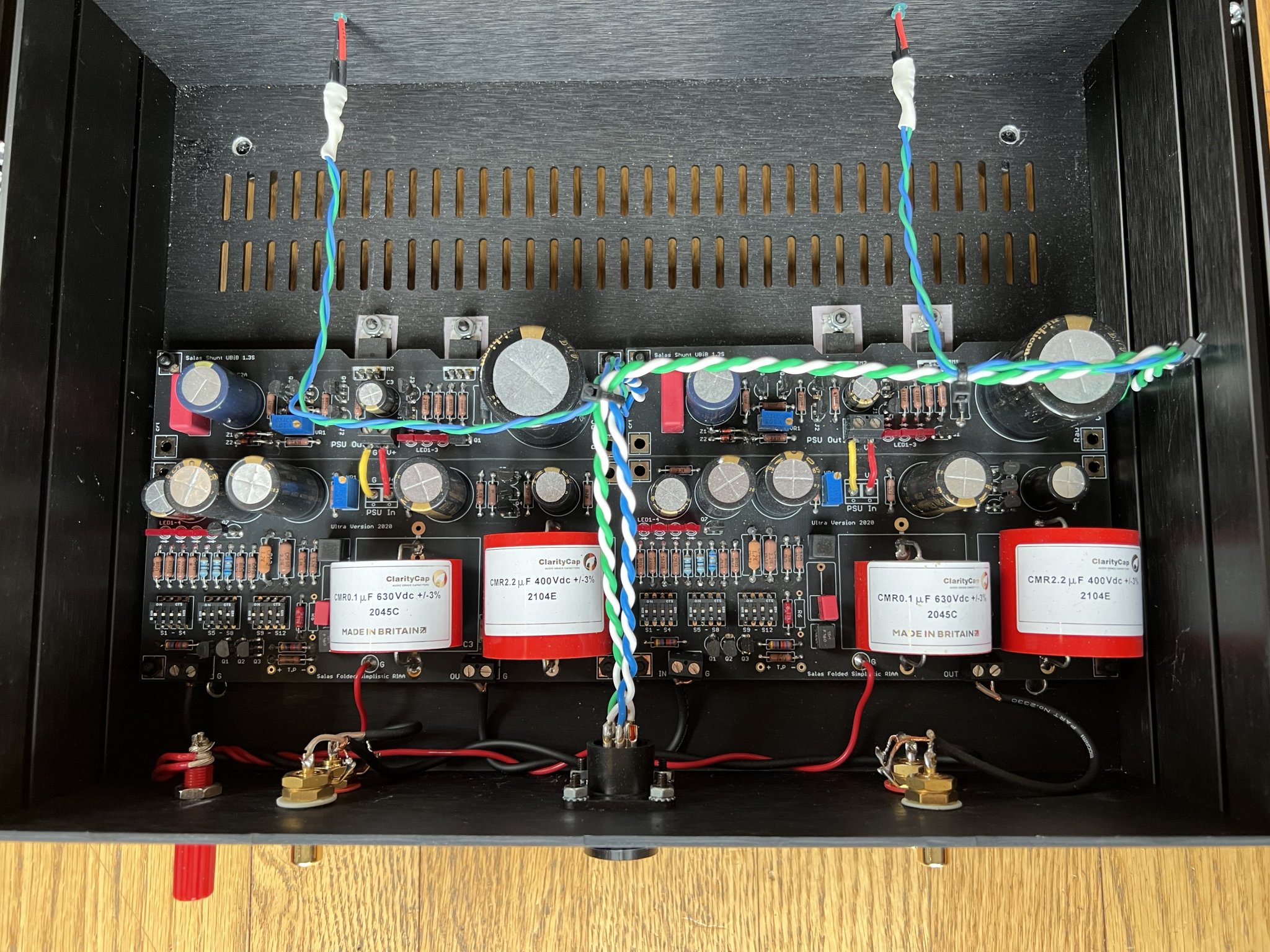

I'm in the final assembly stage for the older version of the Simplistic RIAA phono pre. Where is an appropriate place for connecting the chassis grounding lug for turntable connection?
Edit: I see a via labeled GND on each board...am I running a wire from each board to the grounding lug?

Help! I’m so confused. I have hum.
I built a Ultra FSP a while back. It’s been great and dead quiet.
Last night I finished building some RCA cables and swapped those into my TT and Ufsp….. and suddenly I got a hum.
I tried putting the old cables back in and no matter what I use I have a hum.
There was no hum and everything was dead quiet prior to this cable swap.
When I touch the phono stage chassis and the barrel of any of the rca jacks the hum goes away.
Also is the grounding post for the TT supposed to make contact with the chassis? Mine is insulated from the chassis.
Is there only hum or some music and hum? If its only hum, output stage FETs could have been harmed if it was a hot cable swap. Yes the TT ground lug is better to be in contact with the chassis.
There is music too. The grounding post I used apparently is insulated by design, so I made my own connection to chassis. It’s better… but there is still noise that wasn’t there before
Check with the DMM's continuity buzzer that all chassis panels are in good contact. Let us know drain pin to ground DC measurements for Q5 and Q6.
Just a long shot, but...check your RCA sockets. Maybe they need some tightening on the enclosure after changing cables. I had such an issue in the past with loose RCA sockets. Got them tight again, hum gone.
