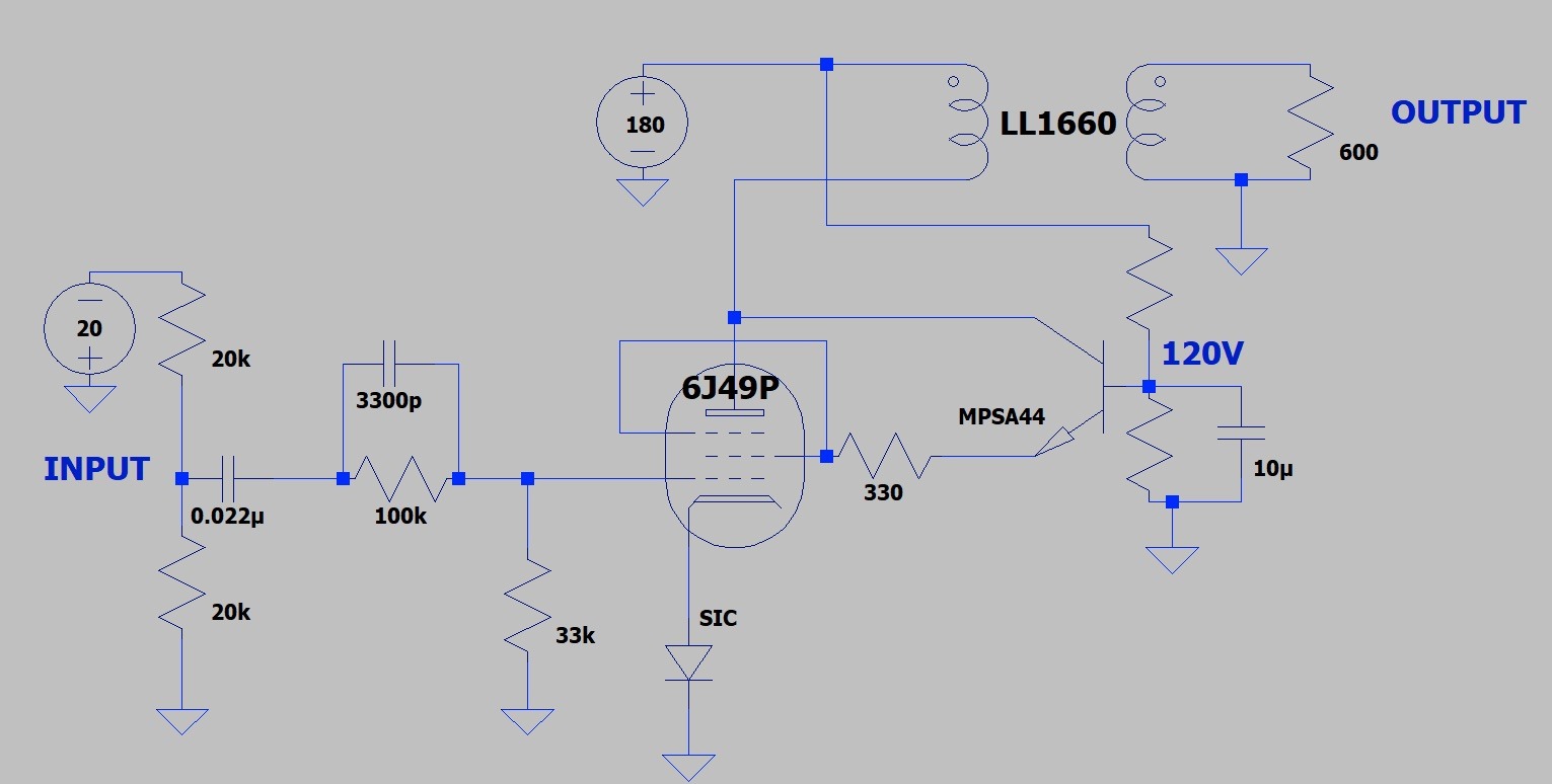

I just modified my tube LCR phono for DS-E1, single best pentode stage of 40X using transformer output (4.5:1), since L/R are out of phase per design.

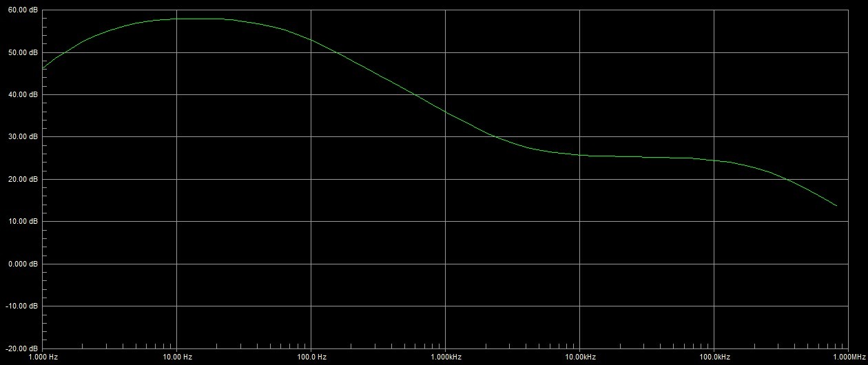

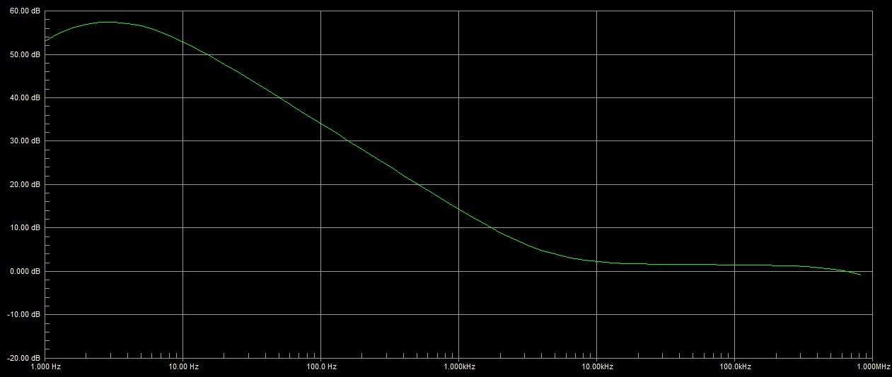

crossposting this here because it's probably better than the group buy thread:
I've collected most of the necessary items and I'm about to start building tape head pre with these boards. Salas had posted some tape head circuits here: https://www.diyaudio.com/community/threads/preamp-for-reel-to-reel.222113/#post-3213006 Those circuits use 2sk170s for the first stage amplification and the ufsp uses 2sk369. Is someone able to calculate the db gain of the tape head circuits so I can set the proper gain in the ufsp? Or, better yet, provide a description on how to calculate the value?
Hi
When using the linked open reel filter networks in the UFSP simulation with switches set for max gain (MC) I got the attached curves. R1 value of those circuits is R4 in UFSP.

There are enough gain steps in the switches to somehow set it near useful amplification levels I guess. Some tweaking is going to eventually be needed anyway because it was a theoretical curves approach back then plus you attempt to migrate it over to another alike but not same config. Good luck and let us know the outcome.
