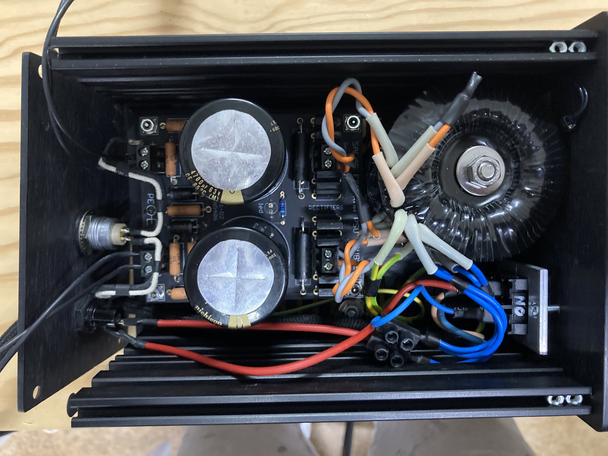

RAW PSU almost done...
Do the transformer shield (yellow-green wire) connect directly to the PE, together with the PSU?
Thank you!
Thank you!
Static shield cable goes directly to the mains protective earth connection together with the rest on a chassis bolt with safety grommet, yes.

Though now you got me confused—is it the classic way, aka
PE - chassis-bolt (as star ground) - raw-PSU-earth+static shield?
(The PE-symbol on the rawpsu-board got me, made me want to connect it directly to mains PE...)
