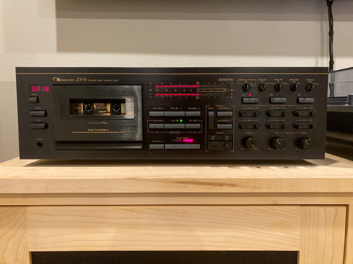

By the way, do I see a Nakamichi cassette deck's side panel at the left of your third photo? Possibly RX auto reverse series.

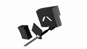

I have been thinking about getting a DS 003 optical cartridge. It has a 70mV output. The cartridge has really good write ups and is neutral which I like. Is the FSP adaptable to that output. I love my system sound. SP10, EPA tonearm, AT PTG33/2 cartridge, FSP, DCG3, M2x Monoblocks with Norwood and Monkey Tower Speakers. I would very much like to change the cartridge only.

The optical cartridge needs it's own dedicated phonostage. Any 'normal' phonostage is incompatible.
The DS optical cart and the DS compatible phonostage is $6k for the set. That money could buy a LOT of experimenting with other cartridges, even expensive ones...

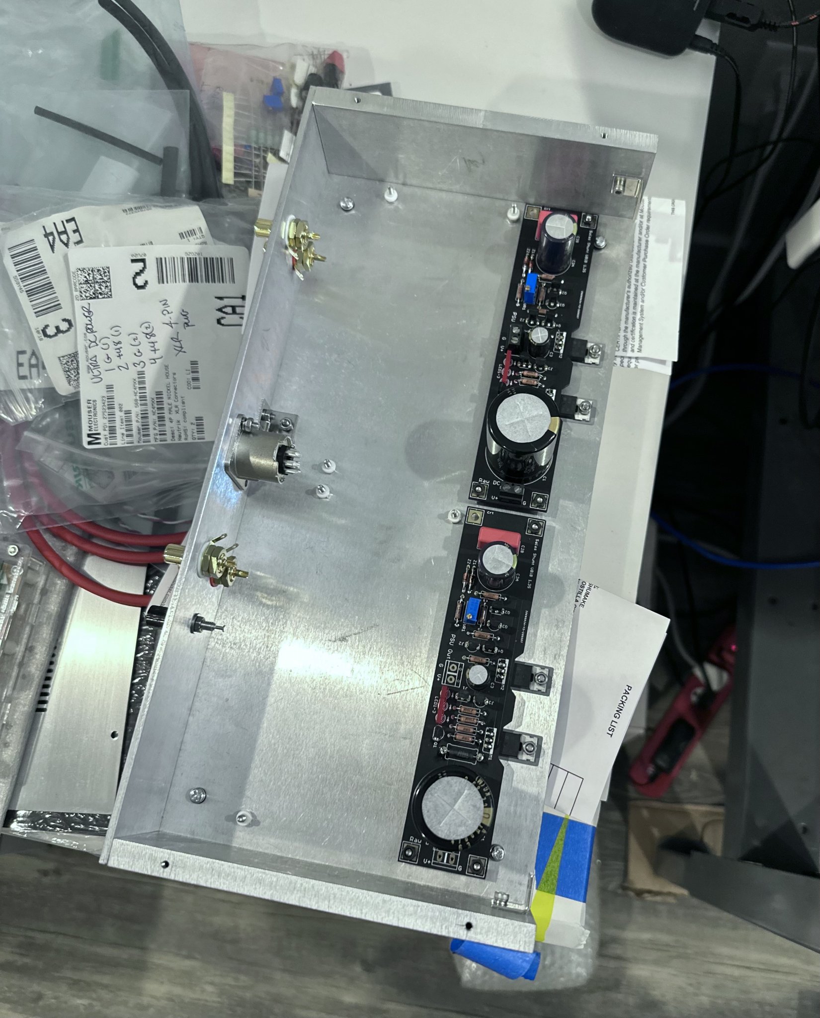

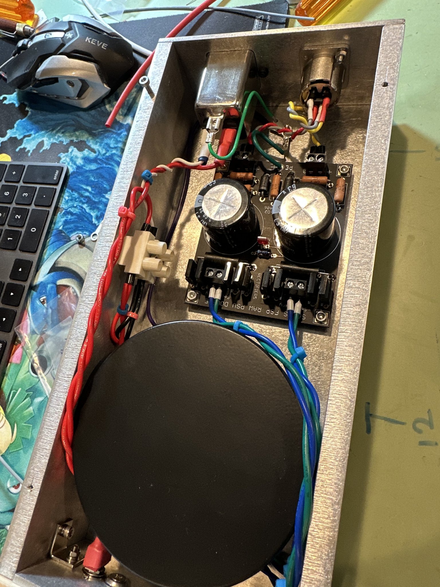

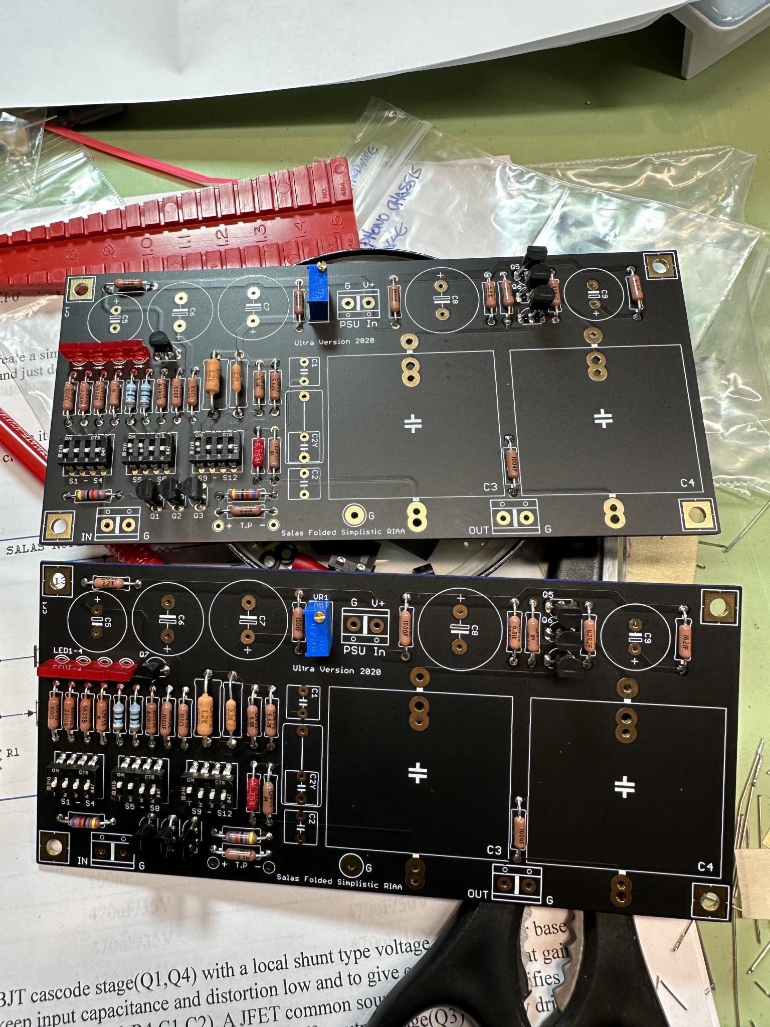

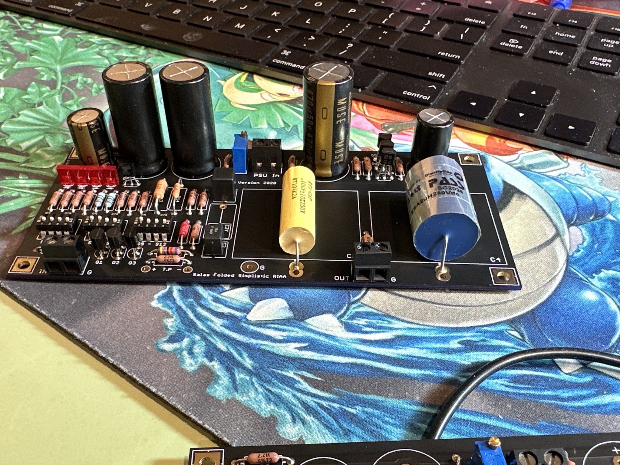

Some progress. PSU is done, RIAA chassis to be wired today.
Chassis by @pfarrell , I was lucky enough to to talk him into building me one at the same time he made his, it’s absolutely wonderful, thank you.

Antek transformer‘s smallest with a shield is 50VA. What you are seeing on the outside is the Antek can for the 50VA. Yes, it looks huge.
what whould we do without the looks…
(Those pots, haha)
Curious about the proportions of the closed boxes. Very nice already!
