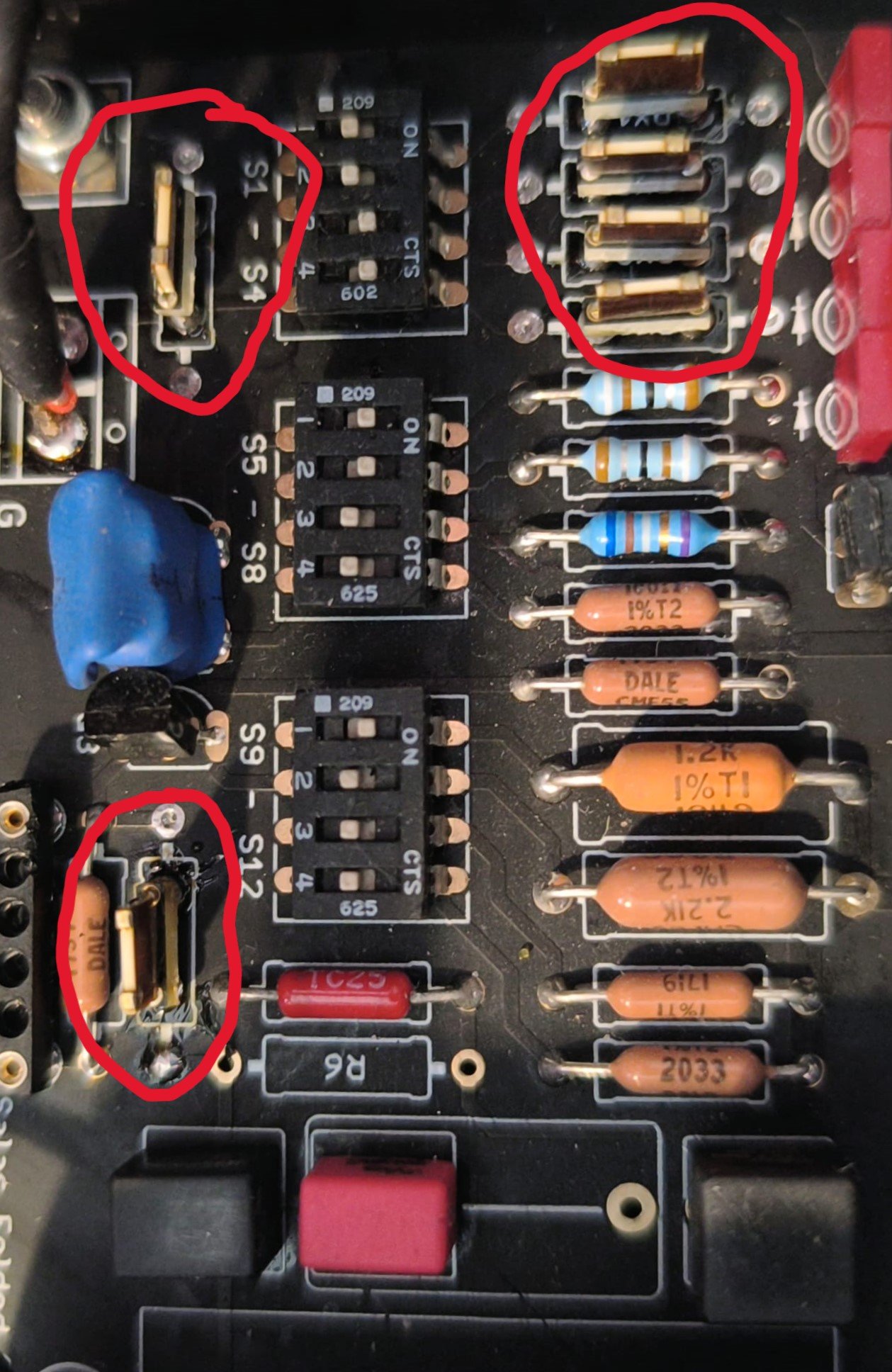

Hi everyone. I have a question about the signal path resistors. I have the notion to mount signal resistors flush to the board, while leaving the others some gap to dissipate heat.
If that is a good way to approach it, am I correct that all rhe signal path resistor are R1, R2, R3, R4, R5, R8, R10, R11, R12, R13, R14, R15, R21, and R22?

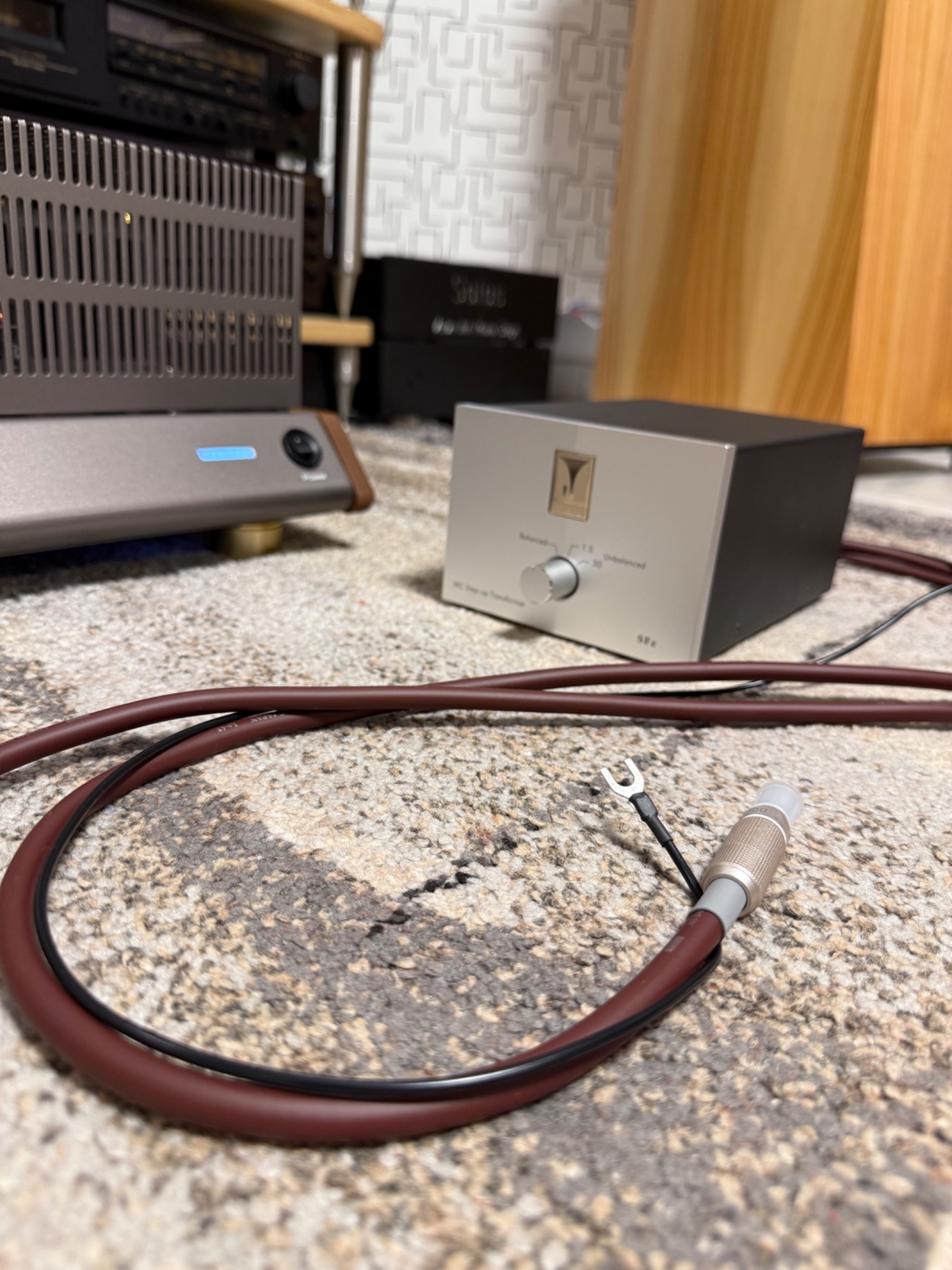

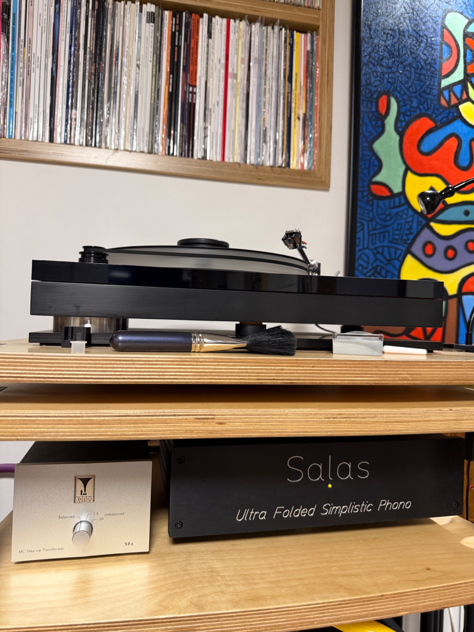

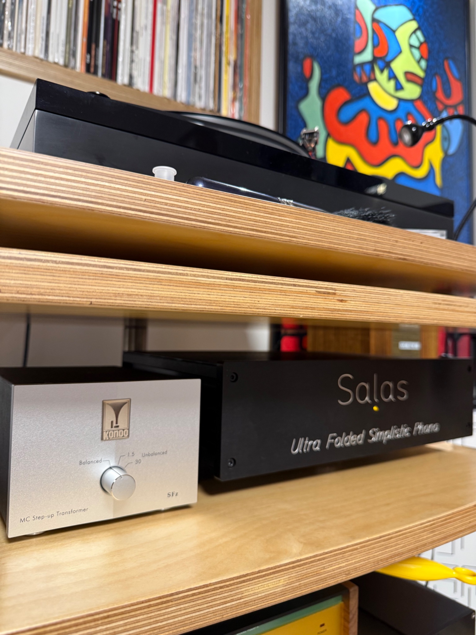

Ufsp is really special,so I decided to explore how it sounds with a very good step up transformer in front of it.so,I decided to go the Japanese way with Kondo audio note SFz,which is adjustable to 34 and 20 db gain.My cartridge is Dynavector xv1t,which is 24 ohms with 0,35mv output.long story short,amazing combination.it seems I haven’t met ufsp ‘s limits,after so many years,still surprises me.A big Bravo to Salas.

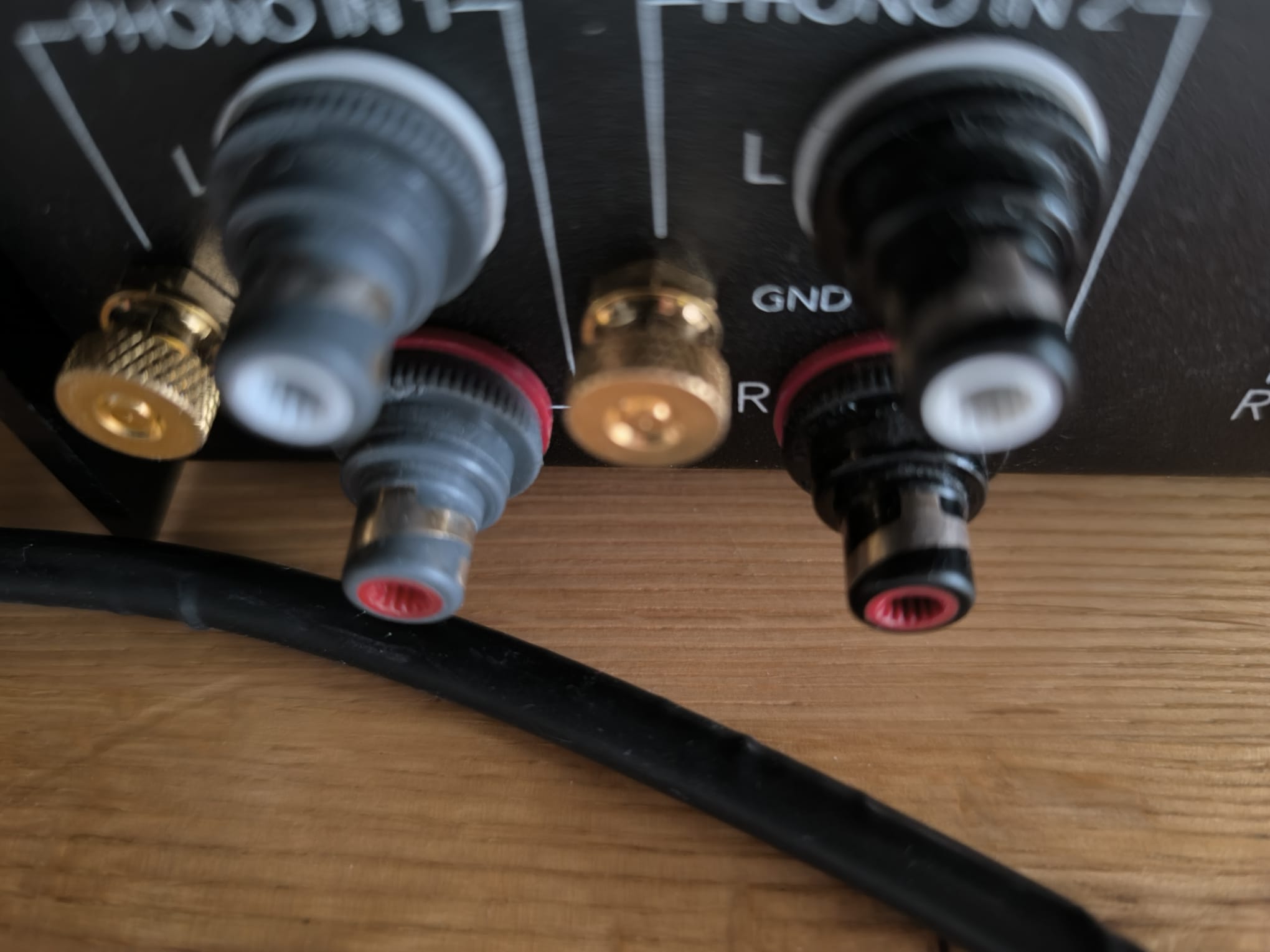

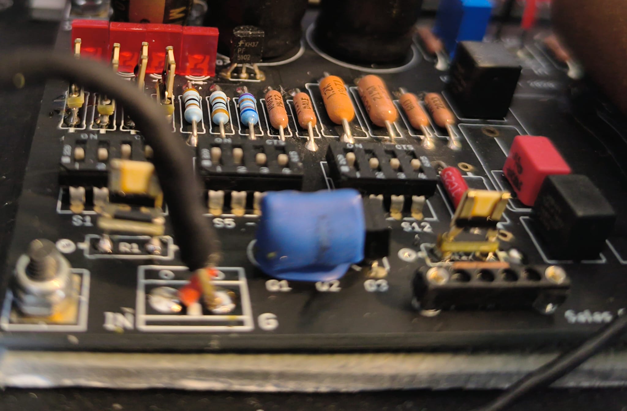

Hello fellow diyers, I want to start building the Salas Folded Simplistic RIAA boards that came from the GB in May 2020. Is there a guide for the special UBiB 1.3s shunt regulator? I've been looking for a couple of hours now and hope for help here.
Specifically I don't know if the LED string needs matching to a certain value and same for the three PF5102 JFETs.
Cheers
Hi, those 270R source pin resistors degenerate the PF5102 JFETs enough to guarantee low mA bias. How many mA can be judged by mV/270 across those resistors legs. Its not critical to be matched per position but if you like you can measure IDSS and put closer ones to same positions of the two regs. No need to match the LEDs, they are there just to drop some voltage for J1's safety and to indicate there's operation.
