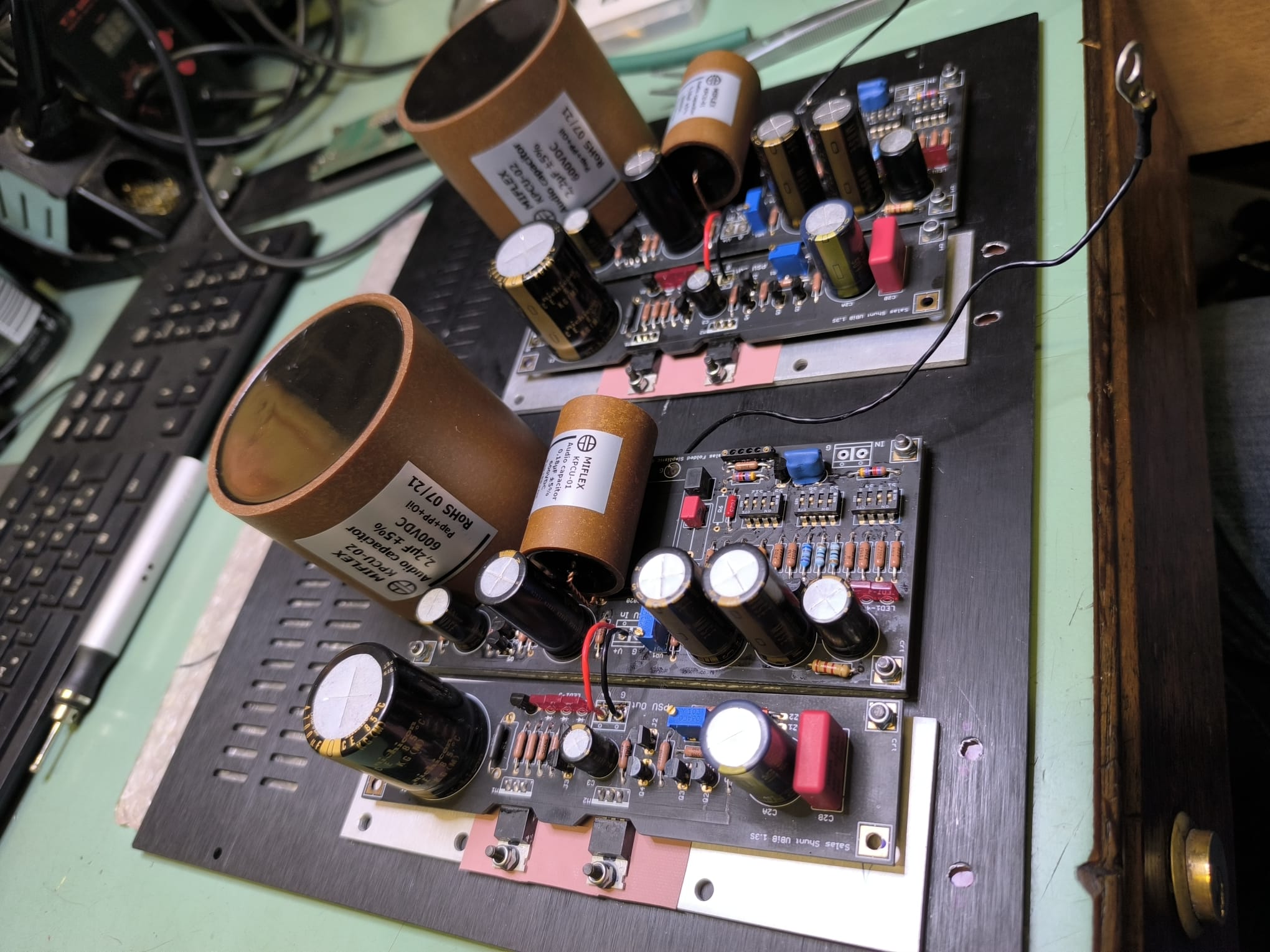

Without getting into a war ... If the part doesn't fit, do not use it.
I'll be honest with everyone. The best parts are typically not "audiophile approved". In fact, they are normally modestly priced compared to audiophile parts, and they are smaller. Simple, industry parts and there are some types much better than others. It comes down to materials and construction.
You want to install audio fashion, go for it. Just don't wreck anything shoehorning parts in that don't fit.

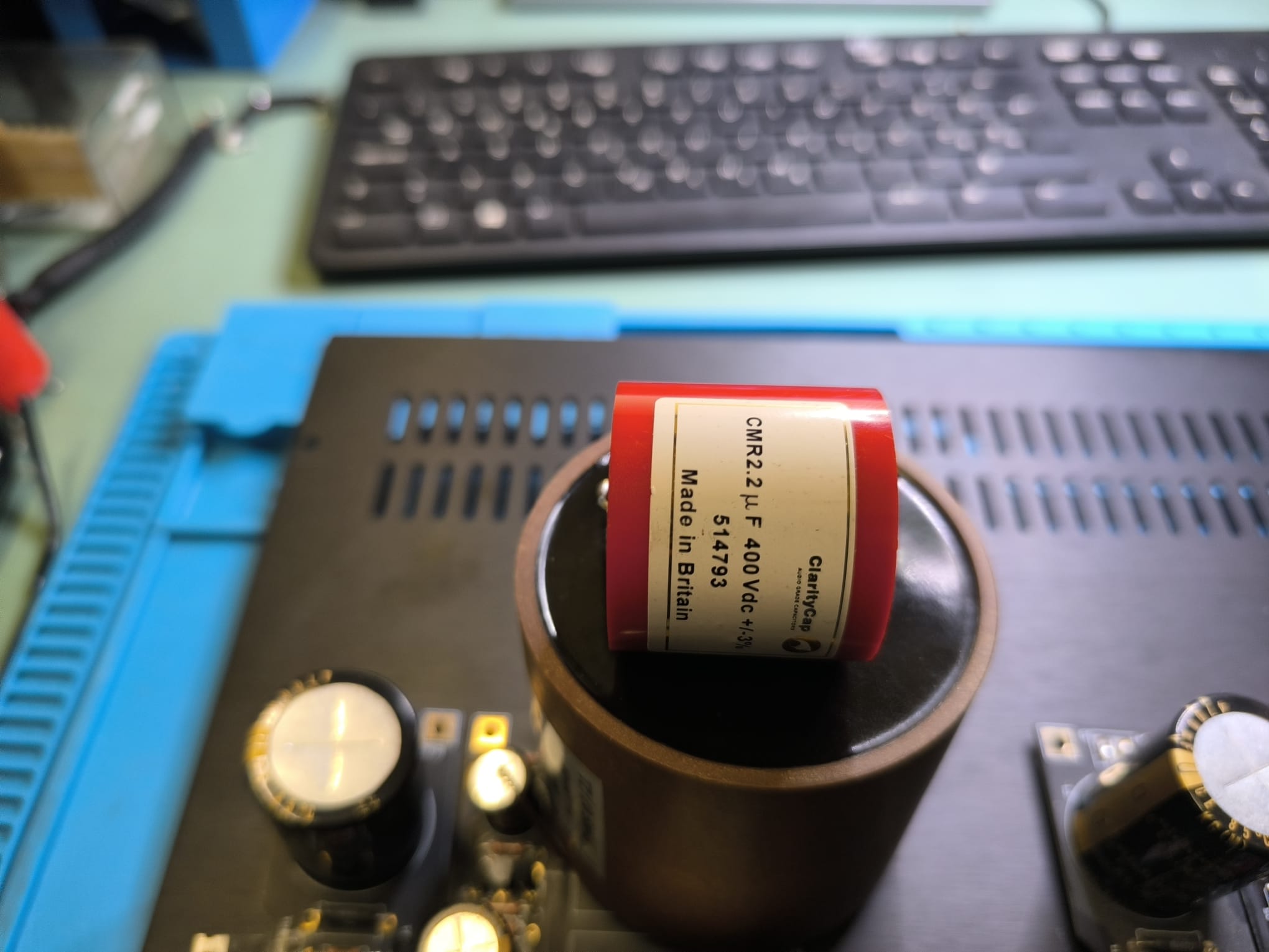

I would expect that Nick when did his final listening tests of UFSP had the Clarity CMRs on. For starters go for that. And Clarity is not a cottage manufacturer and yet many audiophiles praise them. I think that even Miflex did start as industrial manufacturer, a polish could enlighten us.
Yes, I had a CMR and I think he could have stayed in his position but....

maybe like this...:scratch2:
The UFSP pcb has 5 holes for the cap, make another pcb yourself that it's pins goes into the 3 holes. This handmade pcb will be used for the cap to stand on it. Then solder both 3 pcb pins and the two cap wires into UFSP pcb 5 holes.
That way it would be rigid.
Edit: make sure that the pins are firmly stuck into this handmade pcb, so make the hole smaller at first and then force them into place. Also make sure that the pins won't hurt the cap into the other (top) side.

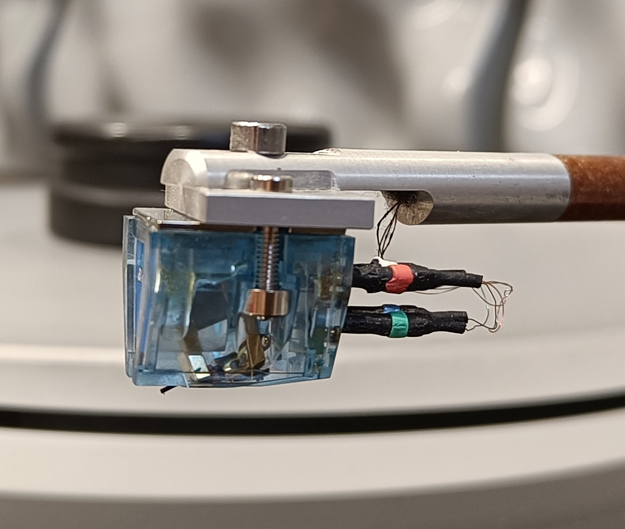

Thanks to you and Salas, I'm bringing this project to a close. I used an Mcap supreme classic in position C3, but after 200 hours I'm giving up on it. I hope the Miflex will bring a little more meat. The Phono cartridge I have (EMT HSD 006) is very dynamic and quite rough in expression, so this way I balance the overall sound.
Proper gain setting vs cart output is always important. 1mV is an output class of MC carts of not too many members. Should sound dynamic at 56dB. Although 53dB would generally be sufficient.
At your EMT's price bracket I also like the ZYX R50 Exceed 0.48mV 8Ω version. Was listening to one today. Nice flow and openess but not insubstantial or cold.

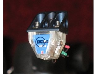

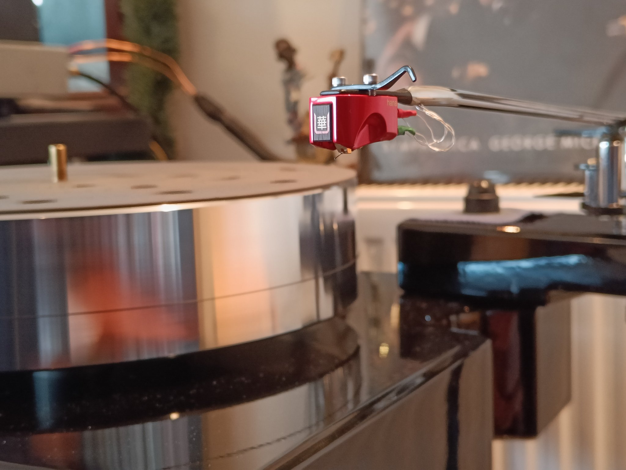

I found this on the Kuzma website
The KC 1-4 were ZYX OEM cartridges, from 2005 to 2008.
The designer obviously thought they sounded great on his turntables.
I forgot to mention that I have his turntable
