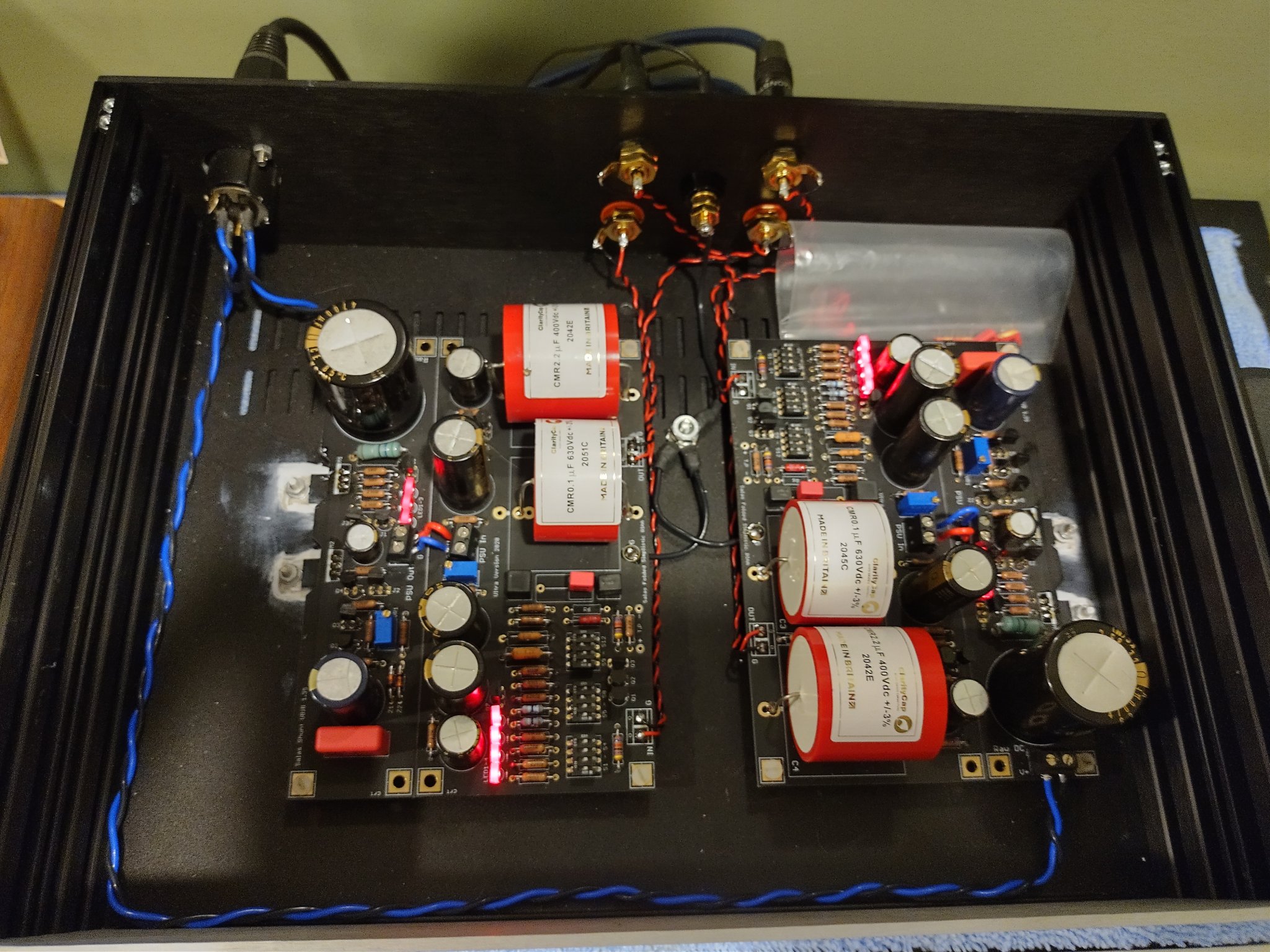

Ready to set my switches, power up and give it a spin. On the switches, they appear to be positioned as they came set to "on." At least they are pushed up, and on that side either the word ON, or else upside down is NO! Can't imagine that's the case so am I correct in pushing them down (away from ON) to turn OFF?

With switches set, had to turn voltage back up to 31 volts, as it should be! Phone board steady at 3.98.
Still hooked up to Variac, will undo that and reset when straight wall voltage applied.

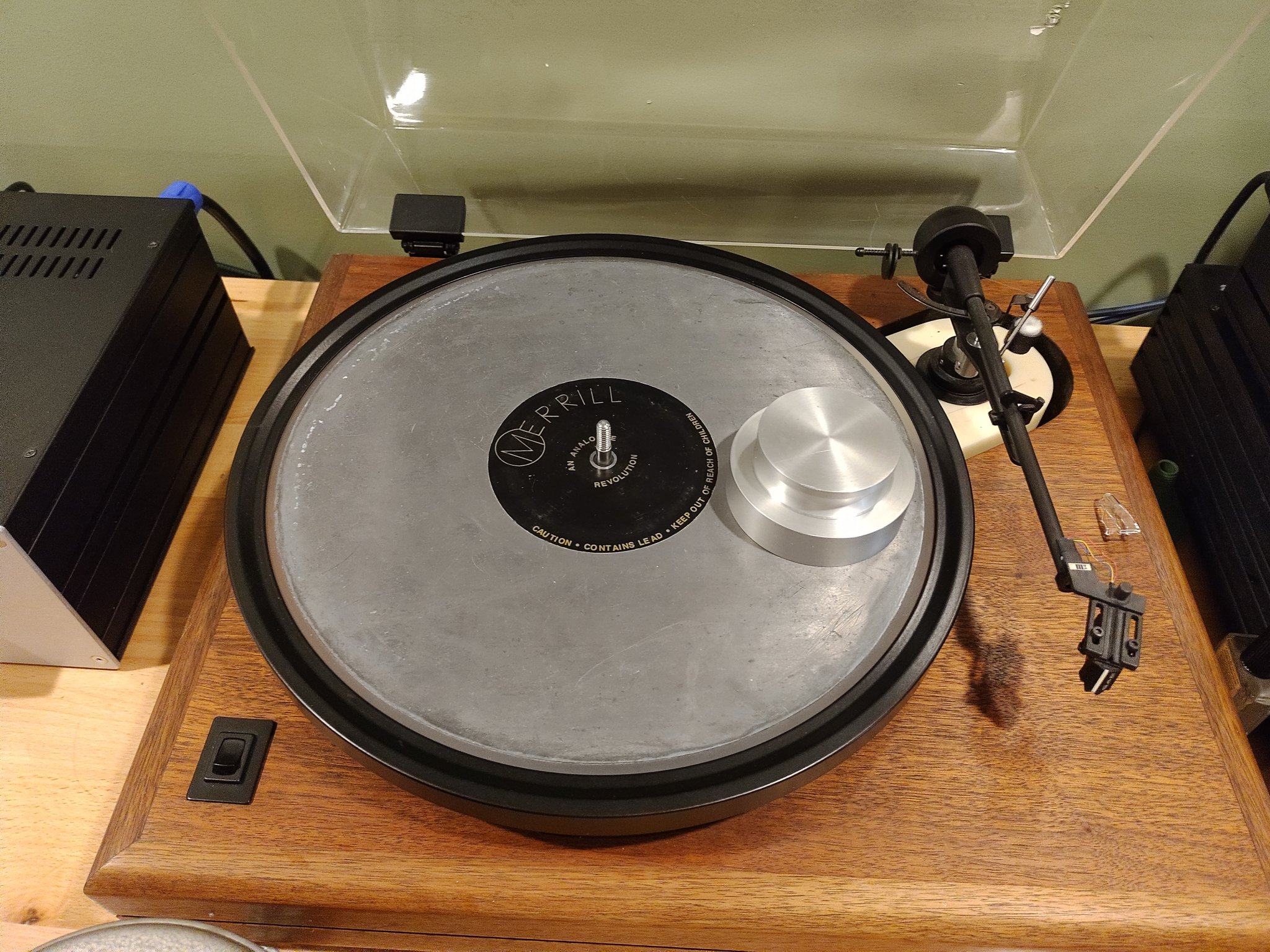

Rig is an AR The Turntable, but all that's left is the wood and top plate of the original. The rest, replaced with Merrill mods, springs, subchassis, spindle, platter, inner platter all delron. Weight, perimeter weight, etc.
Arm is a Magnepan Unitrac, cart is SAE lt 1000.

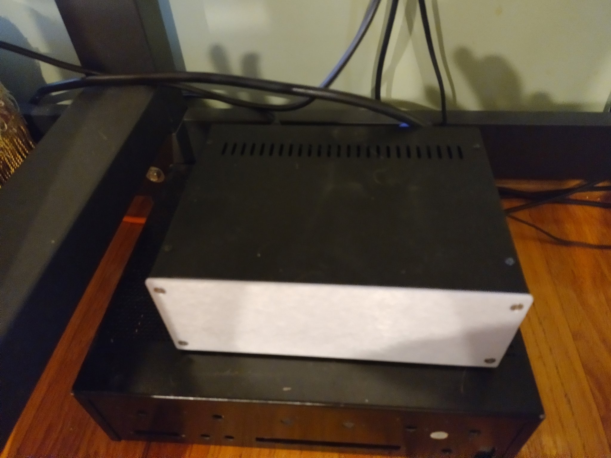

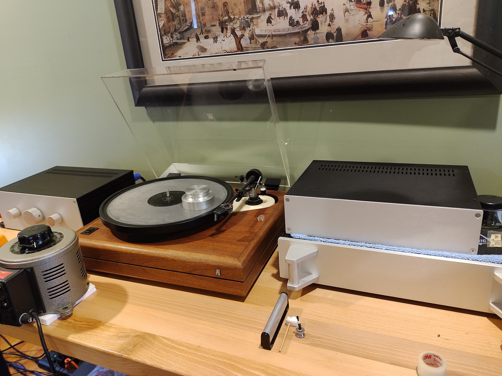

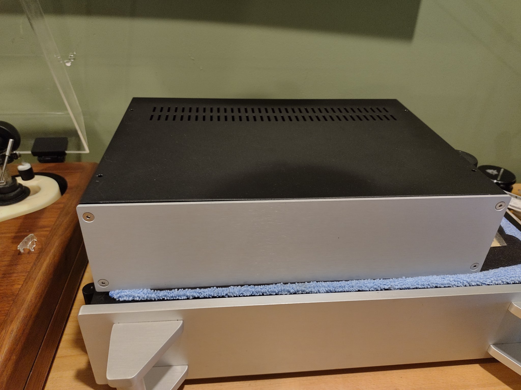

A few pics. Smaller box is power supply. In fact, it's sitting on top of my Pass diy Pearl 2 power supply.

I set them as you advised, 47k, switches off, i believe it was 7 and 11 on, rest off. It seems to still be settling in, or I'm getting used to it, but I want it to settle down. My tonearm can set VTA on the fly, but not messing yet. Now high end is sounding hotter with Steve Winwoods "Live from the Canteen", not as heavy vinyl as the Jah Wobble album is, so probably shifted VTA a smidge. A bit more tail up could be in order.
As it warms, T measurments drop a little, setting them closer to 4.00 but, when turned off and later turned back on, they measure 4.16 or so until a few minutes pass, then settles back down. Is this temporary excursion over 4.0 harmless, or should I reduce initial voltage to prevent temporary overage? I figure its harmless but will ask in abundance of caution.
