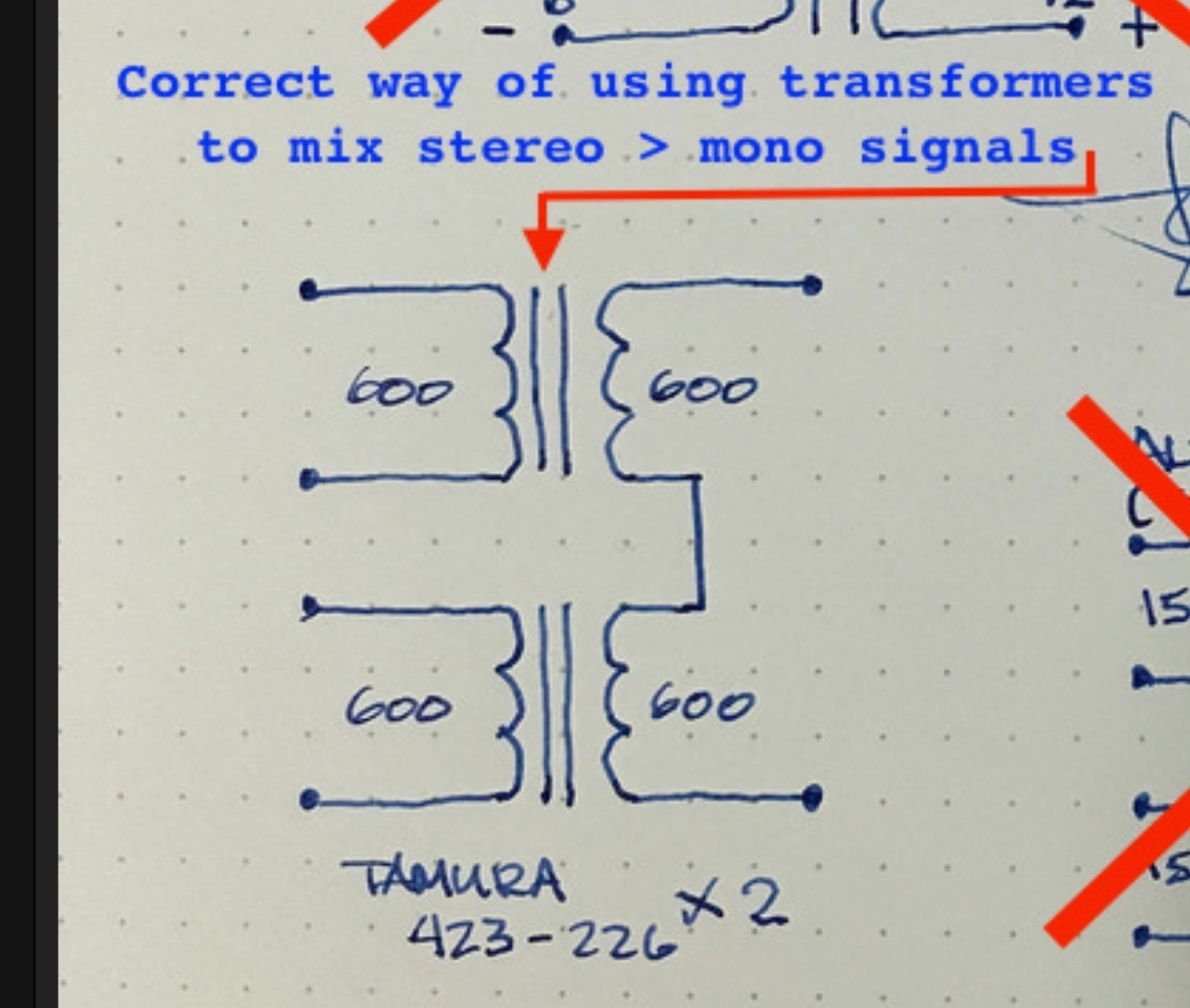

If that transformer can deal with line level signal, yes after the UFSP is better to locate. Another way of summing stereo to mono is with resistors of course.

I see different schematics & resistors values som 1K and some 470R also some with 3rd resistor, could you share wich one is the correct, TIA?If that transformer can deal with line level signal, yes after the UFSP is better to locate. Another way of summing stereo to mono is with resistors of course.
