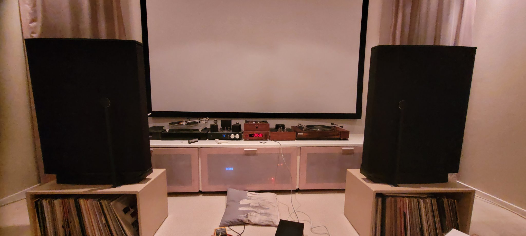

But let us know how you liked it as it is in your last picture first. With what cart and turntable etc.

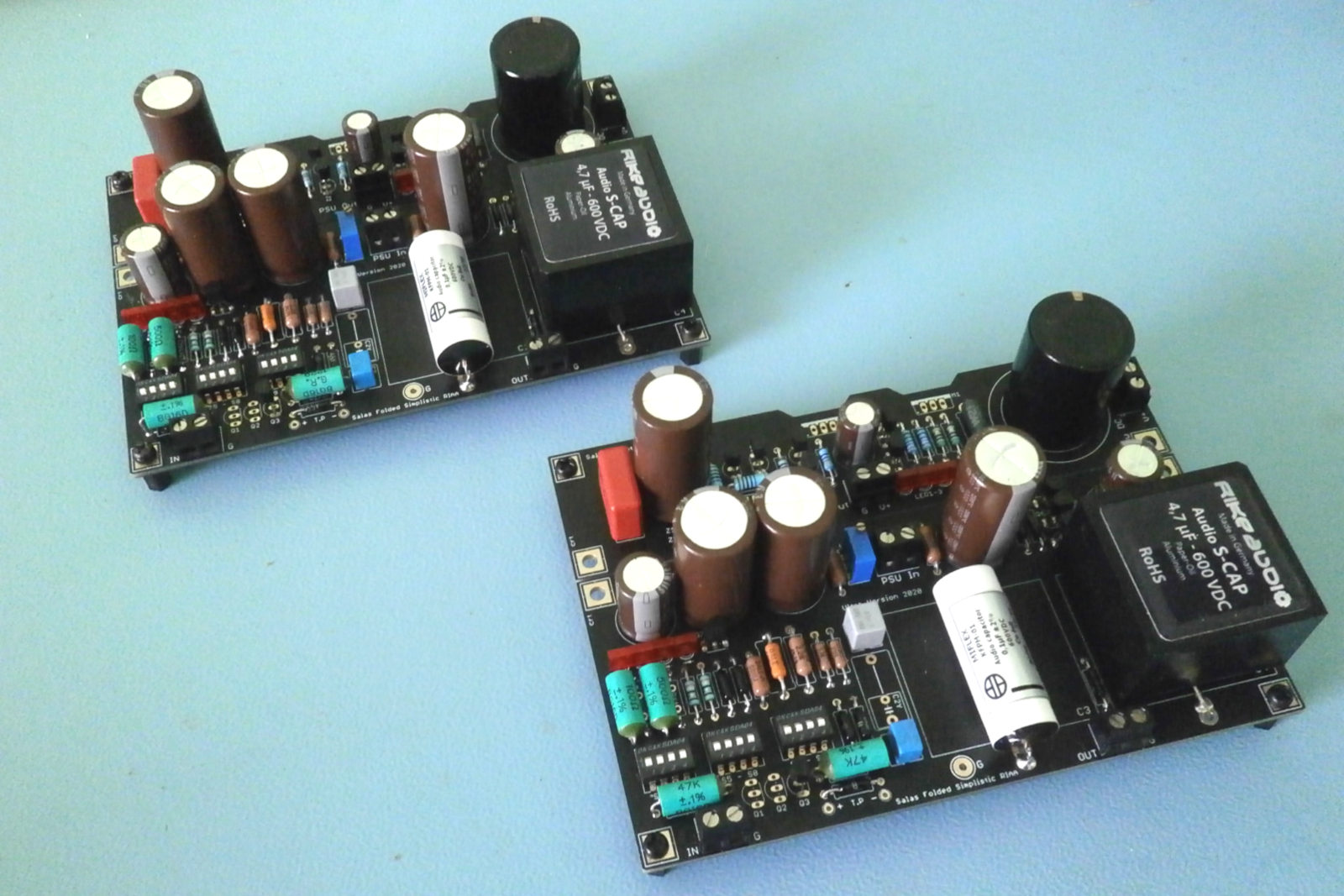

Wow is my first impression!
Sounds great, and is so quiet. I went for the 55-56 dB gain.
Gear:
Lenco L78 with separate arm base fitted with a Grace 707 tonearm and a Sumiko point special evo iii MC.
Or (I have implemented 2 inputs)
Clear Audio entry level TT (forgot the name) with Clear Audio Virtuoso cartridge MM.
I'm listening to the the CLEAR Audio as I write this.
Rest of the system is a Tram w.o.t preamp, First Watt F5Turbo monoblocks and Quad ELS 63.

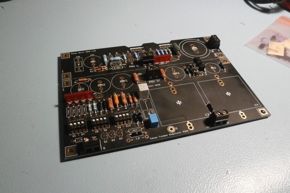

Thank you for the advice. I have repowered the power supply, measured it at plug terminals on chassis mount xlr jacks in phono unit, all still measures as before on both sides of Raw power supply.
Next, hook up shunt, set to starting voltage, then to phono board for final adjustments.

I have two matched PF5102 and 5 unmatched. I need one extra PF5102 and you know the story
I do have the previous 2sk117 (and few extras 2sk170) but I think the circuit is optimized for PF5102 (having the voltage drop leds).
Anyone in EU having a spare ?

Q7s don't have source pin degeneration resistors so 2SK117s will go G+S shorted in the specific PCB spot as much as PF5102s no matter the DGS vs DSG difference in pin order between the two types. All you need is two close enough IDSS JFETs. +/-10% is OK. This Toshiba type is excellent for the purpose of constant current feeding the four Vref LEDs as well, no worries.

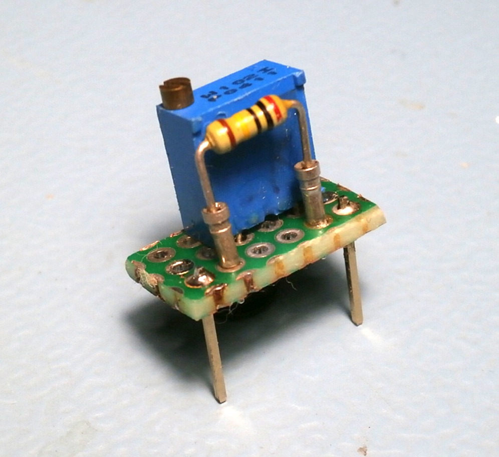

Thanks, almost done now, placing those Rhopoints was time consuming. I have to make a small pcb for the trimmer, I used my 10K for another project and left you only 1Ks so I'm putting a resistor in series.

Interesting alternative parts except Rhopoint resistors I see, like a Miflex KFPM interstage and that Rike Audio rectangular output capacitor.
Your 1k UBiB trimmer when missing the full spec 10k will naturally narrow the adjustable rail range. Let's hope it will allow enough critical range to set T.P.
2200uF local input reservoir on the UBiB shunt will still work for noise spec. When missing the 4700uF BOM cap can possibly differentiate the tone somewhat but not crucially so.
Rike's is Aluminium foil in PIO while Miflex is Copper foil in Polypropylene
I'm gonna put the resistor in a base so I can easily change it, hopefully it will do the trick
