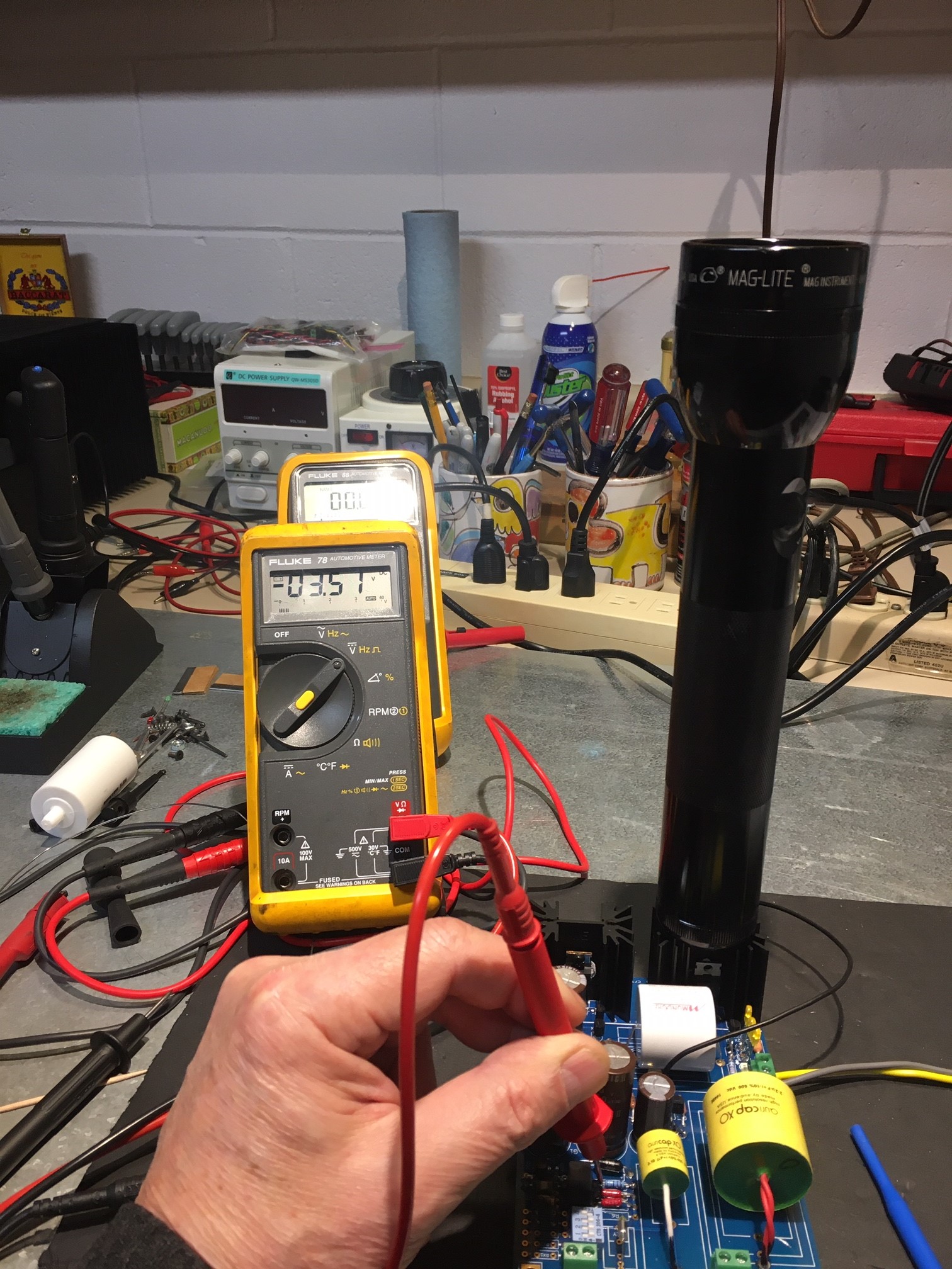

I'm not sure why, if I apply pressure to the heat sink for Q1x, I'm able to adjust TP1 - TP2. The volt meter in the picture shows -3.59vdc, I have the probs reversed. When I apply pressure to the TP2 pad or twist the PCB, the reading changes either to 0.00 or 6.xx vdc and may eventually go back to 3.59 vdc. I've been re-soldering every connection and part on the board with no perfect results, it is better, meaning that I'm measuring 3.60 vdc more than not. I've tried wiggling parts, moving transistors, I even unbolted Q1x from the heat sink.
I'm going to spend time with an ohm meter checking traces.
Could it be a bad capacitor somewhere?
Bad cap or a bad joint comes to mind. Did you use ROHS solder? Such alloys need extra heat and don't flow too well. Also inspect for cracks near the plated holes. Especially inspect/redo joints of C8 Q1 Q3 R2 R13. Check if Q1's sink had scratched the solder mask somewhere and closes circuit with some lane that it shouldn't.
I'm using Kester 44 solder from a spool I won in 1971, small desk fan was added just after that. I'll check the pads and areas you recommended first. I'm not positive that pressure/twist of the PCB is the reason for correct voltage at TP1 - TP2. I may make a jig to mount the PCB so I can spin without twist, with a Known Good Channel (KCG), I have a reference to use for voltage checks.

I inspected the PCB at C8, Q1, Q3, R2, and R13 as per your suggestion. NDF
I have had the "bad" channel operating off the power supply for the past week.
Symptoms are not as severe, seems like it was getting better, except when I would touch the heat sinks for Q1x and Q6x, then the TP1 - TP2 voltage would vary by +- 1 vdc.
I received my order from Mouser with the 33 ohm resistors for the LINK positions in the power supply. I removed the jumpers and soldered the 33 ohm resistors in place.
The unloaded power supply is now 49.5vdc for each channel.
I hooked up the "bad" channel and I now have the following:
RAIL + = 33.75 vdc
TP1 - TP2 = 3.60 vdc
Dead stable, easy to adjust, no more variations of TP1 - TP2 voltages whenever I touch heat sinks, PCB or anything else!
I'll continue to test the rest of this week, however, everything looks great now!
Thank you again for all your help, I'll post if anything changes.
