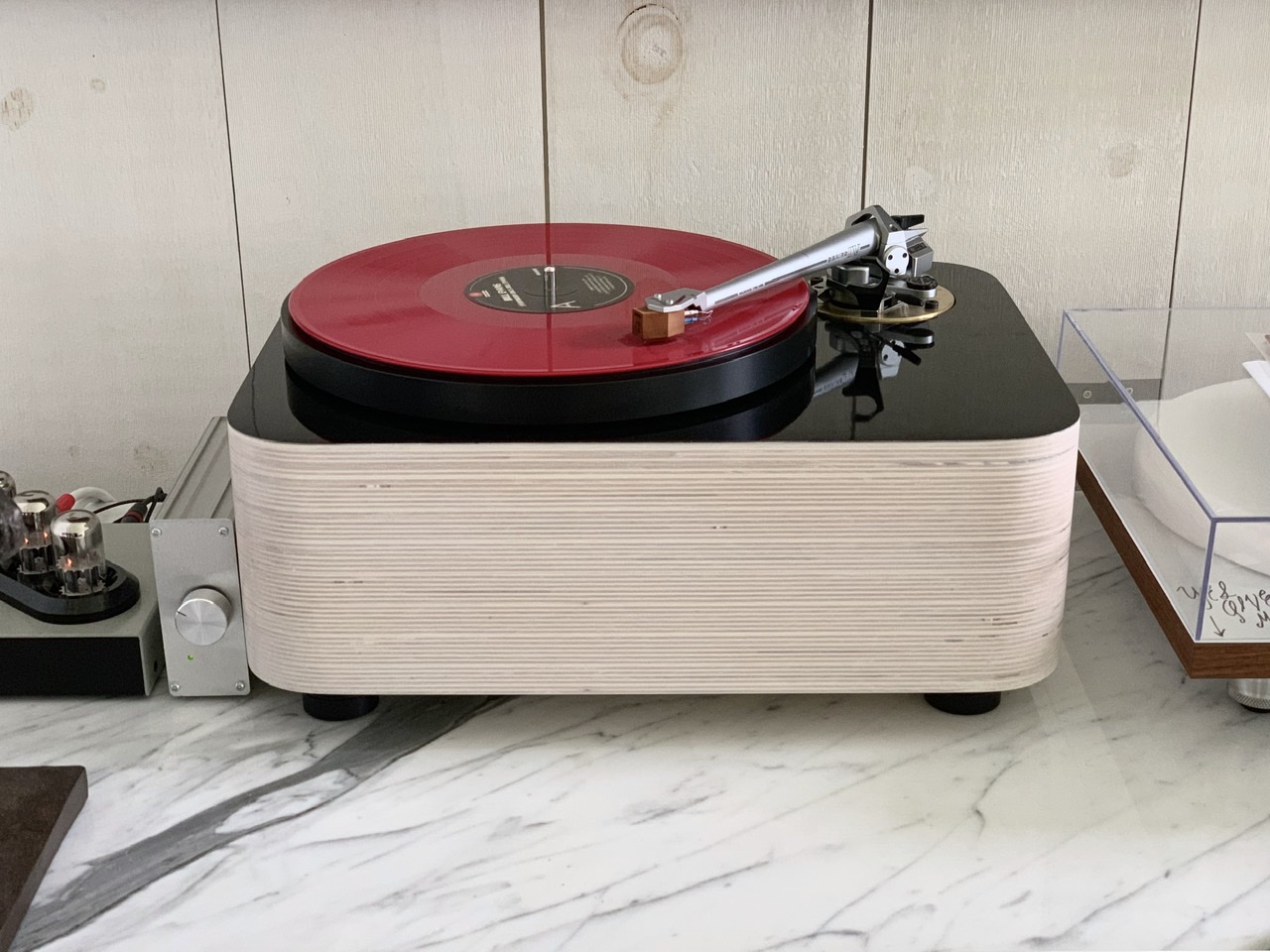

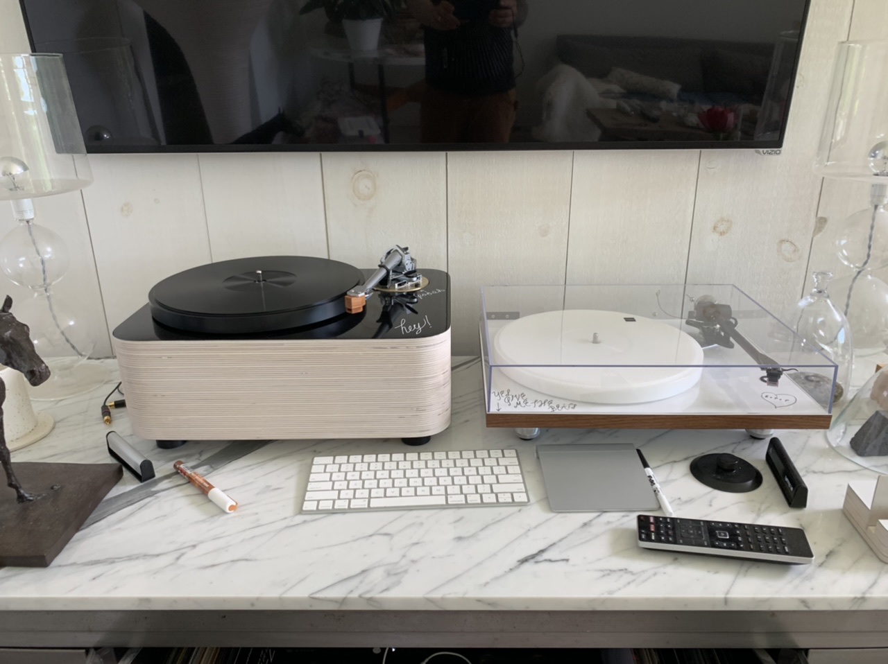

That is the 2nd time one of those has been built at my house and the 2nd time I’ve genuinely been sad when a component has left.
Beautiful faceplates by Patrick, very, very nice work overall, and of course the Salas Folded is absolutely incredible.
Had a wonderful time hosting, a fantastic weekend, thanks for coming out!!

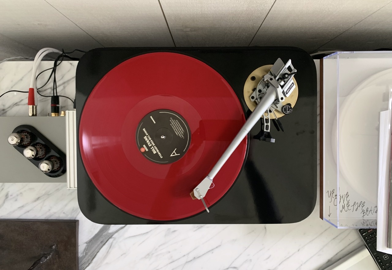

It’s going to be selector between MM input and MC input that will have CineMag transformer. 🙂 Didn’t have time to get them installed.
It looks very well done. Congratulations. Is it set as MM with an extra input selector?
Thanks!
It is set as MM. Plan is to roll some Cinemag SUTs in the back there by the switch. Waiting for them to arrive. All my current carts are MM/MI, but I want an audio education and options (MC)!
@pfarrell
With what TT & cart you listen to it as for now?
Currently 2 tables I built. “Beast” was a mass experiment, belt drive DC motor.. the low one I built first, Rega inspired with their AC motor and controller. Both have the opposite ends of the Grado woodbodies HO line. Also have an AT 540ML about. And picked up a Black Widow with an ADC XLM mkII improved for it to play with.

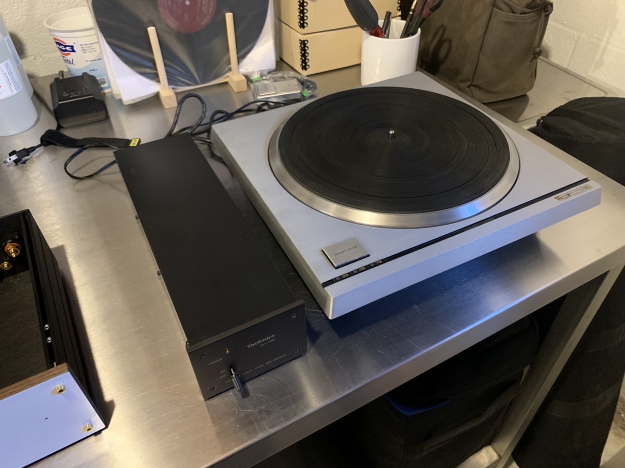

Next up is the SP-10 MKII pictured. Need to build a plinth.. Considering making it dual arm.
Good stuff. Vgeorge has an SP10-MKII too and says to me it plays beautifully through the FSP. He uses a concrete plinth. On the lighter mass belt driven school front I was recently listening to a Bauer DPS3 with its own carbon unipivot and a Dynavector Te Kaitora Rua 0.26mV MC cart. Uses 3 Phase synchronous motor and a three wave generator PSU individually tuned to each motor sample. Another very good musicality result through the FSP.

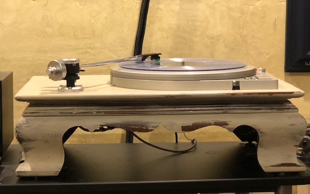

Great info. I’ll look into all of it. 6L6 is sporting the SP-10MkIIA (hence my search for something from that era at his behest) and indeed it sounds exceptional (Too good? Haha!) and now I kinda have a reference of sorts when I plug it into my current setup..
Love to see some pics of the concrete plinth. I have had the exact same notion. Thank you very much for your design... and attentiveness to this thread! I am considering at least trying out a clear top (vented) for the amp.. see how it behaves hum-wise without a metal top.
He had a picture in the SP-10 thread. BTW some people over the years tell me that the Moerch arm marries exceptionally well with SP-10. Moerch.dk
Those arms look incredible!
Uh, that’s amazing. You guys have some skills! Love it in every way. What tonearm is that? Does it sound different on different surfaces? My Rega-inspo-clone-y one does.... or at least my brain tells me that. (Probably just me).
I just got this together not long ago, so not a lot of critical listening, or even adjustment, and need to make sure it's all balanced out.
It's a Jelco 850-L tonearm. I wanted something to remove the headshell off easily, as I am clumsy and poor sighted and so I don't want to adjust carts too often.
