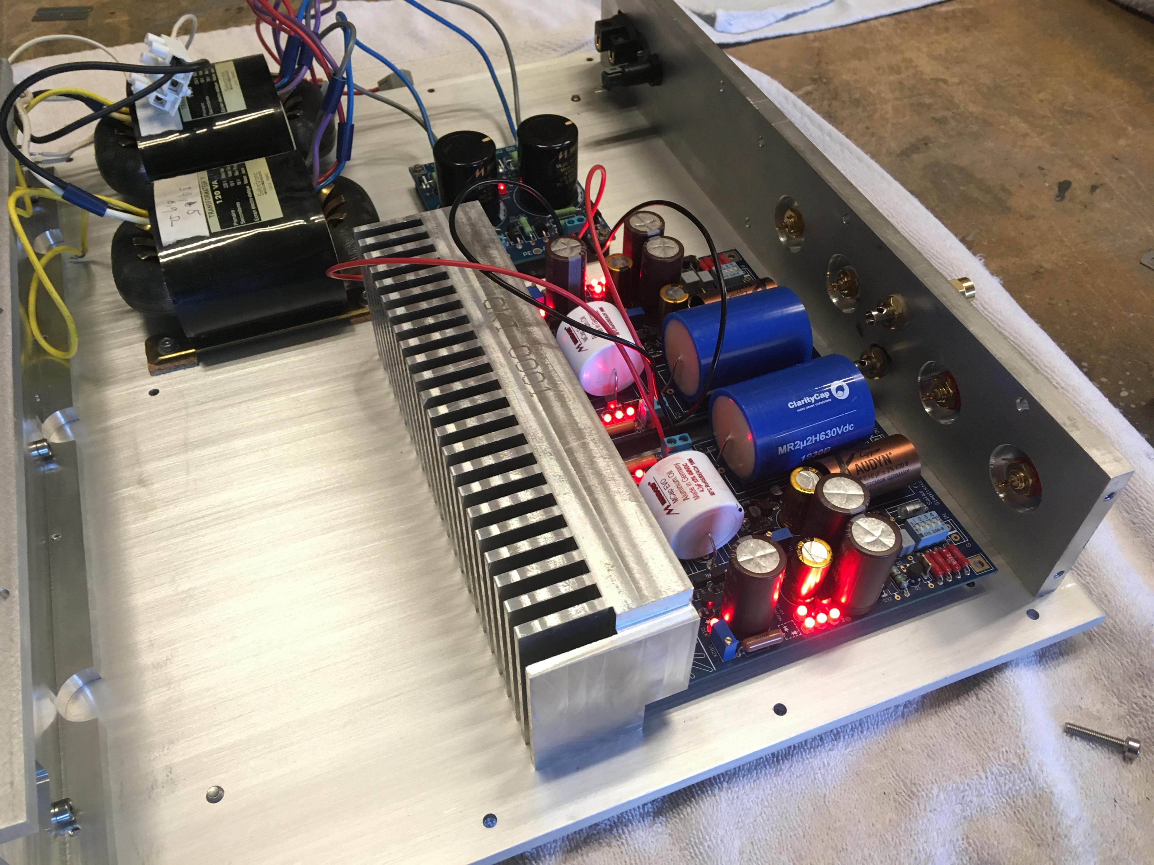

IT WORKS
no magic smoke, no drama, nothing weird, i am a bit confused about that.
adjusted to 3.6V no issues, but the rail voltage is a bit low maybe.
rail 1 is at 31.8V and rail 2 is at 31.6V, is this a problem?
The heatsink is not getting warm at all, ca 3 degrees over ambiant after 2 hours.
regards,

At MM configuration it usually wants circa 32V rail. At high sensitivity configs it usually wants couple of Volt more.
About sinks temp being logical or not, let us know what is input raw DC, what is the leg to leg VDC on R1x, what is Vgs on Q1x Q6x.

rail voltage is ca 46.5V
i might have overdone it with the heatsink i made, thats being diy i guess.
The gain is 56 dB MC, should rails be higher then?

The picture says it all about why your sink is not getting hot. It is much-much more potent than the usual board level local small ones used. No worries about that then. Its good that it will not contribute additional closed box ambient temp delta.
Raw DCin voltage at 46.5V is a very good figure for this circuit again.
About regulated rails must be higher for 56dB there is no hard rule. It depends on Q1's JFET IDSS and R2 source resistor, also VR1 setting. Differs from build to build. If you set VR1 to full resistance it drops more to C6 front end rail voltage and the regulated main rail wants to go little higher to meet wanted T.P. for instance.
What is the DC reading between Q1 drain and GND right now?

Drain to gnd would be towards 8V. Those mV are source pin to gnd. In other words across R1. Meaning 8.29mA, 8.17mA Id channel 1,2. Enough and close together. Thus little lower B+ rail voltage needed to reach T.P. 3.6V is explained. If it was more Id due to higher Idss Q1 or smaller R1, more rail would be needed. The circuit is designed with such Idss and resistor values to typically balance well for wanted T.P. reading at no more than 9mA Q1 Id.
Your build works normally around its own tolerance of bias points due to its active parts tolerances. Watch your AC power wires dressing to be twisted and tacked away as far as possible to the opposite side of signal wiring and PCB so to avoid hum. All of them. Your R-Core transformers are good for low magnetic field emission but biggies. I hope they won't bother surroundings. The chassis work looks very good. Let us know your practical results about operation and sound quality.
