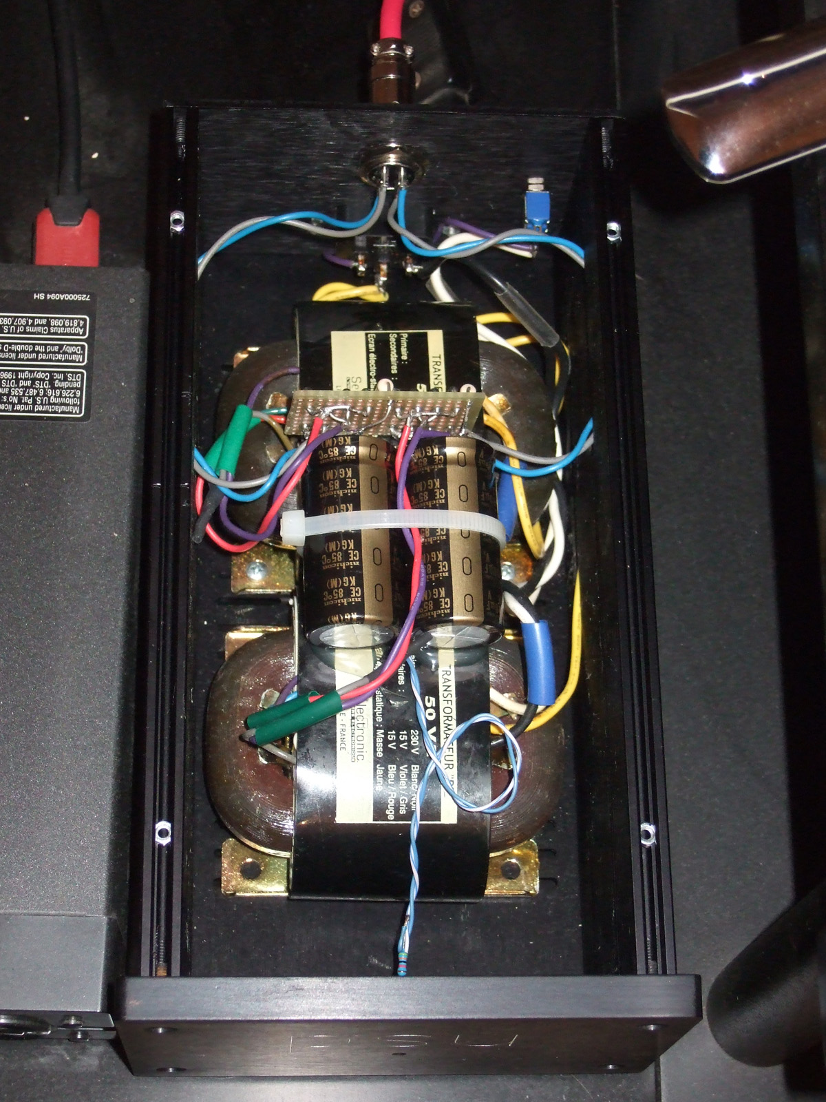

Like those from Selectronic France I used back then (no longer available)
Two PSU became double problems, there is enough one very good source with proposed filters. You have to hearing results, not only imagine in your head, double are double better, but double problems. I am describing full wave rectifying with two graetz bridges and proper capacitors, maybe few steps filtering after. Whenever are formulated good proposal, anyone wants to tweak them.
Double RAW PSU & double onboard shunt regulators as implemented sounded clearer and wider than single common in my original development of the FSP phono. No extra buzz or hum either. If a next phono board issue comes I will probably have the UltraBiB class shunt regulators outboard so each builder can subjectively choose between common DC source or double DC source feed for the channels beyond my own notes and recommendations.

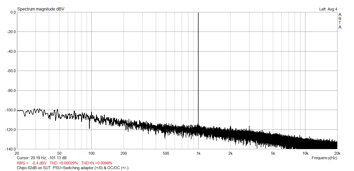

Switching PSU with passive post filtering measured clean noise floor from 20Hz-20kHz in my Chipomatic differential input DC coupled IC phono (CF architecture INA based) but in the end I was disappointed by the out of band switching HF noise making its comeback through wide band integration for elevated audible hiss and much degraded audio quality versus my shunt linear regulator. Although the op-amps in that phono had great PSRR & CMRR spec the sound quality outcome between switching and linear experiments was night and day. Thus in this zero PSRR FSP phono I would expect a total disaster.
P.S.
For your reference that was the measurement with outboard switching charger PSU Philips and local DC/DC switching CUI brand converter plus RC filters for common between channels symmetric supply on that instrumentation IC phono prototype of mine. Test frame chassis was mains grounded.
Chart shows it at 62dB gain including 20dB from balanced impedance input transformer. Zero hum or buzz and negligible THD at 1V RMS output are obvious. Looked prefect, but sounded bad until I switched 🙂)) to linear shunt PSU and became very good. Old school FSP still sounds the more natural though.
