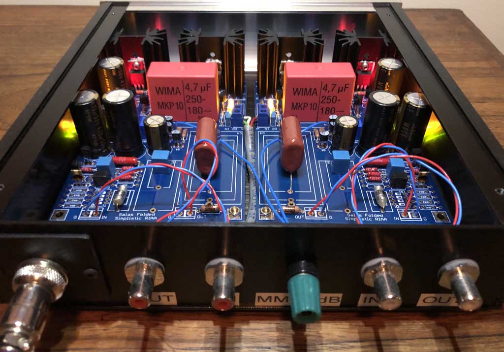

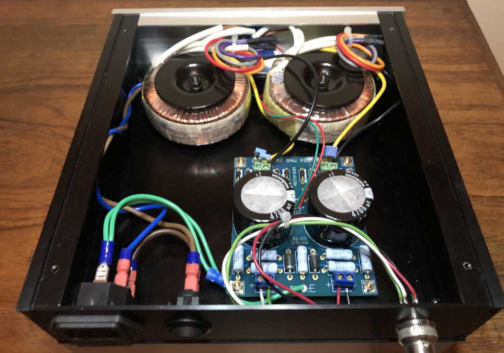

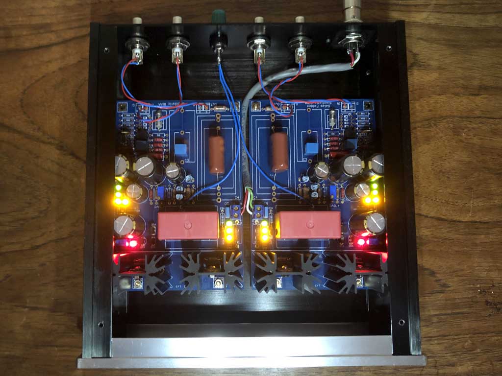

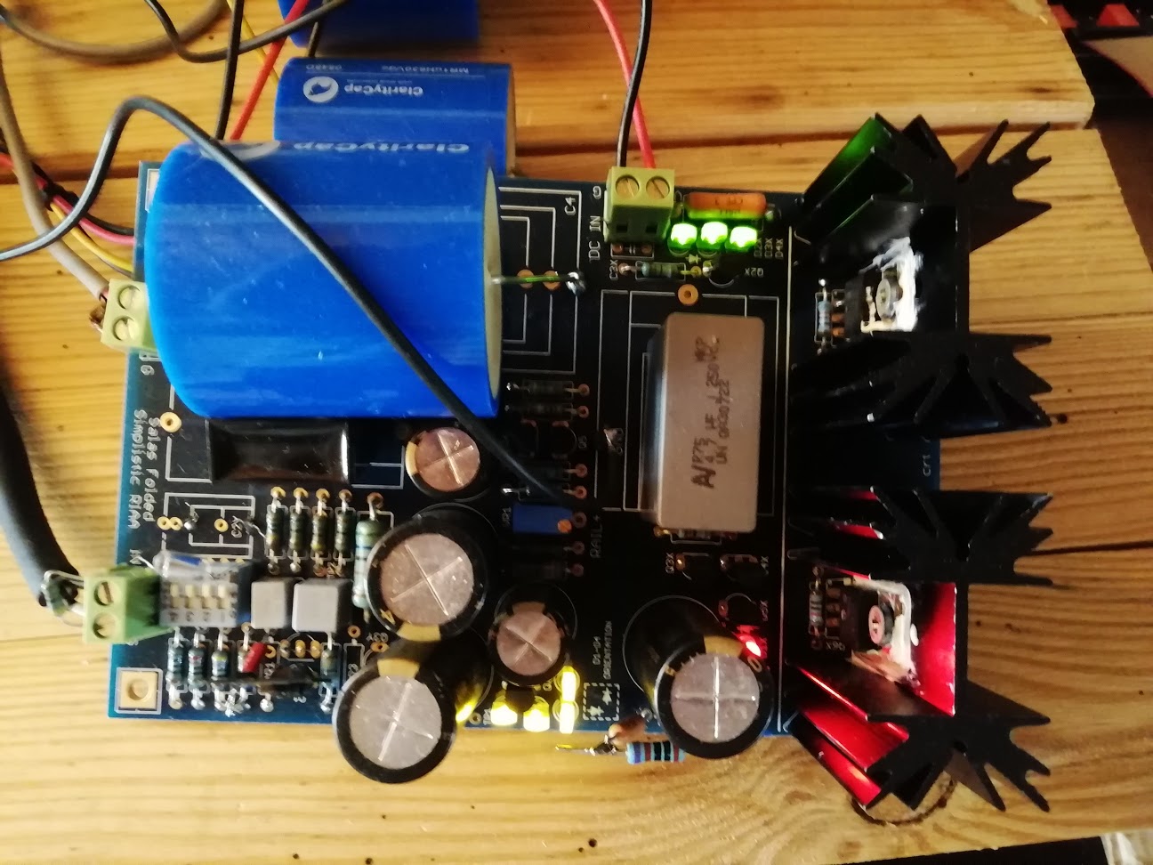

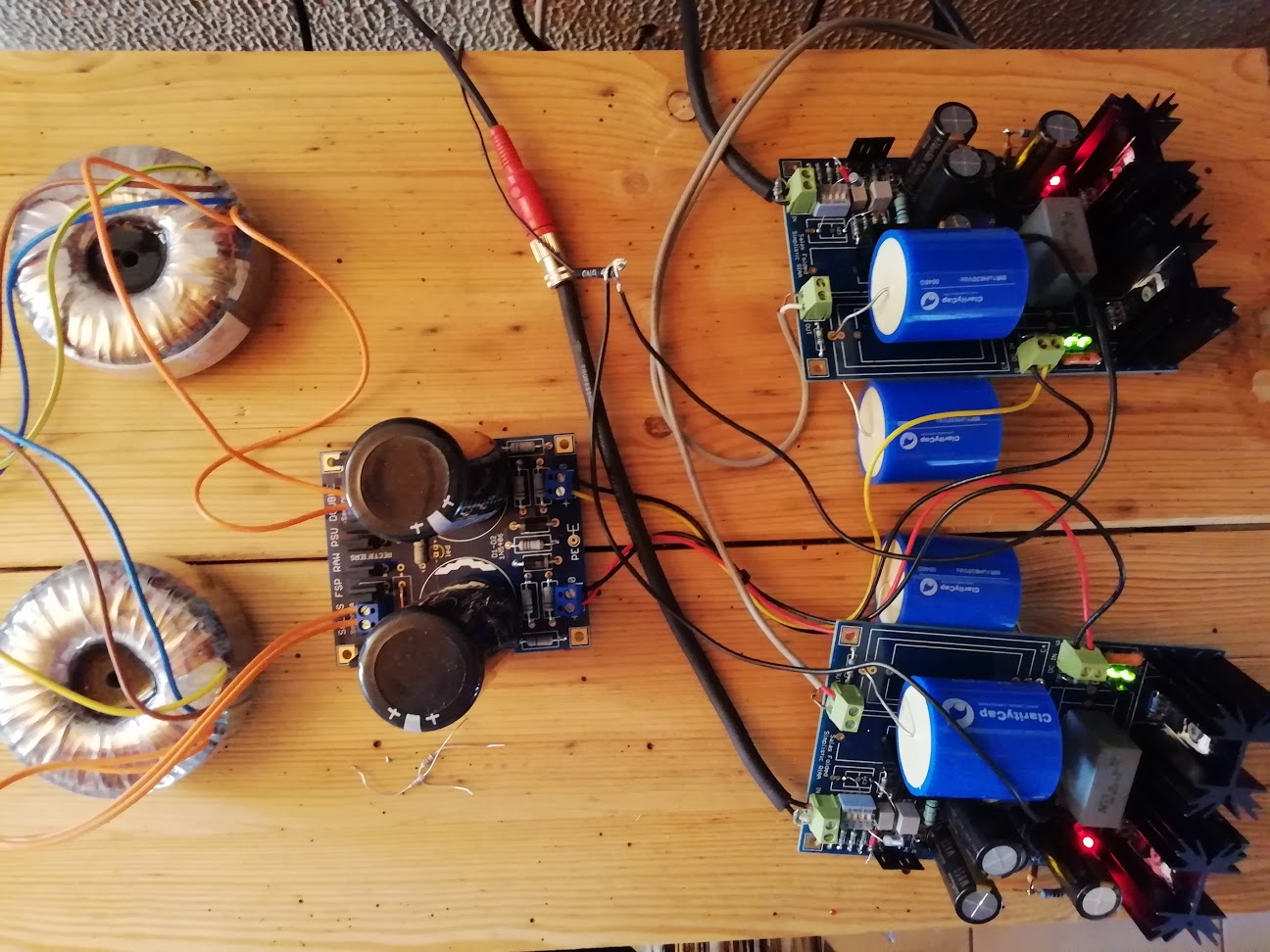

I have finally found some time and completed the FSP.
Only best impressions so far.
I'm currently tuning for cartridge loading and C2Y value, before I put them into chassis.
Many thanks to Salas for sharing and supporting such great designs with us and to Tea Bag for all his effort on this project.
Congratulations. Why there is a big capacitor hanging to the side, bypass? For which cartridge and turntable are you tuning for?

I have used 2X1uF output caps for each channel I had in stock, in parallel.
The cartridge is an at440mlb and the turntable is sl1210mk2.
I have settled to 47K loading with no extra C loading and C2Y:100pF

Yes there is enough capacitance in the TT wires and in the JFET input. Audio Technica MMs usually don't like any extra. You kept the transfer curve slightly rising also which is appropriate for most MM carts. Thus your tuning settings come across very logical.
You could maybe get by well enough with single 1uF output capacitor if your line pre-amp has high impedance input. Do try with only one at a point so if its still sounding good in your system, not overdamped, to can save your second expensive Clarity output coupling capacitor for another project. And for the assembly to become more manageable without any side hanging heavy parts.
Yes, exactly. Tonearm +interconnect parasitic capacitance measured around 80pF, plus JFET input capacitance probably around 80pF, well into recommended 100-200pF load capacitance for an at440mlb.
My pre-amp has 50K input impedance. Have just removed the second 1uF output capacitors for evaluation.

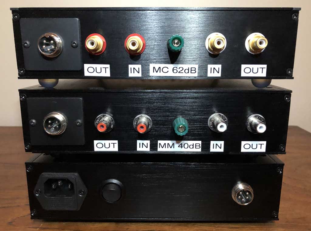

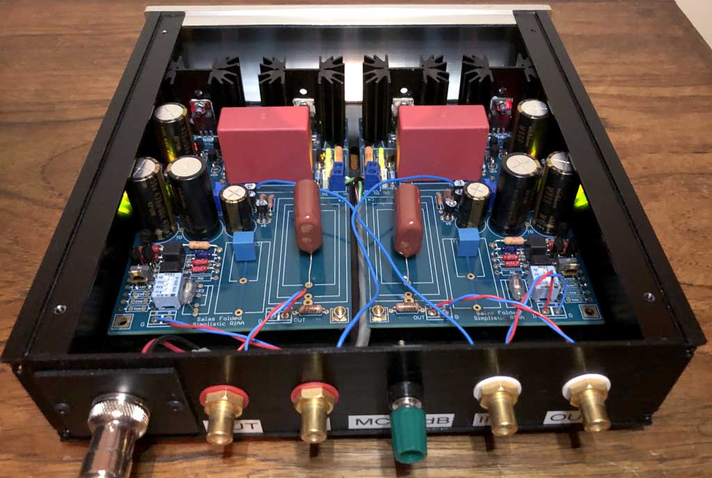

Thanks to Salas for a great project and to Tea Bag for the bits and pieces. Apologies for for not posting earlier, the phono pre has been singing for about 6 months. It's an industrial build as far as the caps go. NOS Panasonic PP caps from my parts bin, surplus polystyrene for C2Y. I did splurge for Vishay TX2575 for the loading resistors. 110ohm for the MC to load my Denon DL103, 47K for the MM for a yet to be listened to Garrott Bros. P77i.
Nice builds. How do you like it with the DL103? I had usually found my DL103R better at about 200R loading but the regular DL103 maybe differs in loading preference.
I had been using the original Pearl with a pre-pre and found that I preferred the DL103 loaded at 100ohms so just went with that. Your pre was a bit bright at first but I thought I should let it run in a bit. After about 10 hours it smoothed out and I'm really enjoying it. That's why I haven't mounted the Garrott yet. The DL103 is on a Linn LP12 with the Ittok LVII. I have a Rega P3 that I'll probably setup with the Garrott.
